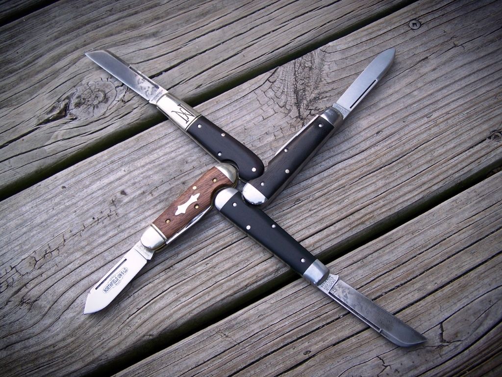

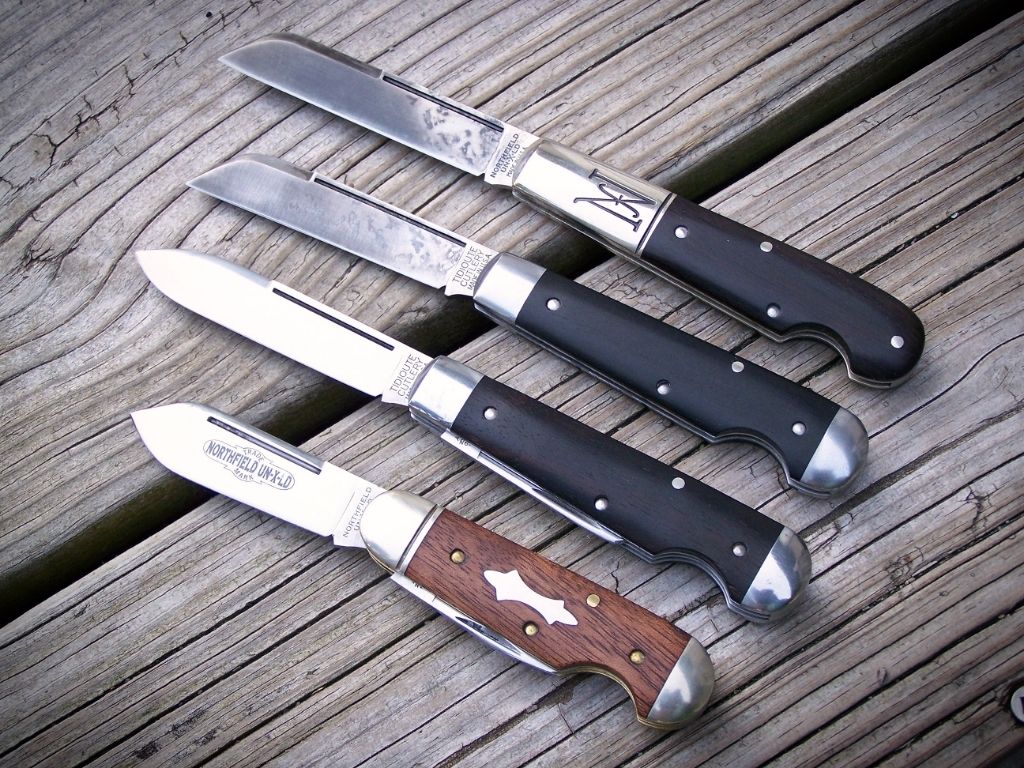

Finally put the Easy Open notch on my 2014 Forum Stag Jack:
That looks fantastic, ALLHSS! :thumbup::thumbup:
I saw your knife in another thread (maybe "what trad. are you totin' today?"; been busy at work so there's kind of a backlog of posts I'm trying to catch up on and I'm not reading things in chronological order, so it's all kinda weird :o) and wondered if I'd ever seen that mod before. I'm glad I found this post instead of posting a question in that other thread.
But anyway, I think it looks very cool! :cool::cool:
I think I'm one of those people who likes EO notches in sleeveboardish knives regardless of what blade shapes a knife has.
jlhoffman, your EO mods also look pure professional! :thumbup::thumbup: (I love that top picture.)
- GT
