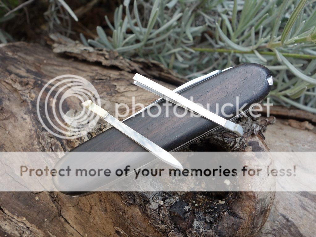

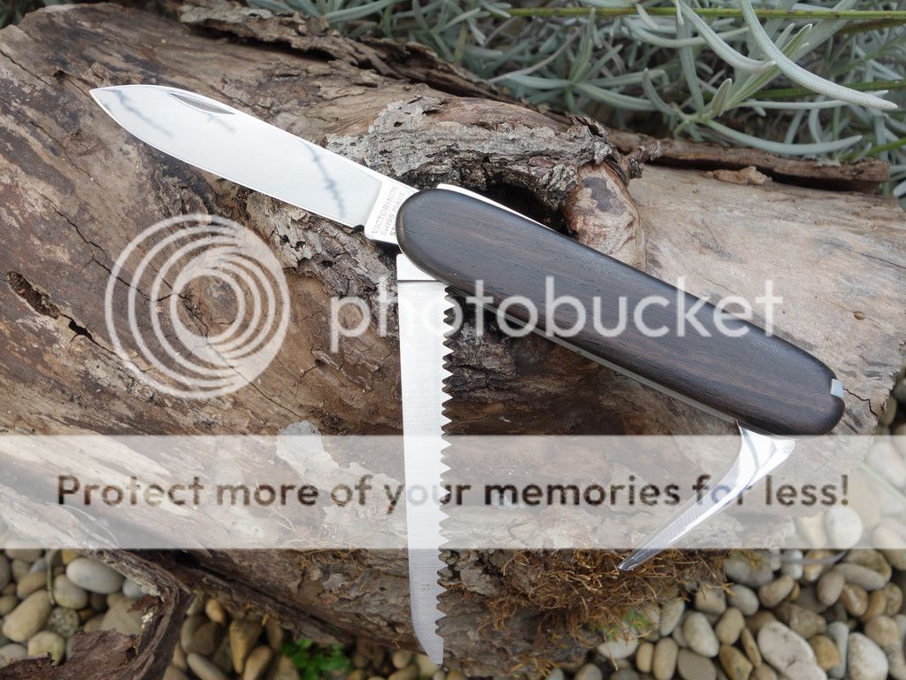

Just finished this one with ebony covers:
It's the first time I worked with ebony.
At first I was afraid that it is going to be much more difficult to work with because it is so hard.
But that stuff is pretty awesome, it's more like a hard plastic than wood.
Especially carving out the slots for the tweezers is easier because you don't have to worry about the grain of the wood so much.
It started as an alox SAK.
At first I wanted to use the aluminium scales of a normal SAK, but it turns out those have a different shape.
So I had to grind down the thick alox slabs instead.
Pointy tweezers are more practical than a toothpick.
