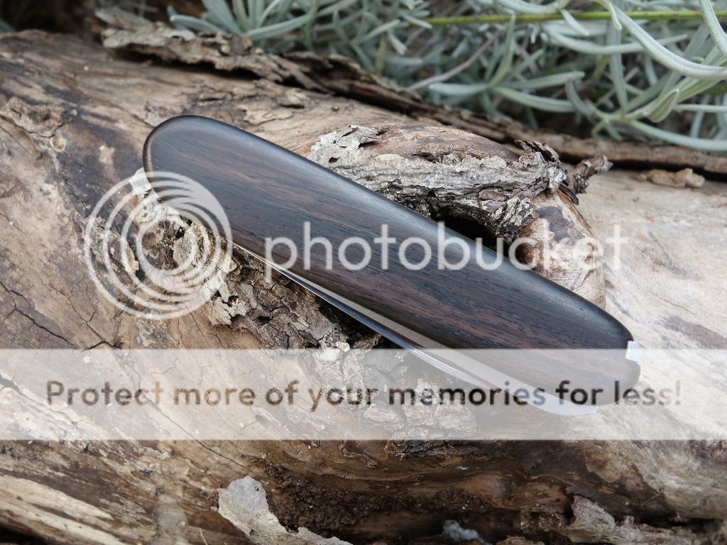

It only took a couple of days before I could no longer resist the temptation to take some 150 grit sandpaper to the polished micarta scales on my new Mudbug. The scales have massively higher traction now, and I happen to prefer the look. Nice patina forming on the blade as well.
