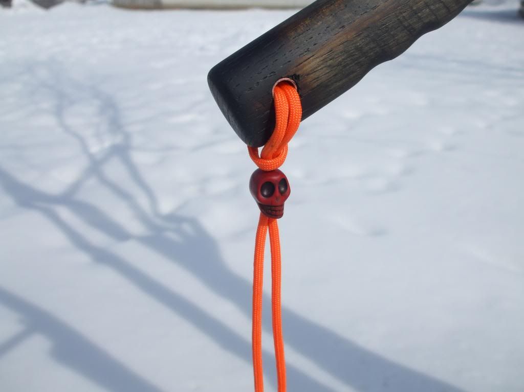

CS Rifleman's Hawk after a lot of grinding. Cold blued head, stained and varnished handle. I also inserted a brass tube in the lanyard hole and flared the ends to keep it there but it's hard to see in the photos.

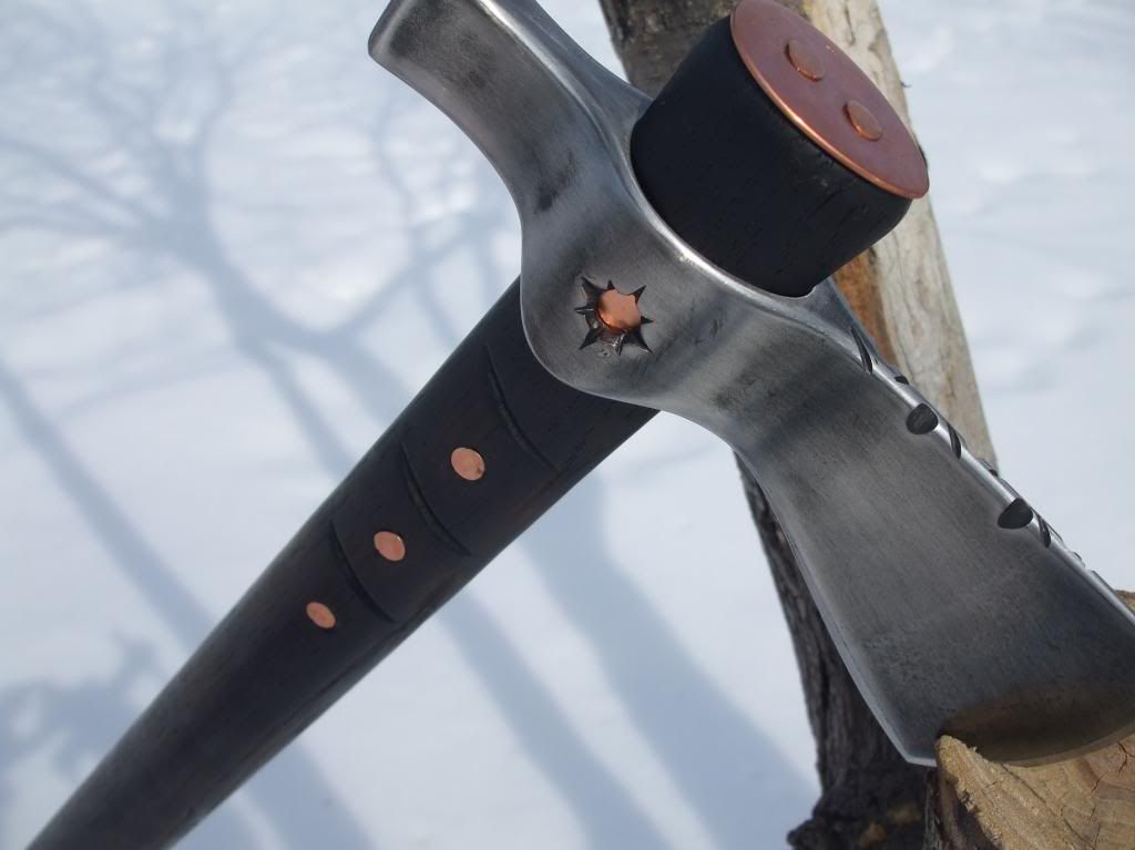

If anyone on here thinks I stole their idea you're probably Right:eek: Thank you for all the inspiration!

Wow! That's a beautiful hawk, are those copper nails in the handle? I just got my trail hawk today and started working on it straight away, I will probably steal a few things from your example. Thanks for sharing!!
Copper coated nails. I couldn't find solid copper.
