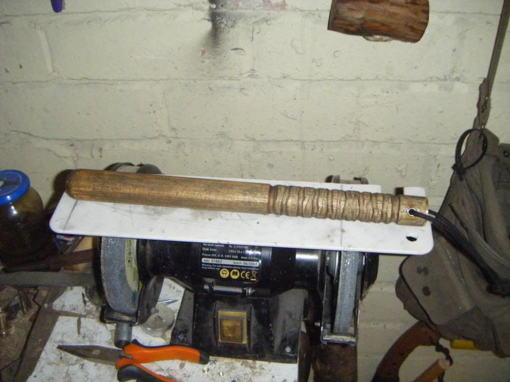

If you want a decent gripon the handle you can file ribs into it. I did this to my hunting priest on a cheap bench grinder in like 2 minutes, but the same could easily be done with a stick file.
This way you can make use of the take down ability of the hawk and still have a decent textured grip.
Hope this helps :)
Also one other question. It looks like I found a place locally who is going to powder coat my tomahawk head! So the main thing I wanted to do was convex the edge and take the pits out. Anyone else have any other suggestions of anything to do to the head before I send it in for powder coat?
Samon - I like that idea. How comfortable is yours after awhile of use?
Well, as it's a priest it doesn't get lots of use - just enough to bash a rabbit in the face..
But! I have played with it and the end is weighted, and it's alright. I'd say go for thinner grooves/ribs, thinner and more and it should be pretty decent!

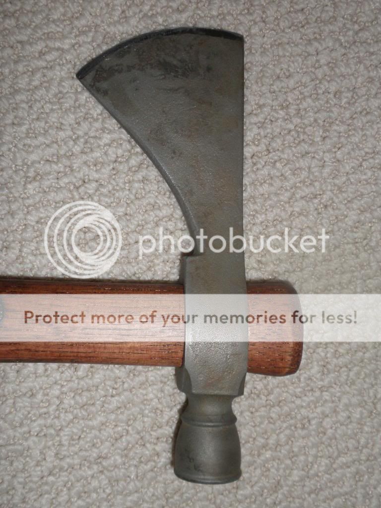

So tried out my first CS tomahawk mod. I was given a factory CS Pipe Hawk so started with that one. Nothing fancy but very useful.
One thing I noticed is that yes the factory handle was very long and I have seen several people cut theirs down. I found that my hand rested about 1/3 up the handle for most chopping however the extra length seemed to be a good counterweight and if I wanted to I could do a decent 2 hand grip on the extra if needed so I kept the factory length and didn't cut it. Just sanded and stained with I think red oak sealer/stain combo.
Did a little burning (same pattern on both sides) with an old soldering iron.
Sand blasted the head (took about 5 minutes to remove all of the paint) and then did the mustard/ac vinegar method Samon suggested. The steel was almost silver after sand blasting it and the patina is really nice. Almost a dark blue/grey with some staining around the edge that I like the look of. Makes it look well used.
One thing that seemed to be a constant in the posts here is that people don't like the factory bevels on the edge. I barely touched mine to a belt sander when I first started the project (before sand blasting) so I didn't take that much off but otherwise I really like the edge on this one. This is the best pic I could get of the edge geometry so please excuse the blurry pic. Literally 5 minutes with an eze-lap folding stone (medium and fine) and I can shave patches of hair from my arm with the edge.
Left to do: not much. I think I would like to get a belt loop for it however as I am not planning on carrying it around with me its not a big deal. I would like to do some sort of end cap such as the very nice norse hawk that was posted however I do not want to interrupt the ability to remove the blade quickly if I need to. Besides that not much else I can think of. I was thinking of patterning the handle as its just smooth wood but after awhile chopping some dead wood with it I was not having any slipping issues that I could see so just going to leave that part alone.
Suggestions? Especially after seeing the beautiful norse hawk just posted I think that might be my next one. But want to try each of them in my hand at the blade show coming up in Atlanta first. Just have to wait an extra month for that.
