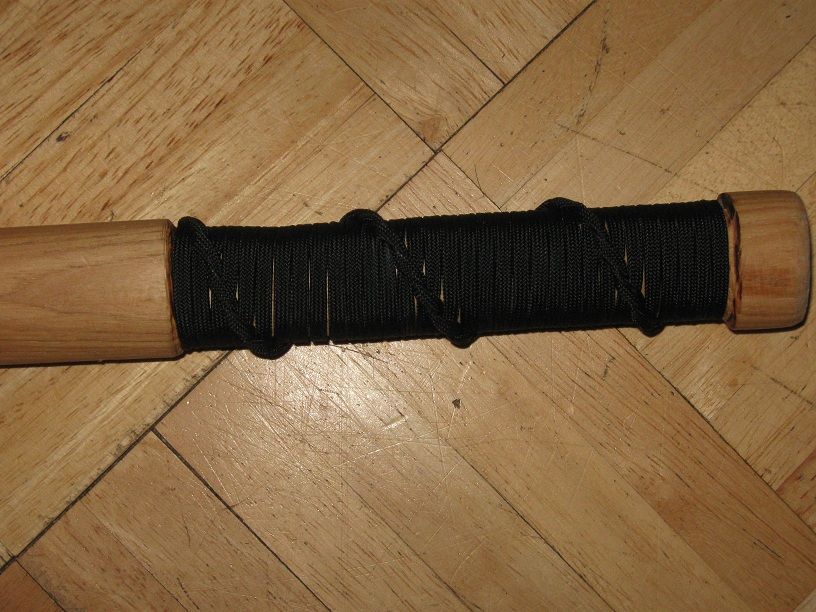

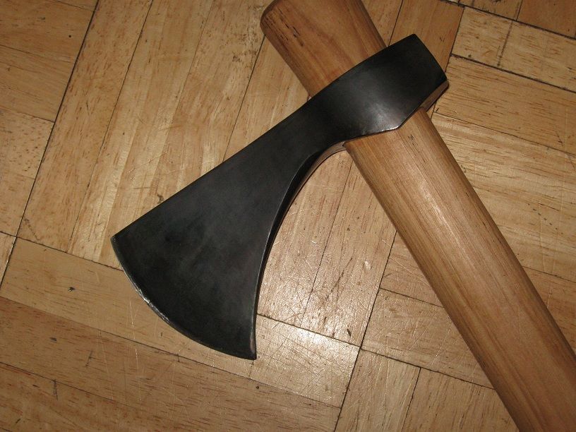

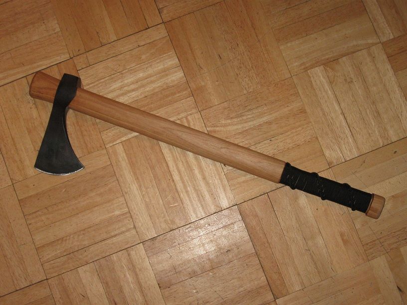

Hello Bladeforums. Been viewing this thread and figured I would share as well. Here is my modified spike hawk. Mods include removing the spike to make a hammer pole, stripping and bluing the head, BLO on the handle, and a paracord grip. The handle was ground down a little so that the paracord would rest "inside" so I could take the head off and on. As of right now, this is probably the most used tool I have. I use it for everything (wood processing, game processing, etc).
The whole hawk:
Handle closeup. The wrap is gutted paracord with a ladder stitch:
Closeup of head:
The whole hawk:
Closeup of head:
Nice! best thing that could have been done with that spike!
