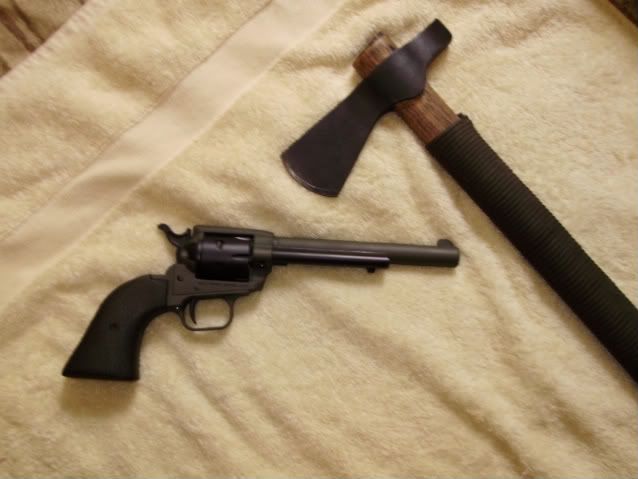

So I went in with a few local buddies of mine and got free shipping on about 5 of these. I got one for myself and remembered this thread from a few years back. I took the sander to the paint and left just the low spots painted, deburred the eye, sanded the handle and got a good fit (was actually pretty decent from the factory). Then I hit the handle with the map torch and put 4 coats of oil on it letting it sit 8-10 hours between coats. Wrapped it with desert tan paracord and made a kydex edge guard and a molle type hoop for it.
All in all I'm pretty happy with how it turned out. Thanks for all the idea's posted here.

this is pretty much finished product, the small wrapping under the head has a sub wrapping of steel tripwire GI issue for re-inforcement, will add cable cynch and end stop with glow plug so lanyard can be adjusted.
I absolutely love this one. Subdued, simple, and ready to do some hard work.
Awesome work on the paracord wrapping.
