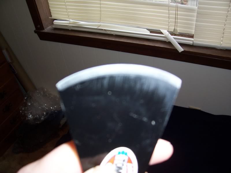

I got a cs trail hawk for fun and it does not want to take a useful edge at all no matter what I try. Is there some trick to sharpening a hawk?
I hope it's not a heat treatment problem. I also got an 18in barong machete (same steel, same company) in the same purchase that I easily got razor sharp.

I usually just free-hand my hawks using a file. This includes when I sharpen my Trail Hawk, which BTW takes a good edge.
they are made in different places, i think. - i love that machete BTW.
for my personal hawks, i like to make a really sharp secondary bevel angle, almost down to a zero primary edge, then i make the narrow primary edge a little on the wide side, in angle.
it has really been a good edge for combination wood types for me, and is easy to touch-up.

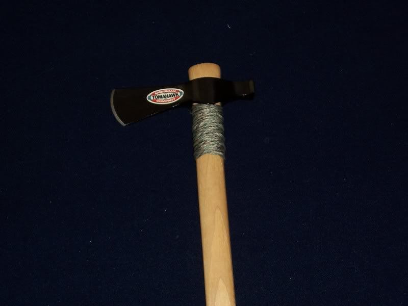

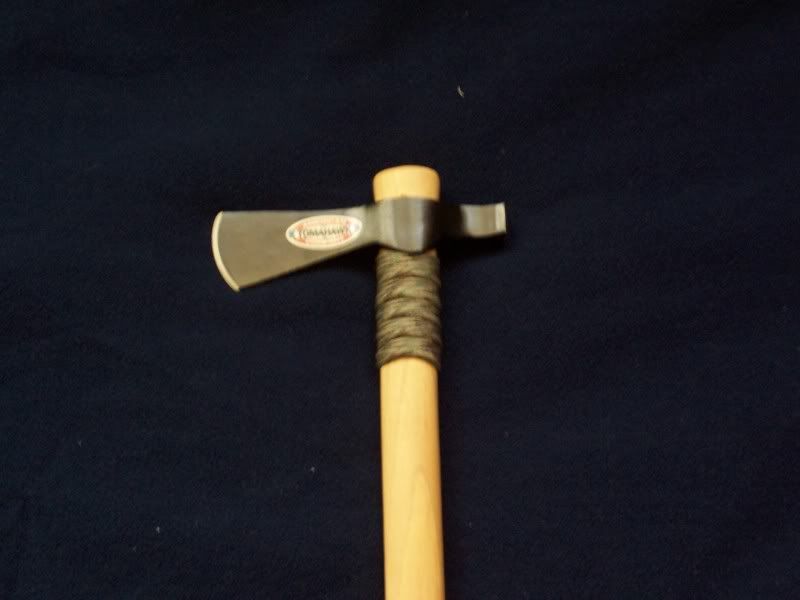

Okay, so here's my trail hawk with a couple of mods.
Here it is with a quick wrap I did. I threw in some alternating clove hitches for gripping.

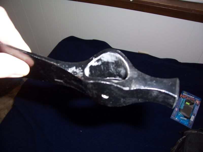

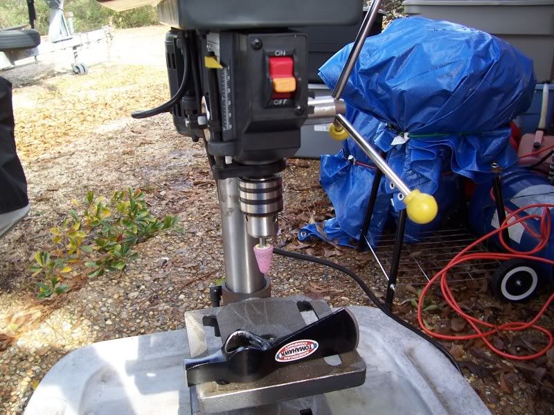

Then I decided to deburr the eye.

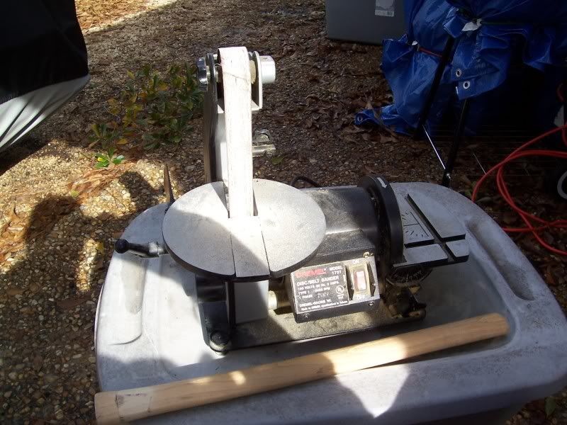

Then I had to sand the new handle and a spare I had on hand.
I also put a pretty good edge on the new guy, because it had an edge like a screwdriver (odd considering every other CS hawk I've touched). It needs more work (so does my photography) but I just reshaped it with a rough belt and finished it real quick with a 20 micron belt. VERY toothy edge, but it slices paper.

Sanding out the inside of the eye resulted in a far better fit. :thumbup: The hawk is in good enough of shape now that it's actually a useful tool as opposed to a dangerous toy.
