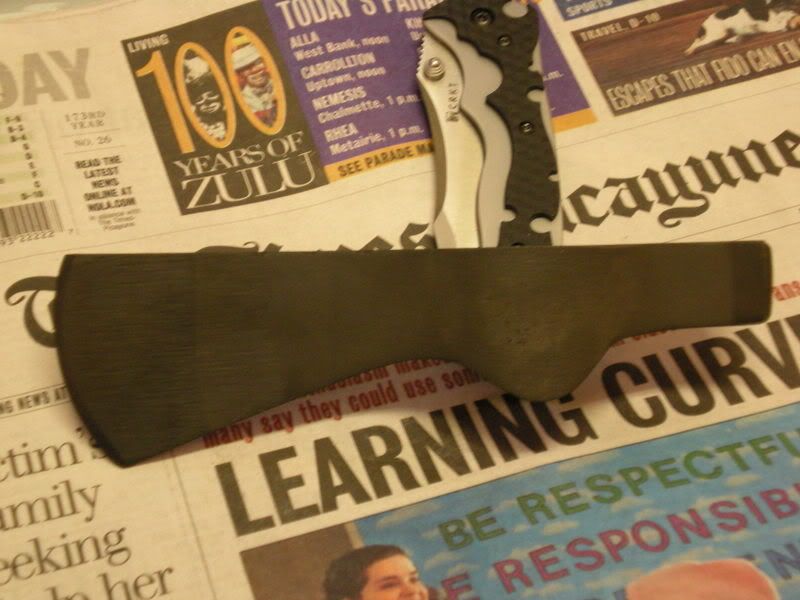

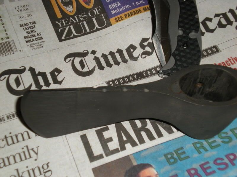

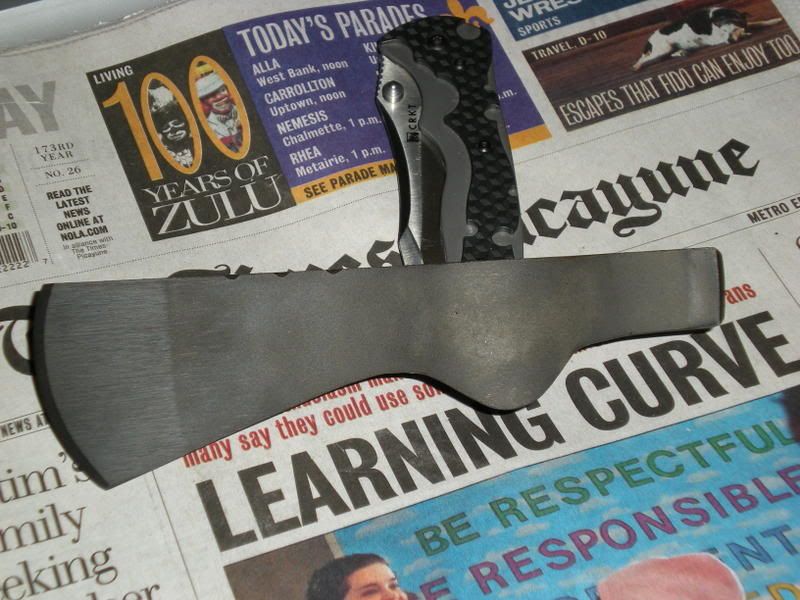

All right guys, you all talked me into buying a trailhawk ( it wasnt that hard). So I finally finished modding it, for now anyways.
I sanded most of the black coating off and let it sit in mustard to give it a nice patina. When I cleaned it off it gave it kind of a goldish color which I thought was weird but I like it. I also gave the haft a blackened treatment of mud and then rubbed black spray piant into it kind of like you would rub stain into wood. Finally I reprofiled the blade and sharpened her up. She cuts like a beast now!!! Anyhow here are a few pics!!

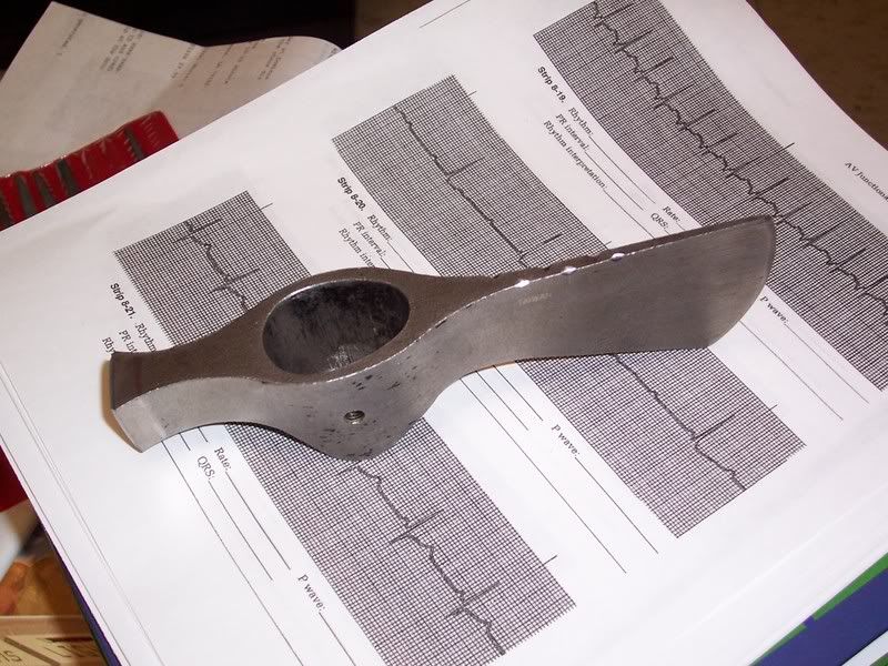

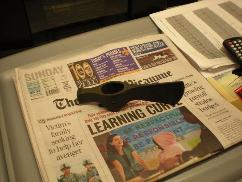

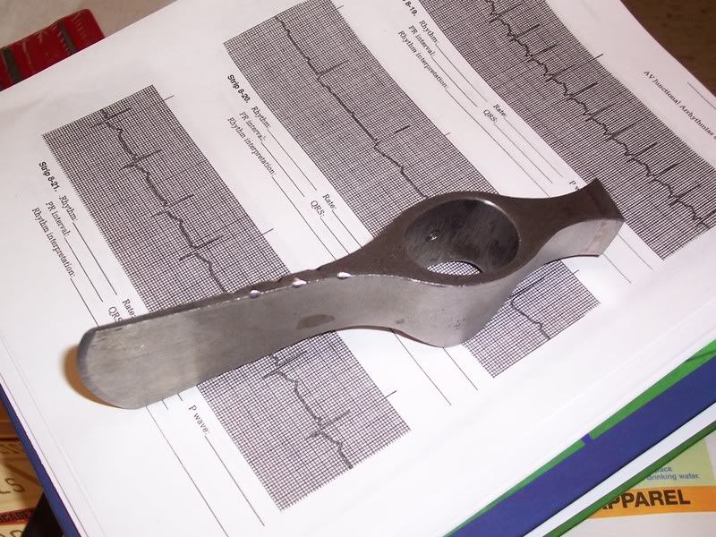

A little update. I thought I'd go ahead and try a little file work on my TH. I tried a vinegar patina as well. I guess I just picked the TH to do all my experimentation on.
A couple before:
And after:
If anyone is interested, just making a pattern of alternating crescents is easy as hell. Just set your intervals, start your grooves with a triangle file, then use a round file or a half round file to finish them out. I bought a set of precision files for less than $4.
In retrospect, I think I set my intervals too far apart for this hawk. I think I used 1/4 inch intervals, but 1/8 inch would have been better. I might go back over it and add triangle grooves in between the crescents. How do you think that would look? Too busy?
