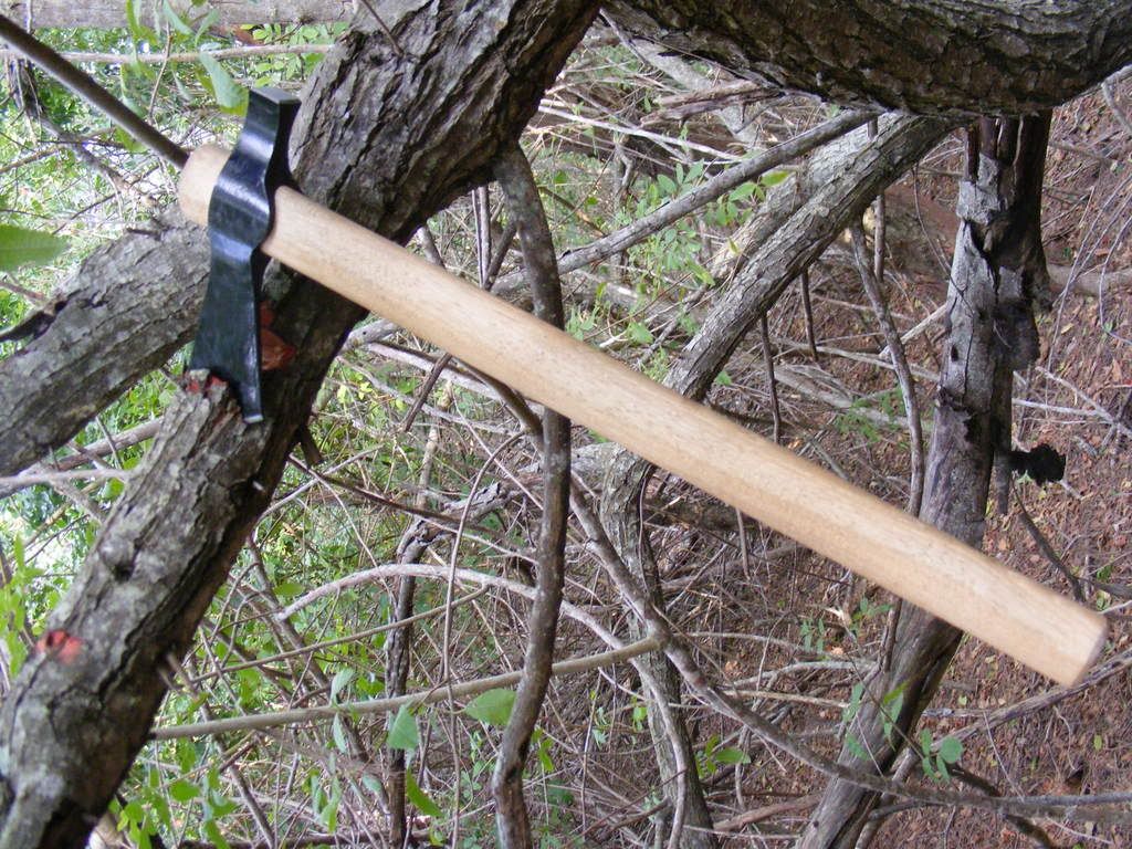

presenting some feral dog/two legged scum banishment tools:
DOGS BANE, a fire blasted, hand scraped and hand rubbed linseed oiled hiking staff, and GITSNICK, a CS Norse hawk with fire blasted hickory haft, also hand rubbed with linseed oil:
pardon the poor picture quality, i used 1000w halogen lamps indoors for lighting.....will retake in natural sunlight and with Hi def camera in a few days:
thx again to whoever posted the m4 mag pouch for a quick sheath... works like a champ, and if i wreck it i wont cry over it.....
no real mod's except cleaning up the eye and getting a proper fit on the shaft.... but it started with this "salping" and thinned 3/4th of it down on my new bow....
and it is pretty popular with the other gear...
