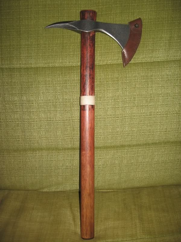

Here's my second hawk. CS norse. Used it to practice most of the fancy stuff I've seen here and on pro work. Most fun part was the pewter work.
I followed Alan Longmire's instructions:
http://forums.dfoggknives.com/index.php?showtopic=9559
Learned a lot. The pewter castings were pretty rough but luckily one side was nicer than another. Main issue was that on the haft butt I underestimated volume of pewter needed and so had to add after the initial castings hardened. Created all sorts of rifts and holes. It was really too fancy of a design for a first timer. The ring on upper haft was easy and came out decent.
Getting better at etching. I got better "U" etch than on first hawk, because I etched the design twice. Second time tried fingernail polish as the resist and that worked well but was a pain to get off. Had to resort to paint stripper when polish remover didnt touch it, and some polish can still be found in small pits.
Knotwork on haft was drawn, etched with my stylus dremmel, then burned witih soldering iron. Its on both sides.
Did a vinegar patina on head but next time will try for darker cast, and will grind steel more to remove most pits. Cheers, and thanks to all here for tips and examples and enthusiasm.

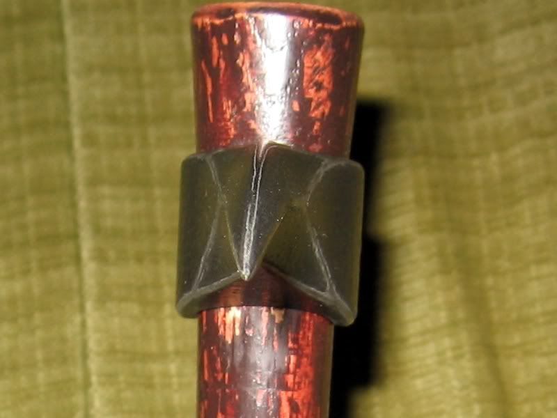

So I just finished reading this whole thread (great stuff within) and thought I might as well sign up since I've been checking here the last few days. Anyway I recently got ahold of Cold Steel Spike Hawk and took my hand at customizing it to my liking.
I rounded out the edges and took away the peaks on the collar of the head, sharpened the spike and gave it a nice hammered finish with black and outlined it along all the edges. It's not finished as unfortunately I've run short on funds for my project (I'm fixing up a recently acquired Ka-Bar khukuri and my Trail Hawk as well). I plan to add additional wraps and put sinew around the top and bottom of the head. Depending on how it holds up I may take it with me to Iraq if I get shipped there.
