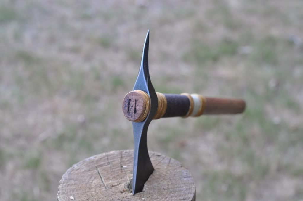

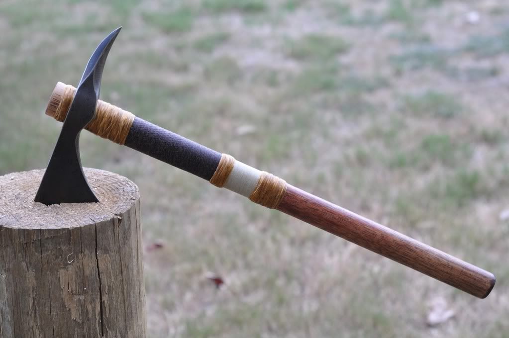

so far I stripped & sanded spike head from 60 to 150 grit I have some more to go,and
sanded & first coat of stain on haft golden pecan.for the head I'm thinking of boiling in vinegar or gun barrel brown,not sure yet.this is where I'm at with it & time so far 2.5 hr.

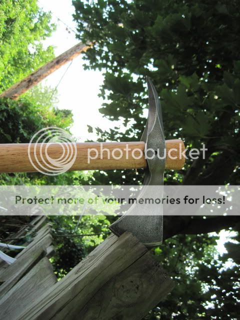

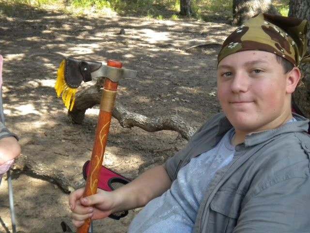

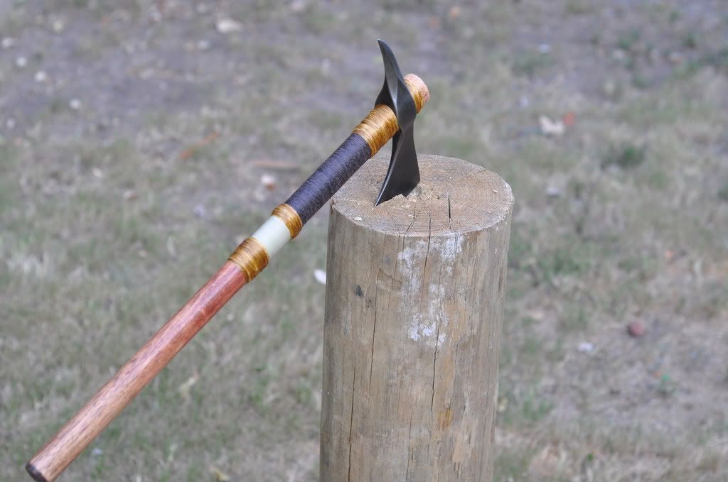

Some nice hawks on this thread! This one is my oldest son's. It has a vine pattern filework on top, and a bit of vine on the handle, as well as a mask I made for him.

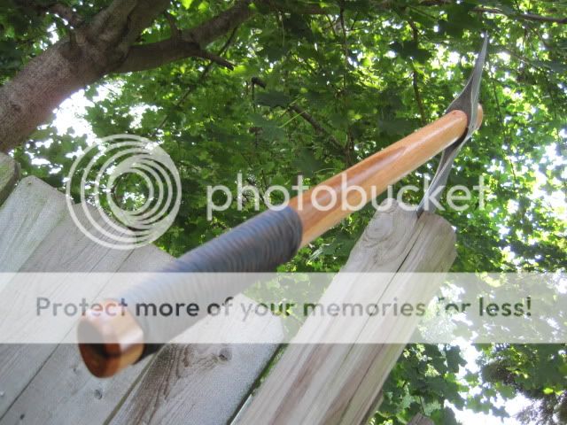

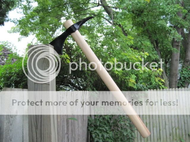

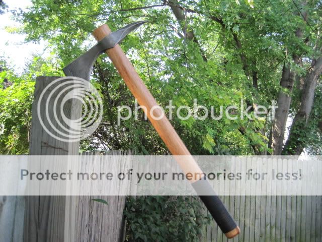

I must be easily inspired. I saw this thread, geeked out and slightly improved a trail hawk, first pic below.

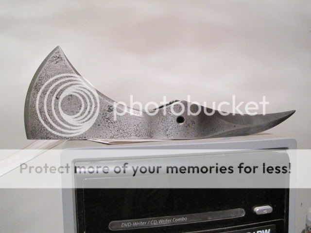

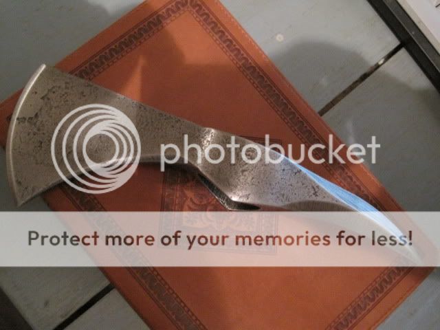

Then I saw the post by pullrich on etching and started working on a spike hawk. The work in progress pictures are below the trail hawk. I was surprised at how well the etching turned out. I assume that the difference in texture on the big longhorn is due to the heat treat of the steel. I then blued it twice and rubbed it with some steel wool.
Now I need to put a nice convex edge on both hawks.

Those are some deep clean etches, dougelder, well done!
Would love to hear what specific techniques you used.
Also, the inside of the etch looks inked or otherwise nicely contrasted with the un-etched part.. how did you do that?
Pullrich--
You are to blame for my creation!
My technique was rather lazy. I slapped on some very common stickers down here in Texas to the hawk and had my son hit it with spray paint out in the back yard. After it dried, I pulled off the 4 stickers and placed the the head in a vat of Radio Shack etchant for 2 hours while out to dinner. I rinsed it and then soaked for a couple more hours while I enjoyed 2 cigars and a few cocktails. One more rinse with water and a spray down with some Rem Oil, then I went to bed.
The morning after, I sanded off all of the paint with sand paper and steel wool. The next step was to rub in some cold blue that I bought at Cabela's two times with a steel wool polish in-between and after. That was it. The etched portion was smoother than the rest of the steel, so I guess it absorbed more of the bluing.
