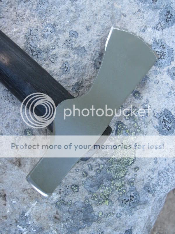

dougelder -you did sand the head before the etching right? Or did you use a solvent to strip the eraea clean? I've always used sandpaper, but that is kind of a pain.
Right on, glad that worked out. It's interesting that you got such good results with those two long soaks. I've always thought you needed to agitate as it etches but clearly that isnt the case. Also I really liked how the bluing brought out the etch.
Wow! looks great guys!
I really want too try some etching soon.
I stripped it with solvent and sanded to get rid of the "Hecho in Taiwann" print. Then, I prepared it to be etched. Stickers, spray paint, etc...

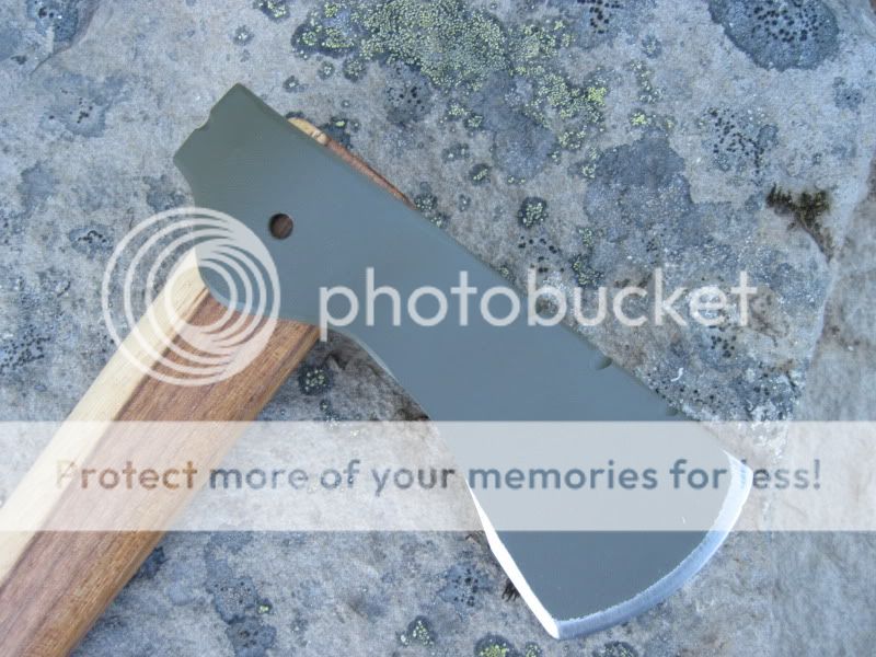

Managed to complete a couple hawk mods. I cut the hammer end off a trailhawk, did a little file work, ground out some of the belly and sharpened a partial edge on the bottom. I bought a great looking hickory replacement axe handle and worked it into shape for the trailhawk. Cutting off the hammer end lightened it up quit a bit, feels very fast. It is still a great thrower.

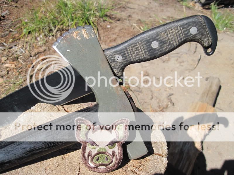

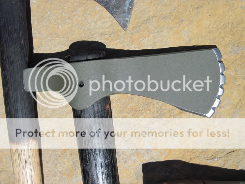

On the second hawk I burned the haft and soaked in lemon oil for a couple days, then applied a few coats of wipe on poly. I got the idea for the haft work in this thread from Q!! I then got inspired by my Busse addiction and filed in some mean serrations. I also ground off some of the belly and sharpened the partial edge on the bottom. I rounded off the hammer end.
Both hawks got a couple coats of OD green and they were ready to fly!!
Those serrations look pretty cool! :thumbup:
Just wondering if there is a reson for them other than looking mean? ...More dammage or intimidation in a SD situation maybe? :)
Thanks!!
For me they are just for looks... But I think they might inflict more damage used as a fighting tool.

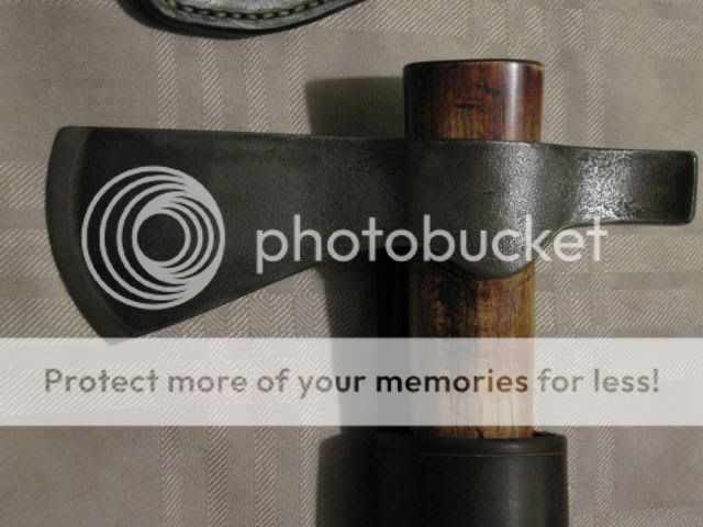

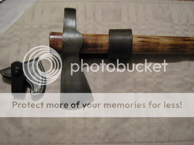

I sand blasted the head, smoothed all the rough edges. A couple treatments of Plum Brown. Buff lightly, and oil. The handle was sanded and rubbed down with Majic Maple. Added a little heat here and there and sanded back down. A couple coats of laquer. Add one jacket and a skirt from Goose-52 and here is where we are for now.
Paul
I like the look on the haft p moore, well done. That axe head sheath/jacket is pretty cool, too. Where did you get that?
Looks great p more! :thumbup:
Goose-52 here on the forums makes them. Excellent job in my opinion! Very beautiful work, and the belt loop/holster even comes with a handy snap on and off feature, so you can remove it without taking off your belt. :)
Also, he left enough room for your paracord wraped handle to still fit in the belt loop. Thanks again Goose.
Paul
