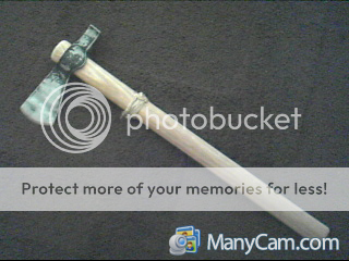

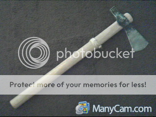

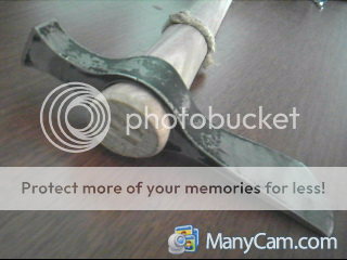

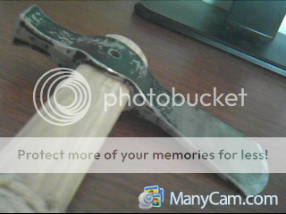

Been checking out all the awesome mods you guys have done on here and finally decided to show mine.. when I firt got my hawk i sanded down the head a bit and it almost had that "hand forged" look to it thanks to the black paint.. Unfortunately i have no pictures of that state and the pics im showing are after i let it bath in white vinegar papertowels for aprox. 48 hours, the towels started growing this nasty black stuff so i figured id take it off.. might need to try again as the vinegar made most of the paint peel off leaving un-patina'd steel open.
Anyway here it is

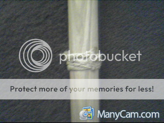

the next photo is just some jute twine that i tied a turks head knot around the handle

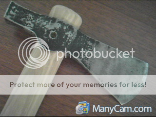

Now just the head
Bottom view
Top view

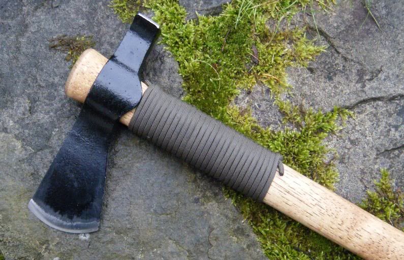

FINALLY my turn to humbly contribute to this AWESOME thread!

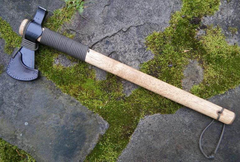

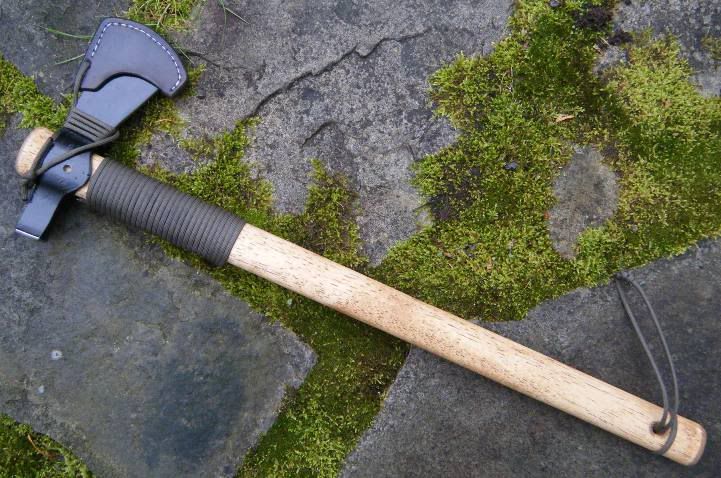

Mods made to mine are: deburred the eye, polished the hammer, sharpened the edge, sanded the haft smooth (220, 400), drilled a lanyard hole, fitted the head (no gaps, tight fit), finished the haft with light brown stain and boiled linseed oil, wet paracord wrap, and made a leather sheath.
There's some pretty amazing hawks in this thread; I hope we'll see even more!
