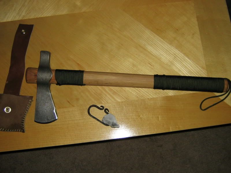

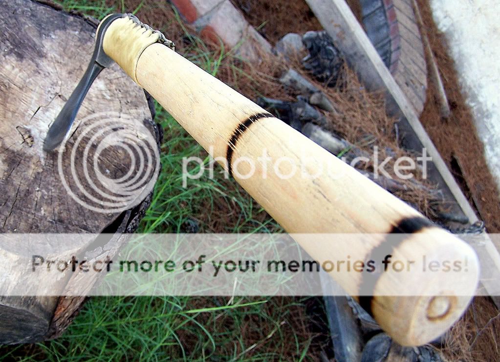

My trail hawk
Simple, functional, used.

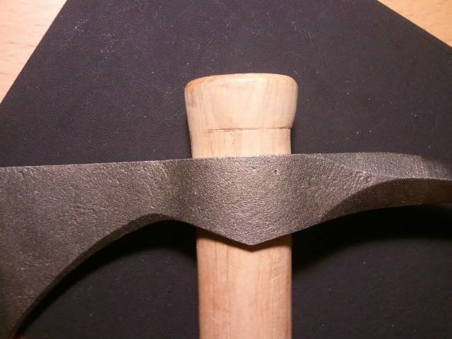

Working on my first mod. The handle came really terrible from CS. As you can see from the pictures, it's still biting on the sides and back and literally falls right off. Before I continue to sand, should I radius the top hole of the head so it conforms to the haft better or just keep working on the haft?
That is about as bad as mine looks. What did you end up doing?
With mine, fit the way it came from CS, it rattles with the screw in, and falls with the screw out. There is no way you can press fit it enough that it will bite and hold. If I flip the head over to the other side of the haft (not other end, other side), it bites nicely and sticks, although it isn't fit very well (can see light in a few places through it). Haven't done anything yet, researching here, and trying to figure out what I want to do. Oh, mine is a Pipe Hawk.
One of the things I did was fill in the loose area below the "bite" with wood glue (several layers), let it dry, then sand to get the head to fit. Plasti-dip will fill in the last tightness needs, once I can find a store with Plasti-dip :)
Thanks, BRL.
I ended up taking a dremel, rounding off the inside of the ... pommel? ... in the head, getting it nice and radiused, and actually expanding (flaring) it a bit, probably. Then took some 100 grit sandpaper to the haft and smoothing out the cuts near the top. Plopped the head back on, little tap on a piece of wood, and it's tighter'n... well, tight. ;) It'll work. All this was after I let it sit overnight in stripping solution to strip the paint off.
