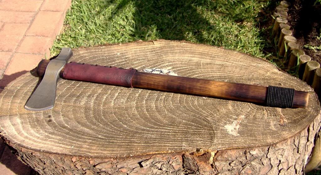

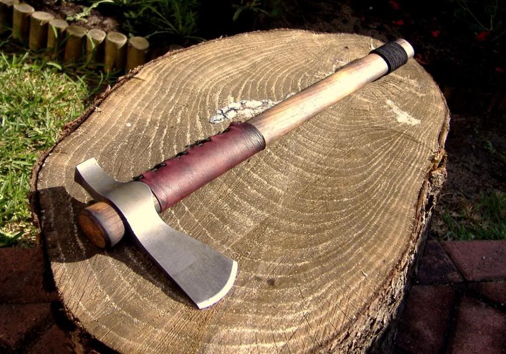

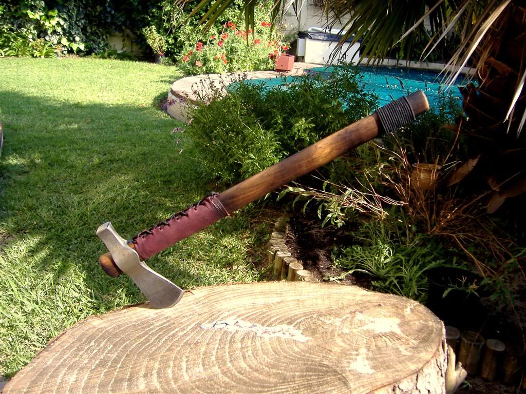

Greetings from South Africa! I've been wanting a hawk for a while now, but all that's available here is the CS range... then I found this thread. They're a little more pricey here, working out to about $45, but hey whatever.
Head was stripped, sanded, edge convex ground and sharpened, then soaked in hot orange juice(heated once) for 12 hours. Sanded down the haft, stained it mahogany, then decided it was too orange, so resanded and held over a fire to create the darkened/distressed look, then oiled. Found a scrap of leather and thought the colour was quite complimentary, so added that as a mis-strike guard. The short bit of paracord at the bottom is really just the complete the look and act as stop behind the hand.
Thanks for all the inspiration!
Chris
Chris
Simple yet elegant...I'm just a sucker for a scorched haft.
Thanks for the compliments! Yeah I was really happy with the effect of the orange juice, nice and even... thanks for the idea. I tried vinegar first, but that came out uneven and blotchy... not cool.
