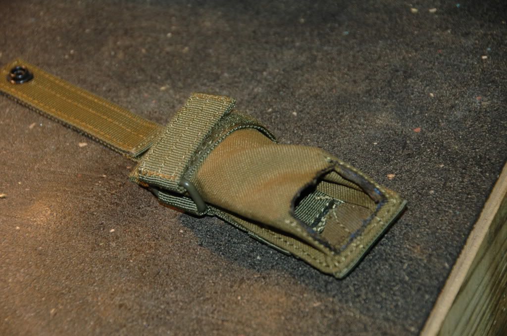

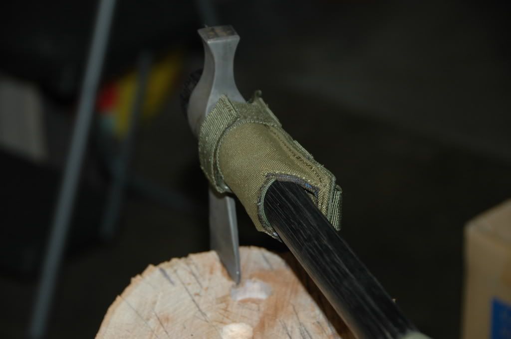

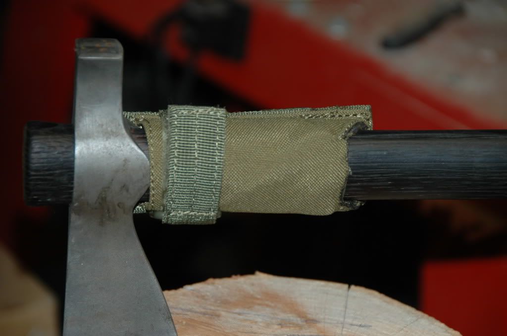

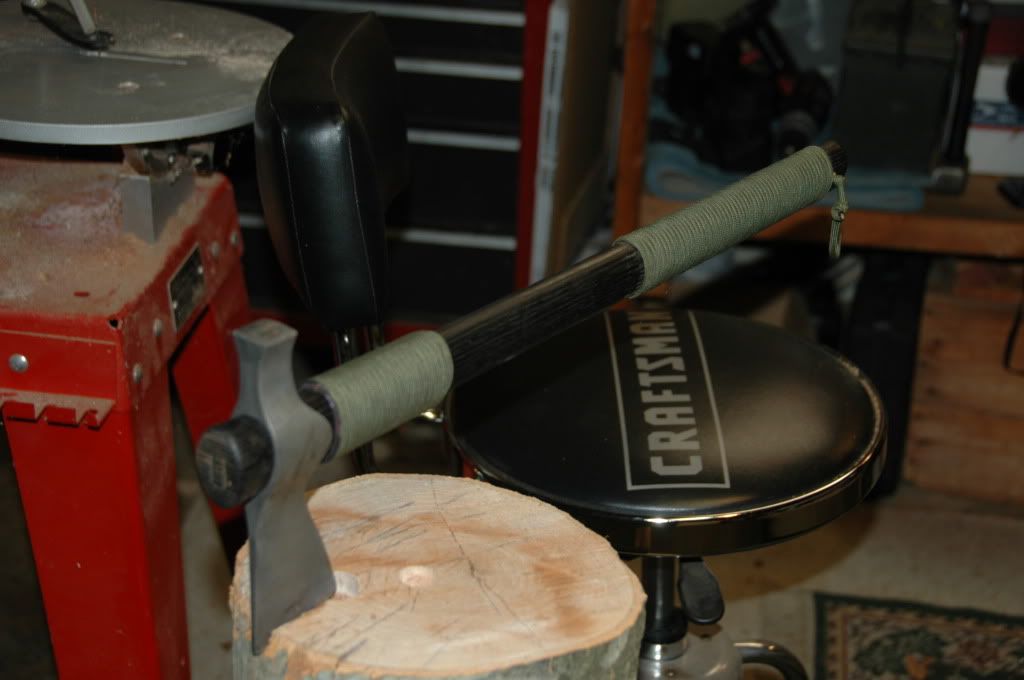

Read this whole dam thread. And decided that I had to have one of these. Here is my Hawk. Nuthin special, this one has been done before, but it is mine. Wicked little chopper. The only thing that is sorta new it the carry option that I chose. I knew that I would be packing this one in, so I started looking for a Molle option, found one. I took 6$ a molle flashlight holder, cut out the bottom, melted the ends so that they wouldnt ravel out. With the Velcro strap on the front, you can get it where this Hawk is totally secure, wont move up and down, at least not in the holder.
For the head, did all the stuff that was mentioned in the thread, paint stripper, took to work, shot blasted, vinegar, then sharpened. Turned out great.
The Haft, I sanded smooth, took a torch to it to blacken it, and while it was still hot, put liquid black shoe polish on it. After things cooled down, took a 3m pad and rubbed all the excess wax off it, and coated it down with wood sealant. The sealant was probably not necessary, since the hot wax soaked into the pores, but, couldnt hurt.
Also, to protect from overstrikes, I found an old piece of 1.5 inch water hose, cut the canvas to fit and glued it down. Then wrapped it in paracord. Then, wrapped the haft in paracord. Feels really good in the hand, and if I have to grab up behind the head, I get a little bigger grab, easy to control. This one is a user, not a wall hanger. There is nothing permanent, so I can still take the head off, if I rally need to. But, I like it the way it is.:D
That's a mighty snazzy hawk ya got there Kruger. I like the Molle solution. How did you wrap your handle? I am almost done with my own hawk and the handle wrapping comes next. When I post pics I want that damn set screw!!! lol.

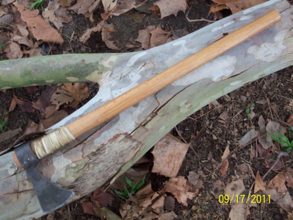

This is an old Frontier Hawk, i trimmed some of the upward curve off of the top, and grinded a little more off of the belly. The handle is a hickory sledge hammer handle I worked down (PITA :) ) and the over strike is deer rawhide strip wrapped around, it feels good and quick in the hand but my chopping aim is off, I guess im not use to the longer handle.

Dude that thing is loonnggg ! Does it work best with 2 hand grip?

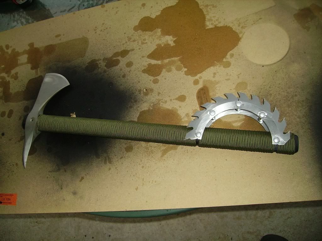

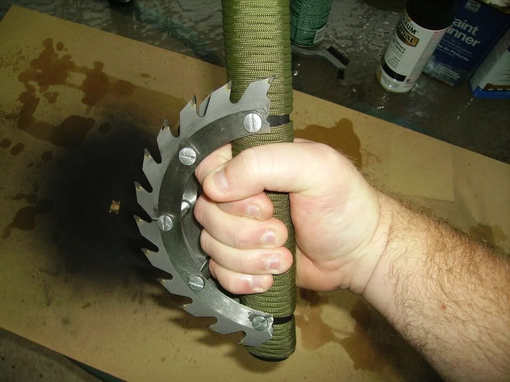

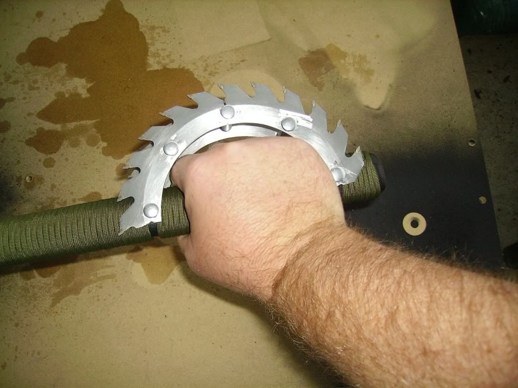

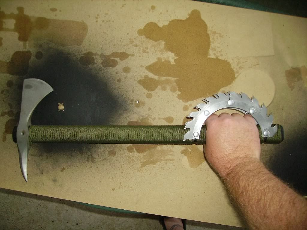

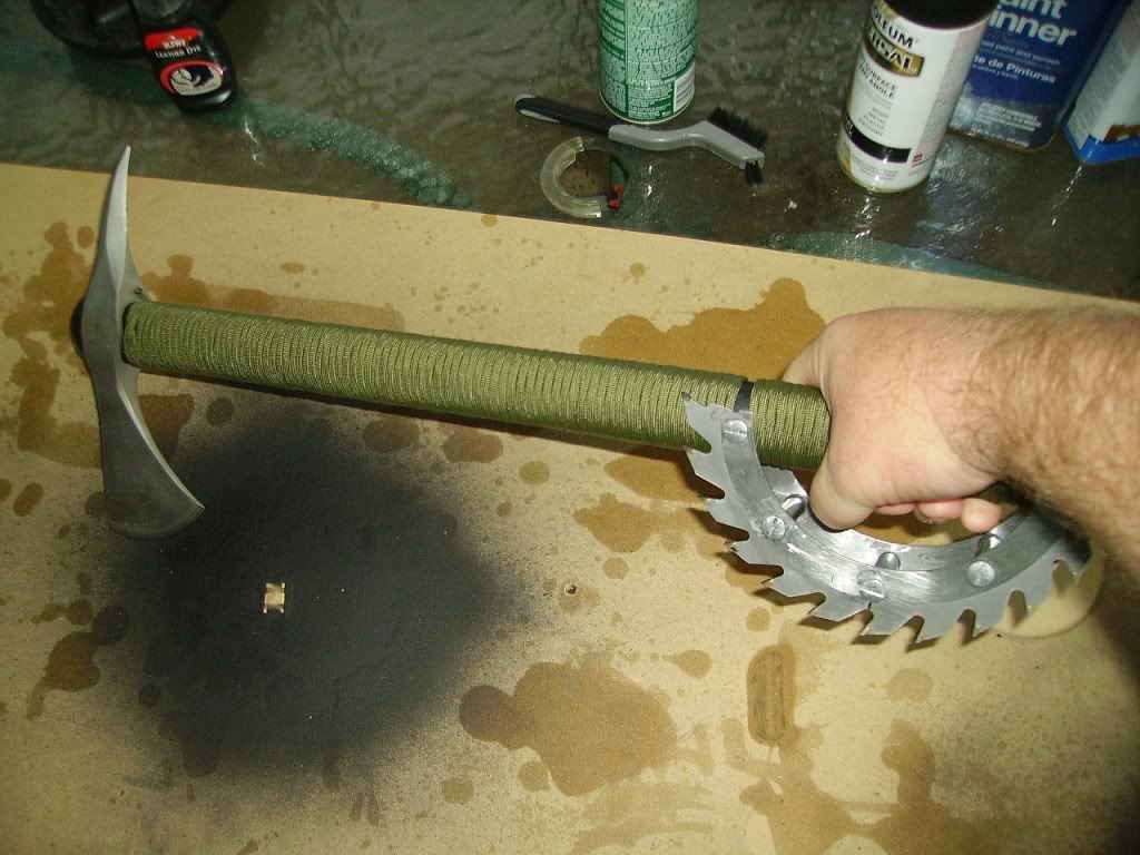

Well I am not exactly finished with it but here are some pics of what I have done so far. Kruger stripped the head and sand blasted it for me. The heat mark on the blade has quite a bit of pitting on one side and not so much on the other. Can this mark be polished away or am I looking at having to paint the head to get rid of that mark from standing out so badly? I haven't done anything to the head yet but I do have plans.....oh yes....I do have plans. Anyway, here is what I have so far.
Poke salad you might want to sand or better yet grind out the pits you don't want. Unique hawk you have there, some scary edges all around.
