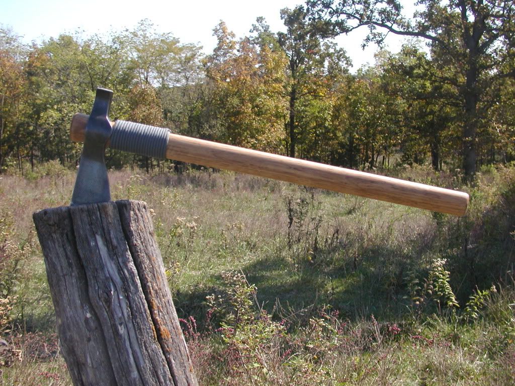

My finished hawk I blued the head and did a kinda crappy carving on the handle.
https://lh5.googleusercontent.com/-...AAAAAAAB0/p1jWyhHjvOw/s144-c/October62011.jpg
foecutter what variety of wrap is that on the handle? thought paracord but it looks tighter than most wrap it
I ran a loop in front of the haft with the loop end at the top towards the head. Started winding at the bottom when I was done the wind i put the last 3 inches of cord through the loop and pulled the loop and end inside the winding. you need to leave an extra 18 inches of cord on the end of you loop to pull on. when you are done trim the extra cord . Makes a super tight wrapping

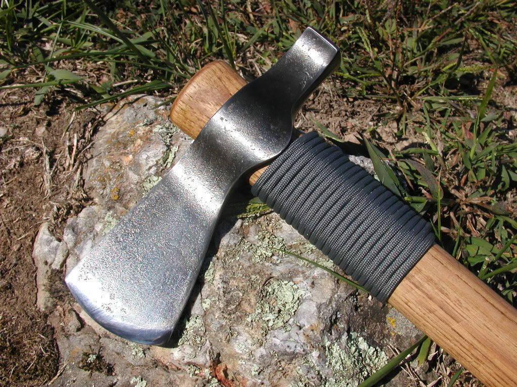

My modified Trail Hawk. I kept it simple as it will be a user.
Stripped, sanded, blued, and sharpened the head.
Sanded, stained, and wrapped the haft.
You got me I shamelessly got the design from the patriot tomahawk . The haft was so hard it was a B%#%# to carve
