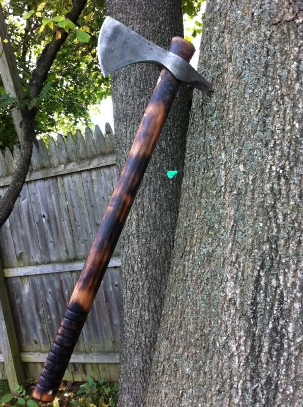

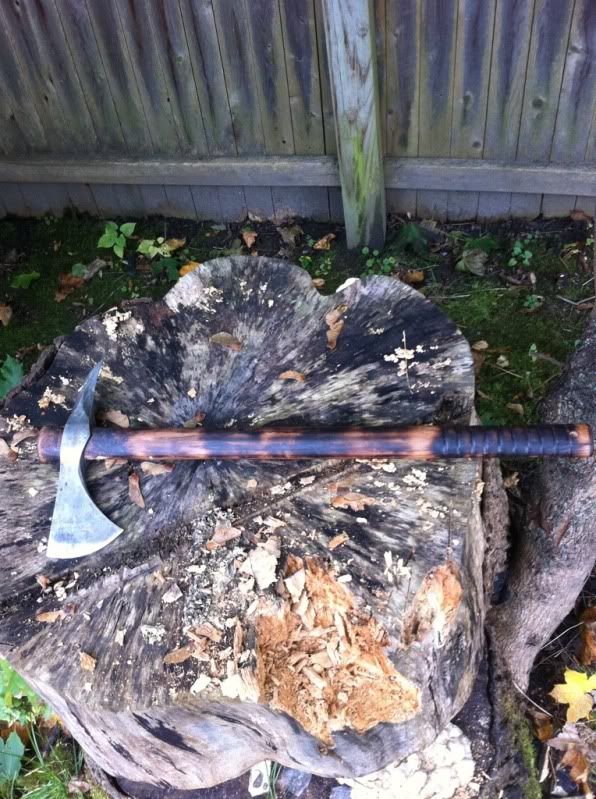

So here is my finished spike hawk. I kept it simple. Stripped the head and aged it in cider vinegar. Sanded it with 220. For the haft I carved some grooves in the handle, burnt it and sanded down to 100. Stained it with 3 coats of walnut poly stain. I didn't get the head on the haft as far as I wanted but I don't care. I'm going to throw this and use it camping. I'm pleased with my first attempt. Definitely going to do more hawk mods in the future.
The tree is on my property and coming down soon. So I don't feel bad about driving the spike into it.

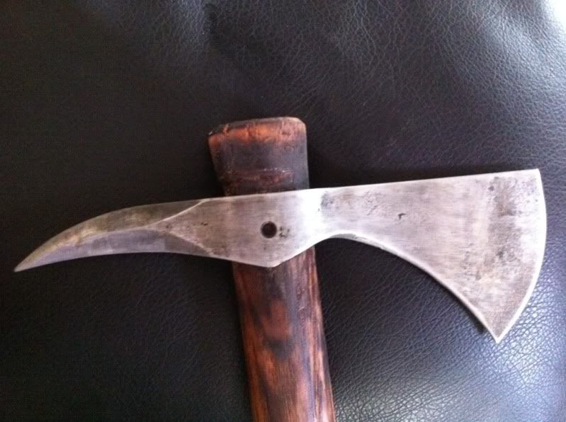

That is beautiful. How did you do the brass colored star where the allen set screw was ????
Thanks! I shaped it with a Dremel cutting disc, then filled it with a "liquid steel" like two part compound, let dry then sanded smooth.
Ideally you would use a nice metal like silver, gold, or the more affordable pewter, and melt it down to fill the hole. But I don't have the means for that. ...could have used dyed epoxy too, but the stuff I had on hand comes out a nice off white color that's not bad. :)
If you would be so kind, what is the name of it & where might one find something like that ? I am working on a CS Trail Hawk & Spike Hawk. These are my first hawks, i'm takin it very slow & hope they might turn out to look as good as yours. Thanks
I bought it a long time ago over the counter at a local auto parts store. I don't recall the exact brand, as all I have now is a clear tube of the stuff. But it looks like this style of "putty epoxy" :
http://www.amazon.com/Henkel-431348-Loctite-2-Ounce-Epoxy/dp/B000BOB8P6/ref=pd_cp_hi_1
The outside compound looks blue, but the center is white. You cut off a portion and kneed it together like playdough. It turns to an off-white to blue'ish grey color, and has the feel of sculpting putty, but hardens to a metal like consistency.
To fill your set screw hole with it, just smoosh it all in there so that it fills every crevasse, and just leave extra putty sticking out the top rather than trying to smooth it right away. Let it dry and harden for the recomended amount of time, THEN sand the excess putty down flush with the surface of your hawk.
I haven't tried it, but I think you could also use a clear epoxy like this: http://www.amazon.com/Permatex-84101-PermaPoxy-General-Purpose/dp/B000ALJ4NS/ref=pd_cp_hi_2 -and mix in a little clothing dye with it to make it any color you wanted!
-Hope that helps!
