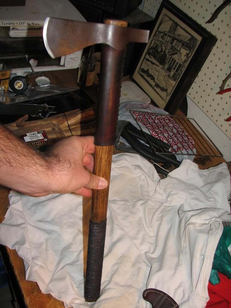

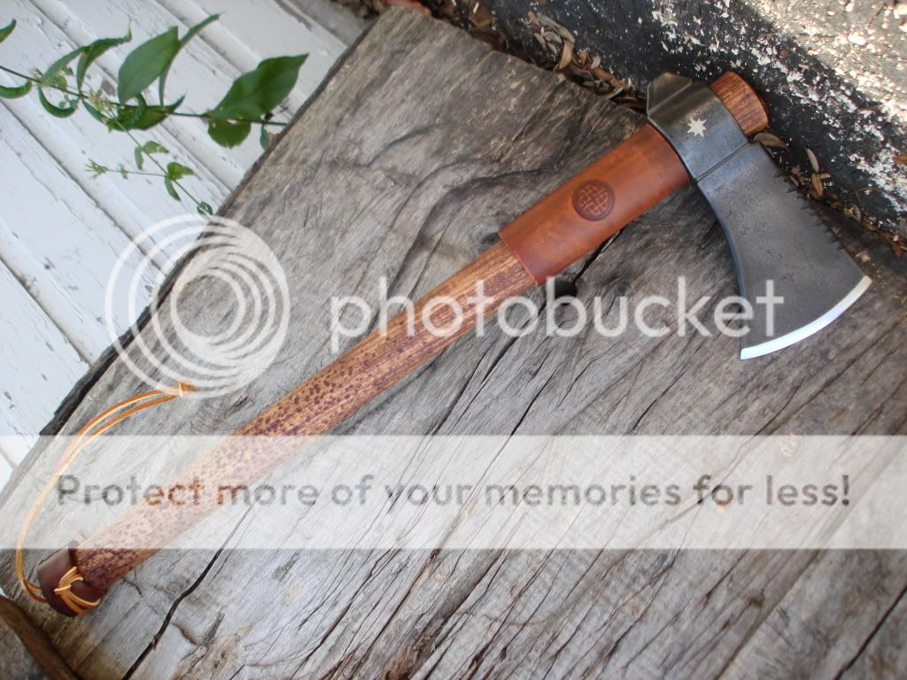

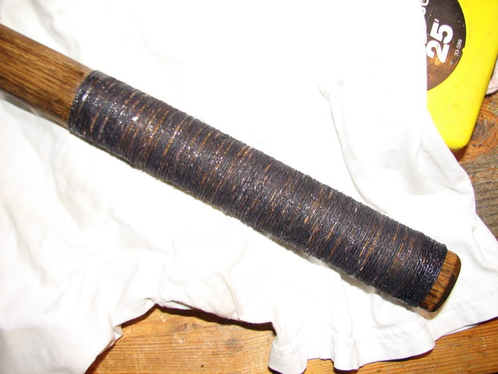

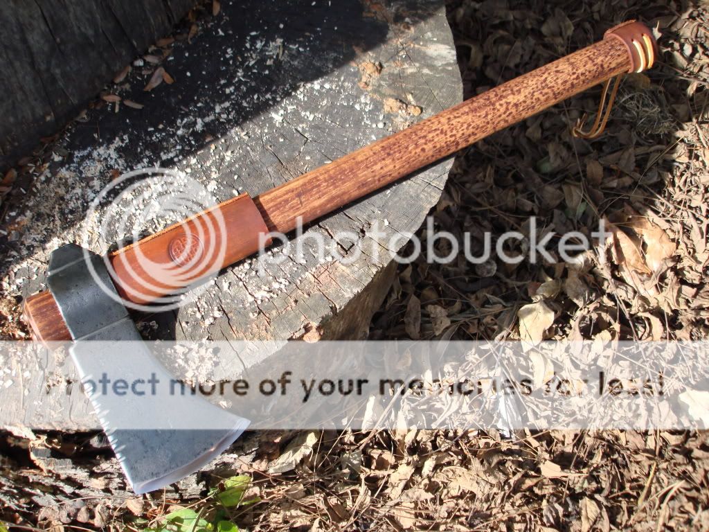

Messed with my old Riflemans Hawk last week.... here's what I ended up with:
...I decided to use a longer 22" haft, and knock off the hammer poll for better ballance.
This was my first try using leather on a hawk, it was a learning experience. I made some mistakes but will do better next time. :)
Tried to give the lower part of the handle some more grip by denting in the wood in a stippling process, my wife says I should call it "dappled" -like the horse. :)
Gave it some tacks on both ends, and some embeleshings on the head..... anyway I think it feels pretty good in the hand, and can't wait to use it!

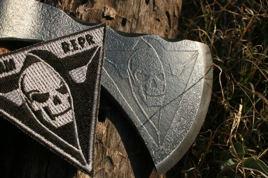

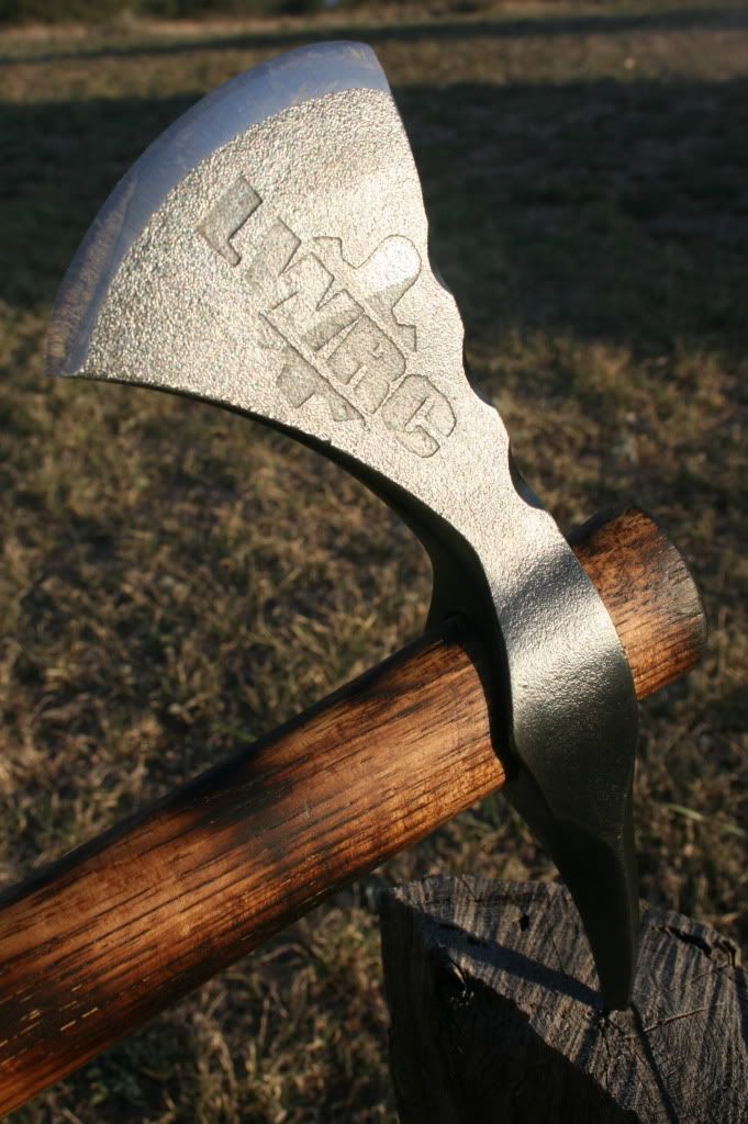

Stripped, stained, burned, ground "file-work" into spine, etched entire head, then a ferric chloride etch for the LWRC REPR logo, re-blue, then a convexed edge. Fun, big fun.

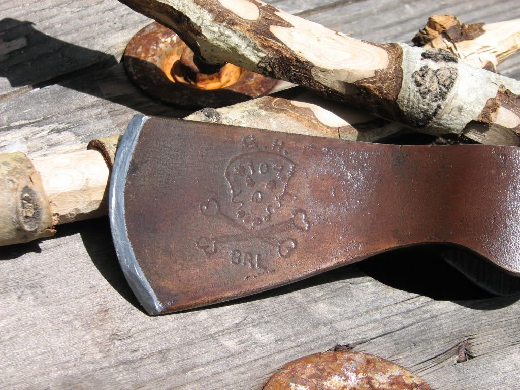

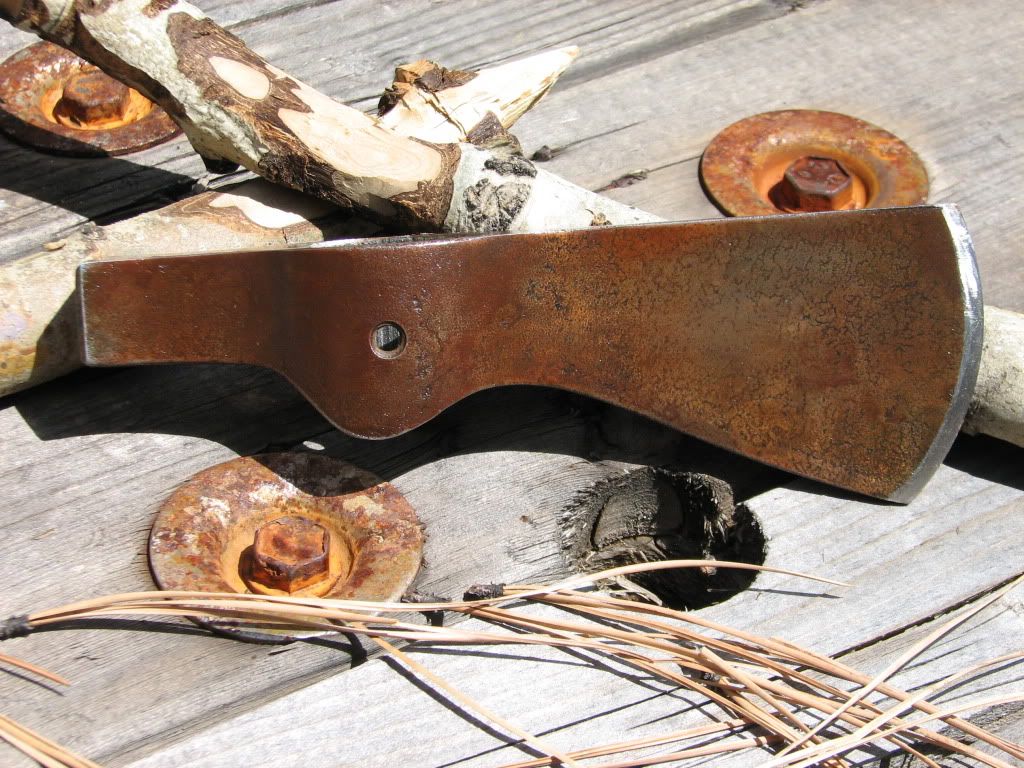

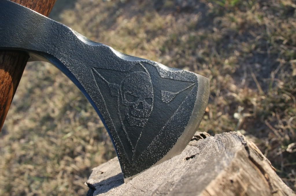

Trail hawk:
1. Stripped the head.
2. Smoothed out the eye and chamfered the edges with file and sandpaper.
3. I had originally planned on a smooth finish, but endless amounts of time hand-sanding with 60 and even laying into it with a palm sander didn't seem to do a durn thing. So I gave up, and you can't really even tell I tried to sand it at all. I like the 'forged' finish anyway.
4. Did a resist etch to add my Beckerhead number and a corny design.
5. Used Plum's to give it a brown patina.
6. Reprofiled the edge.
7. Sanded, stained (walnut I think), and oiled the haft.
8. Dyed hemp and epoxy handle wrap.

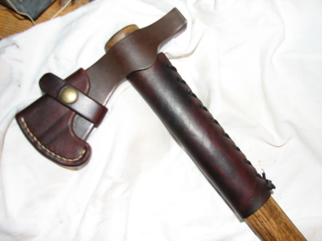

9. Custom sheath and collar from the mighty Goose.
10. The haft fit was particularly awful. I had to end up filling the empty 'air' between the haft and head with several layers of wood glue which I then sanded. I followed this up with some blue loctite to keep the head in place (but not permanently).
