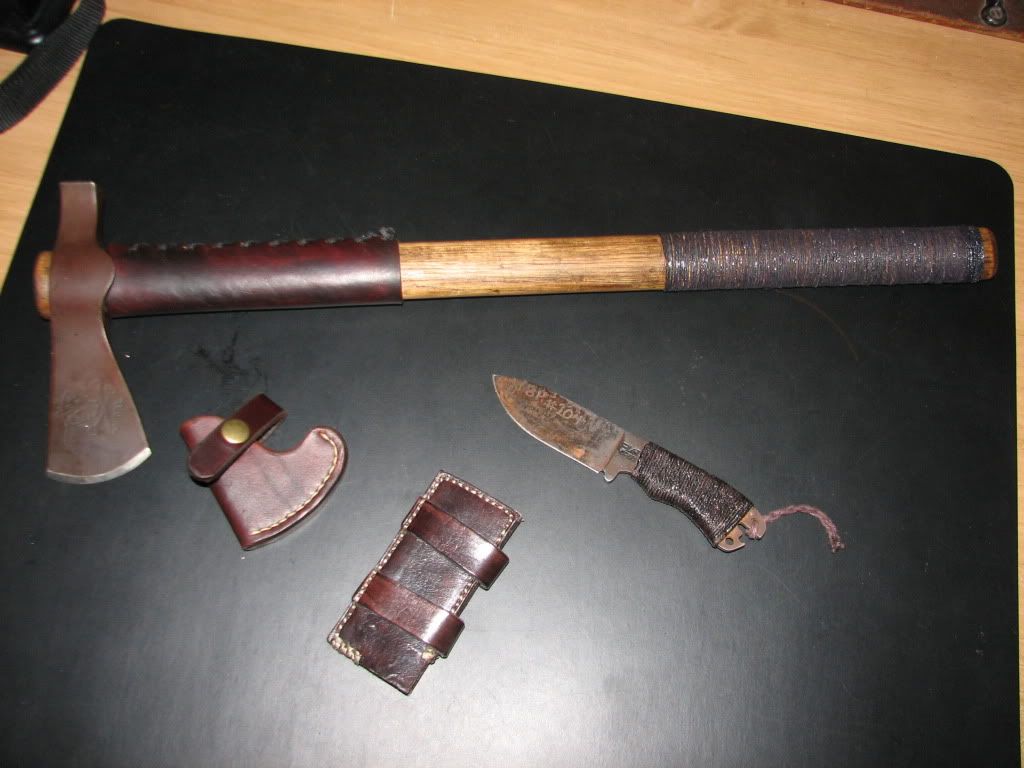

Sure thing! Tried to get as close as I could with the cell phone. The instructions for the bluing say heat the part with a blowtorch to 200 degrees, but I just put it in the oven at 200 for 20 minutes, seemed to work just as well. After that all you need to do is wipe on the chemicals, boil the part for 5 min. Card with steel wool and repeat until it's the color you want. Mine took about 5 repeats of wiping, boiling, and carding.
And I managed to get the pipe hawk rewrapped. much happier with how it looks now.
Edit: Better pics from a real camera
That's real nice. Sounds like bluing is one of those tings where the effort put into it is little compared to the outcomes
And here's a group shot of all my Plum's projects. The Warthog will be getting a wood and hemp wrapped handle, the BK2 will be getting the patina sanded off since I want to use it for food and etc.
