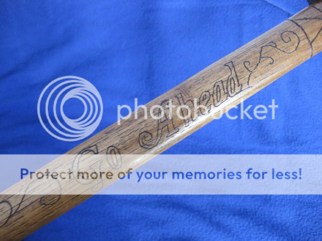

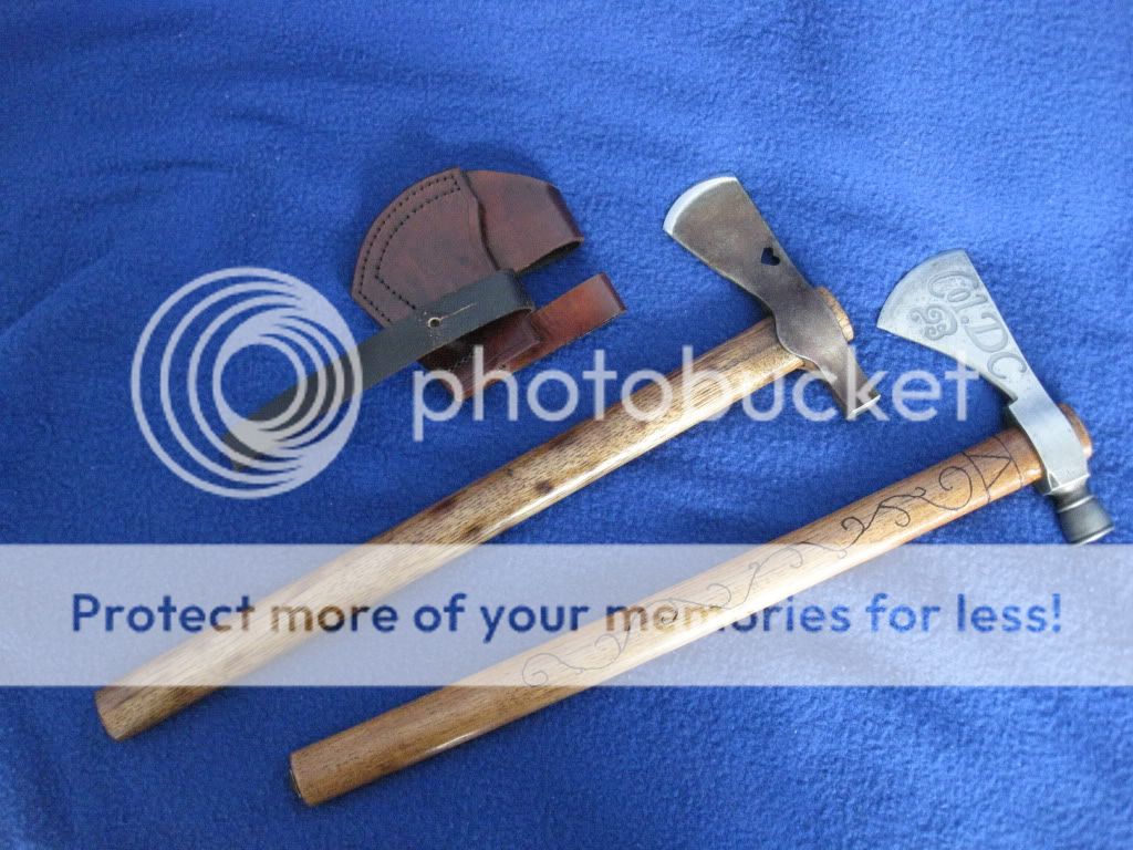

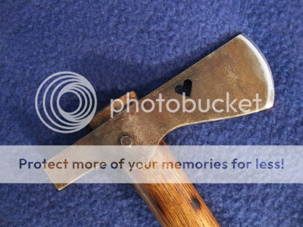

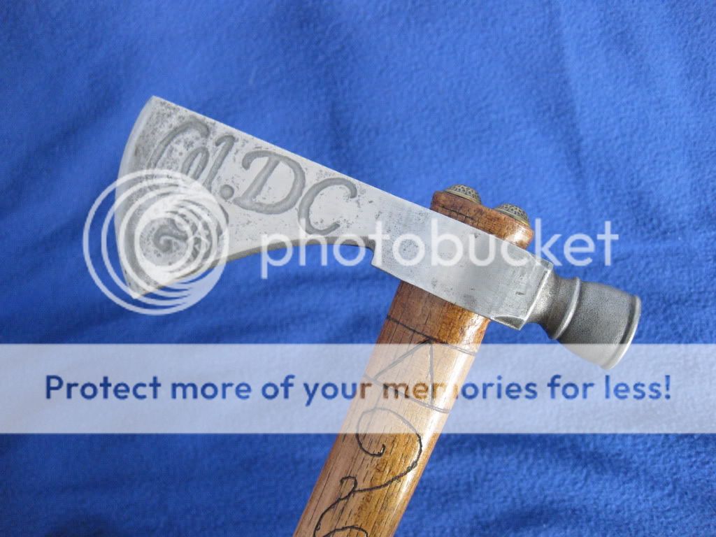

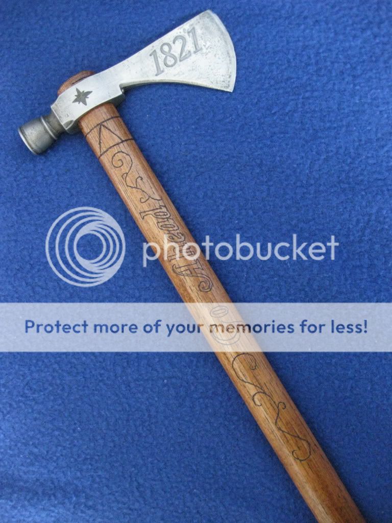

I have read through this entire thread starting 2 months ago and also got hooked. I picked up 2 trailhawks,1 pipie hawk, and one spike hawk. Here is what ive done so far.
The etched hawk was inspired by a book I just finished reading about David Crockett. He was promoted to Colonel of the Tennessee militia in 1821 after the Creek indian wars. His favorite saying was " Make sure you are right then Go Ahead". This hawk might have looked like one that would have been presented to him. Of course it would look at lot better than this one.The etching was a pain in the @$$ to do right. The ectchant got under the edges of the paint. The second one with the heart piercing was inspired by Ryan's Singman poll hawk. The sheath was made by Walks by Faith. Top notch quality and service. I will be a repeat customer.

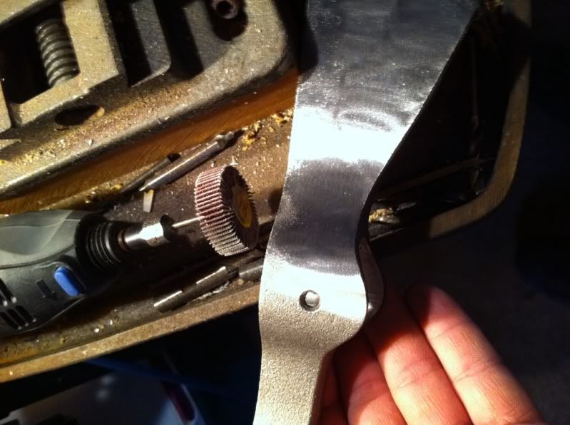

Here's the progress on mine. Stripped the paint obviously, and began workin out the pits & roughness with a dremel flap wheel. Works amazingly well!
Makes me want to get a beefier dremel... I just have the scribe. Very nice for very fine work but a larger model would go far, too.
I like how that flap wheel is working... I need to get one of those. Have a dremel. Just need the attachments. Files and sandpaper work well but take a looooong time... :D

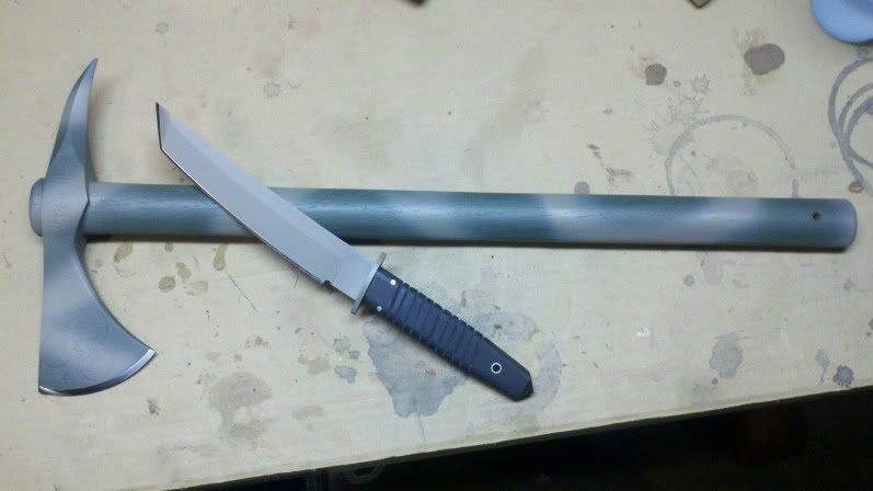

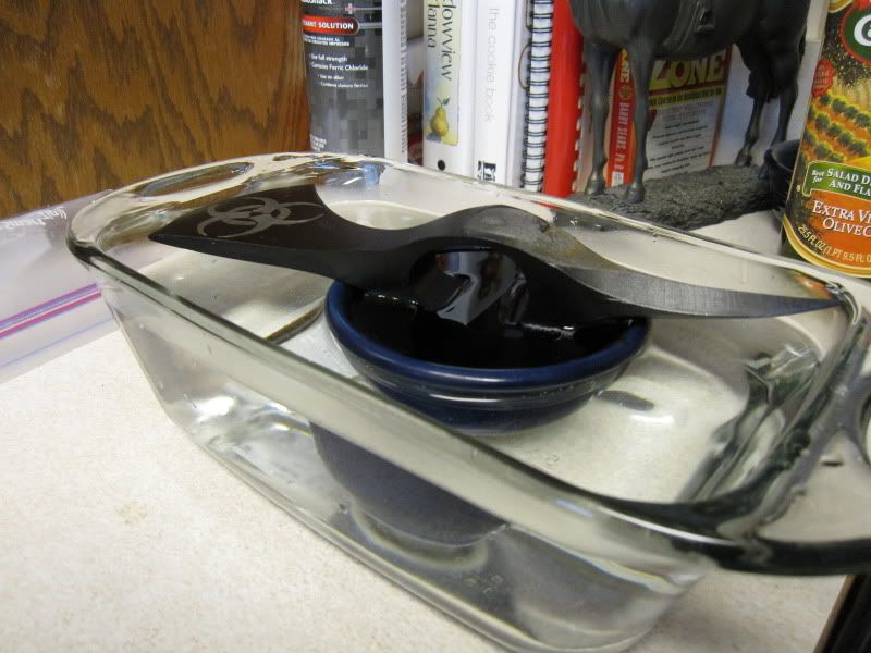

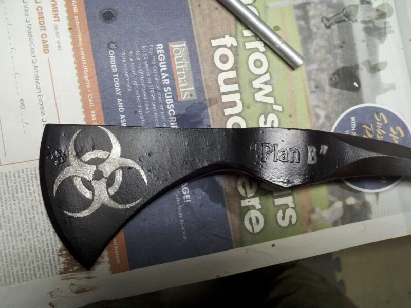

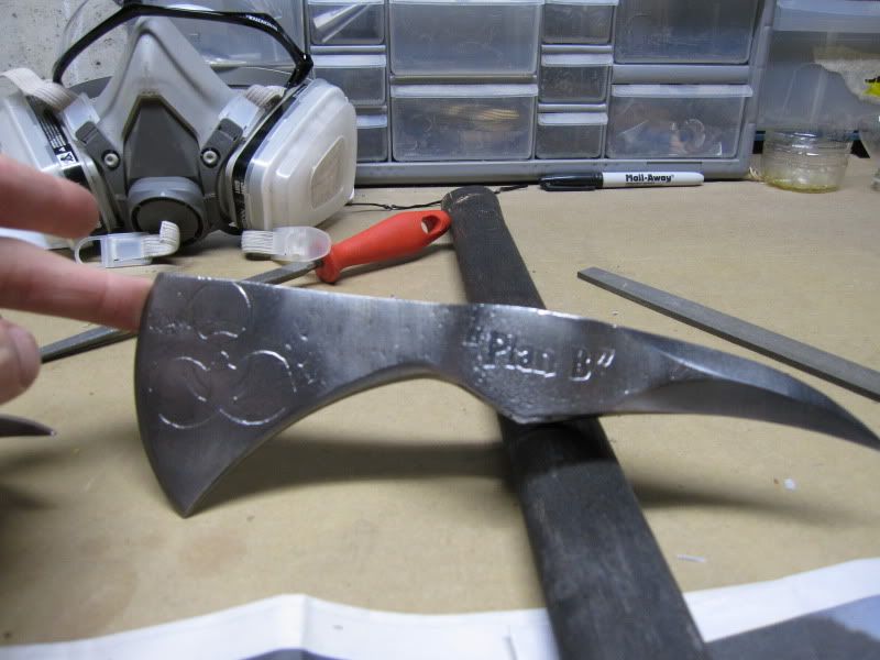

Without further ado, may I present Plan B (since plan A might possibly run out of bullets...)

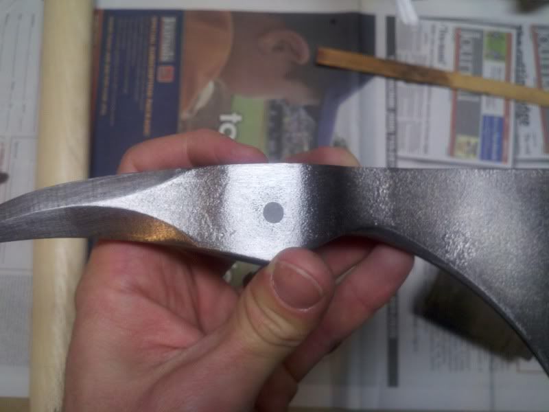

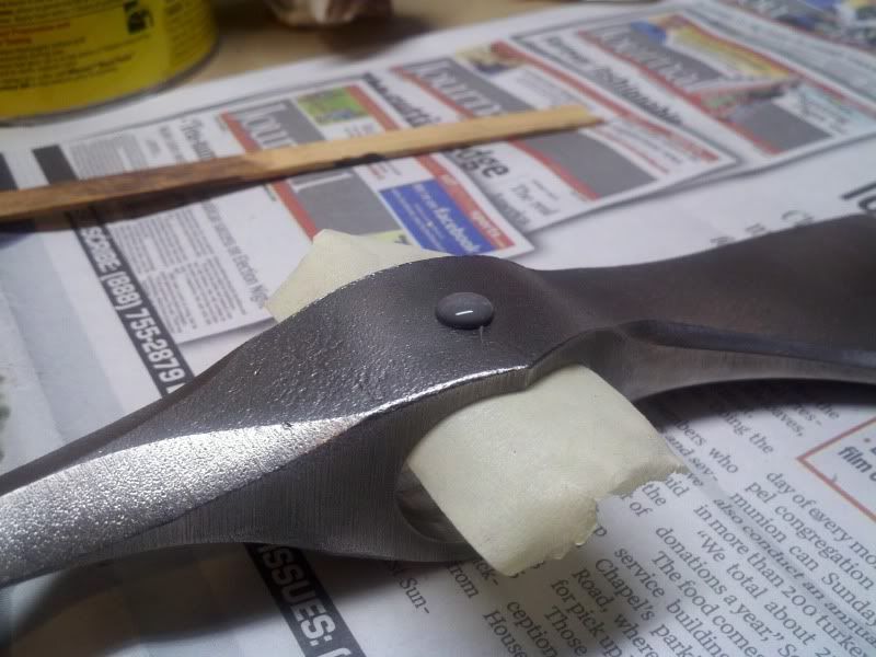

I stripped the head in the usual fashion. I filled the screw hole with JB Weld.
Once the weld set, I flattened out the excess and stippled it with a center punch to blend in with the forged head.
The stencils.
Masked and peeled.
Etched with the stuff from Radio Shack.
After etching.
An initial Duracoat job with Magpul Flat Dark Earth.
Here it is after the final coat. I Ended up re-spraying it with an OD green base coat and then used desert tan for the light color.

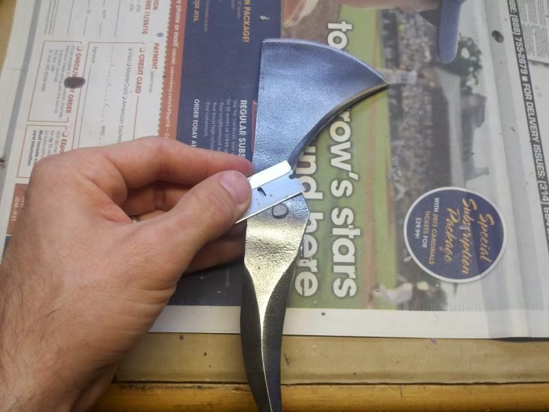

The finished hawk with another project of mine (cold steel blade, everything else me). I like the way the paint job turned out, though it does make the etching a lot more difficult to see at any distance. I used that sandpaper-and-mouspad technique to put the final edge on the hawk and the knife. They are sharp as hell. Hope you like them.
