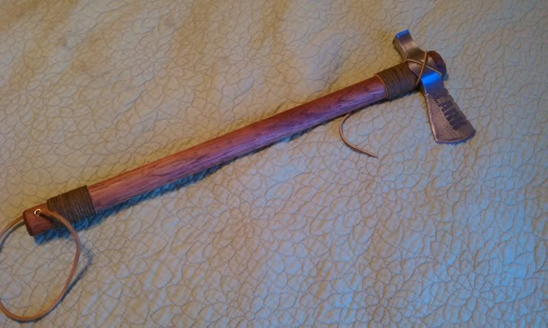

Here is the 1st one. This was my "test bed" before I made the one for my brother.
Stripped, lightly sanded, but leaving some of the rough finish, etched, sharpened etc.
I'll end up giving this one to a co-worker who is an avid trapper.

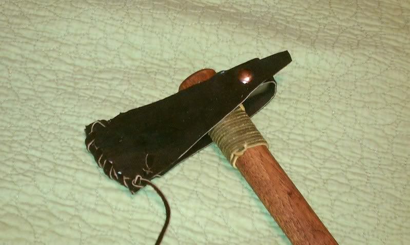

I'm ok with metal, but brand new to working with leather. However, I found some deer hide scraps in the basement and said to heck with it...

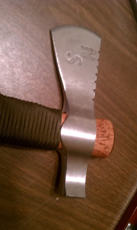

Here is the one for my brother...
I am less than pleased with the electrical etching.

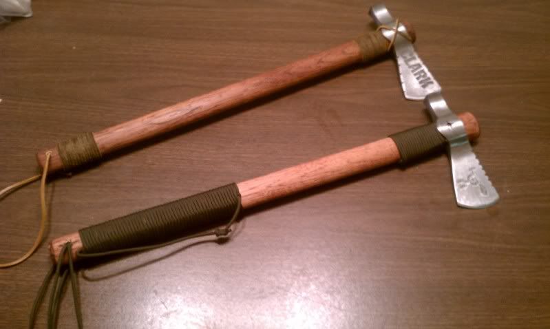

I've been itching to finish these two Xmas gifts - one for my mom and one for dad.
These are my first mods, so they aren't perfect (in particular my first acid etch) but I'm pleased with the outcome. Any criticism to fancy them up is appreciated and welcomed! :thumbup:

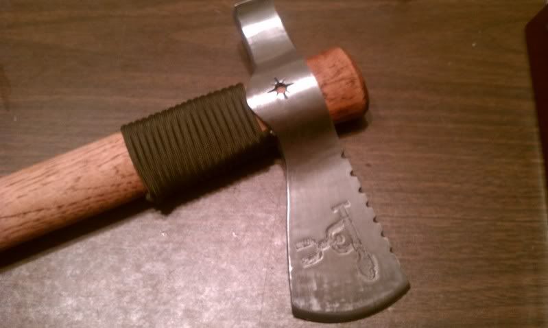

For my dad I wanted to engrave his company logo on one side and his initials on the other, neither came out very sharp and resulted in me trying to re-etch a few times. I decided not to push my luck once his logo became evident enough. The pole was reshaped as a window smasher/dull spike. I blued the blade, added a few decorative file marks along the top, shortened the haft, black coated, cord wrapped and added black tacks.
For my mom, I acid etched a Fleur de Lys to represent her French Canadian heritage and her initials on the opposite side. This etch came out nicely. I finished the blade with a vinegar patina (the flash makes it appear rusty, but it isn't). As you can tell I slightly reshaped the pole and blade. The haft was finished with an oak varnish and twine wrap. A few brass nails and tacks were added for decorative purposes.

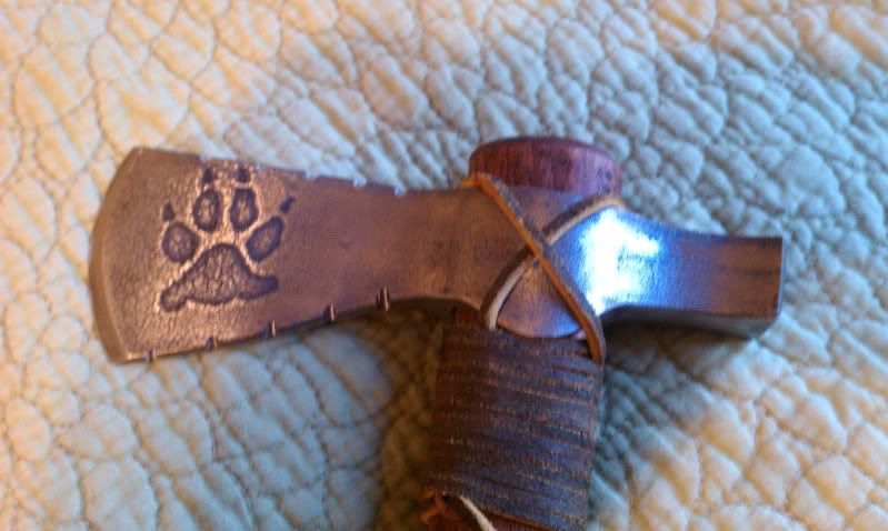

I'm new to writing in the forum, but not new to reading it. I've read every line in this thread and have just been waiting for the free time to mod my hawks using the information I've learned here. I wanted my first post to be of my modded axe.
So I've started with my Norse hawk because I haven't seen too many on here and I love the design. I used all of the posted paint removal using Jasco, and etched the design with radio shack ferric chloride. Etching was done overnight, I'd say about a good 15 to 16 hours. The design idea came to me after seeing pictures of old viking ship prows. I looked through other designs but dragons and wolves are harder to make, and I figured this would look more abstract. I then used gun blue on the head, then used super black gun blue pen to slightly darken the inside of the design a bit more to make it stand out. Anyhow I like how it came out. Following tradition I have a pic with my handmade knife and sheath. Knife made by Bill Addison of Nueces River Knives Texas, and sheath made by myself. I'm going to make a sheath for the axe next. My next project is my pipe hawk. I'd like to thank everyone on this thread for starting another addictive hobby of mine!
