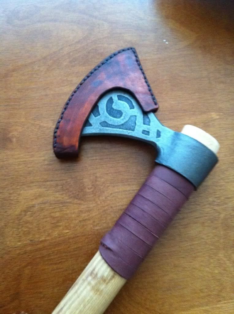

Very nice etch. What method did you use to create your stencil? Some kind of sticker paper?
Thanks guys,

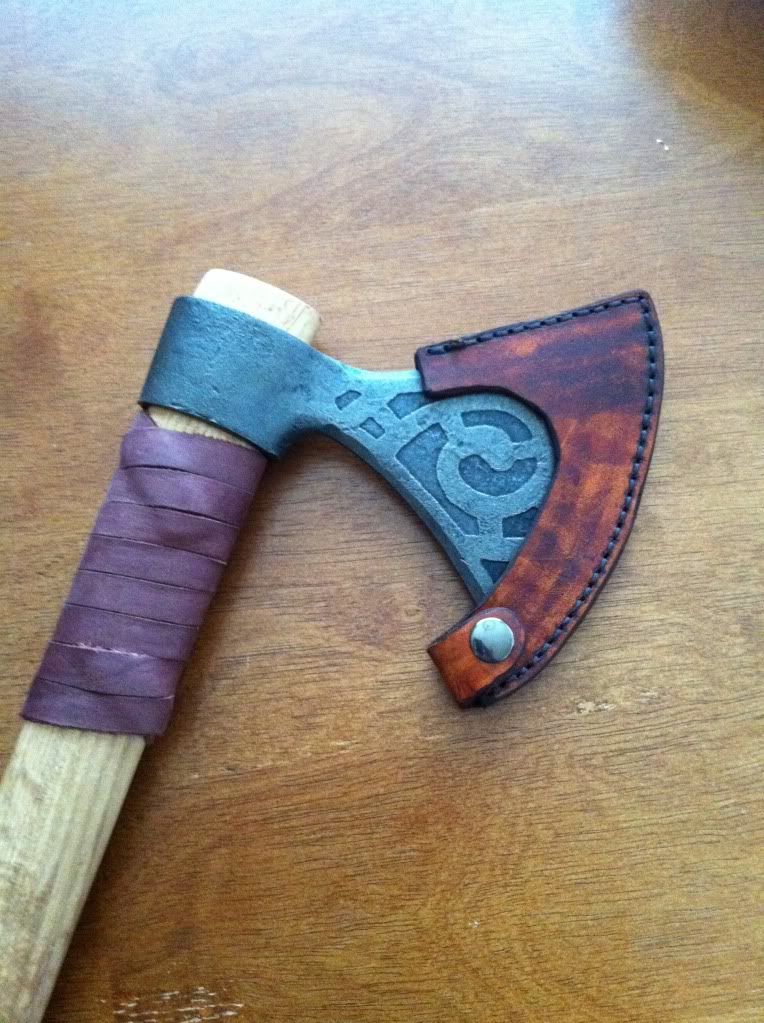

For the etching I just covered the axe with masking tape, then drew the image on the masking tape using a predrawn image as a sort of carbon copy. The image on the paper is on both sides of the paper. When you draw over the image on the masking tape again it transfers onto the masking tape. Then I used a razor to carfully cut out the image along the lines. Then after I had the image cut out I of course pulled everything else off I didn't want painted. Then hit it with 3 coats of cheap flat black spray paint from wal-mart. Then I used the razor to carefully peel off the masking so I didn't ruin the paint. Afterwards I did the etching. I just finished the sheath today. I may make a belt loop or something, but its mostly going to be hanging on the side of my pack.
Oh and 3 coats was okay, but I did get a little pitting on the other side because the paint did bubble a bit, but it actually looks good and makes the axe look antiqued.
Justin
Pics w/ the sheath I just finished. Sorry they are from my cell phone.
I was never interested in a norse hawk until I saw that etch, one of the nicest hawks in this thread for sure!

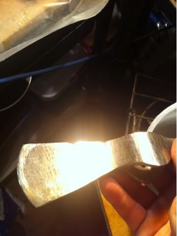

Did lil more work on mine today to the addage that, the smoother it is, the less rust can build. Even tho I'm intending to blue it, I figured the etch will stand out better as well.
Here it is wet sanded from 220-320-400-600-1500

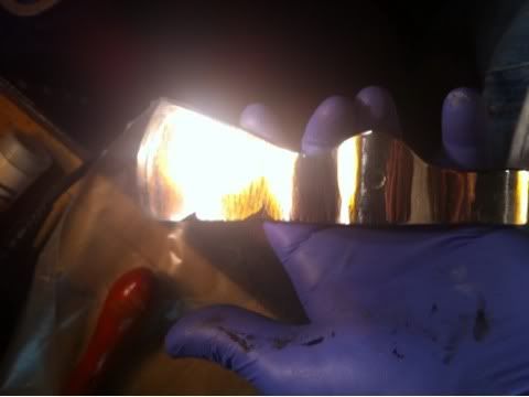

The results of dunking the head and sand paper during the process. It was clean water when I started lol

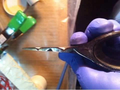

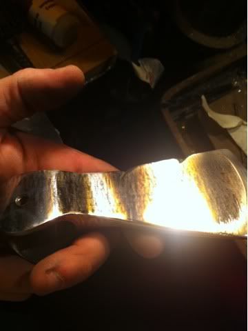

Lil shoddy file work

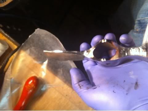

And this is after buffing with green rouge and then rubbing compound
