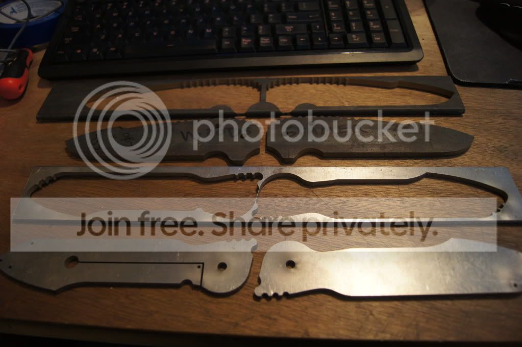

Massive folding frame lock knife built with .190" Titanium slab handles, .25" flat ground 5160, and micro roller bearing .25" pivot.
I will document the entire process because there has been a lot of chatter recently about the IKBS and similar systems. My goal last year was to have a table at BLADE this year so this will serve as my prototype for a line of large folding knives. OK so first things first here are the plans drawn out for the knife. Blue circles represent the micro roller bearing around the pivot and the .3" tri-ring stand offs. A stainless steel hardened .312 thumb stud will serve double duty as my stop pin.
Any and all comments are welcome. Hope you guys enjoy the ride!
The water jet parts came in today! They look perfect, all dimensions are just a hair undersized just how i like it. I'll get the holes reamed true this weekend and counter-bore the blade for the bearings.
WIP thread here: http://www.bladeforums.com/forums/s...IP-Massive-Titanium-Roller-Bearing-Frame-Lock
