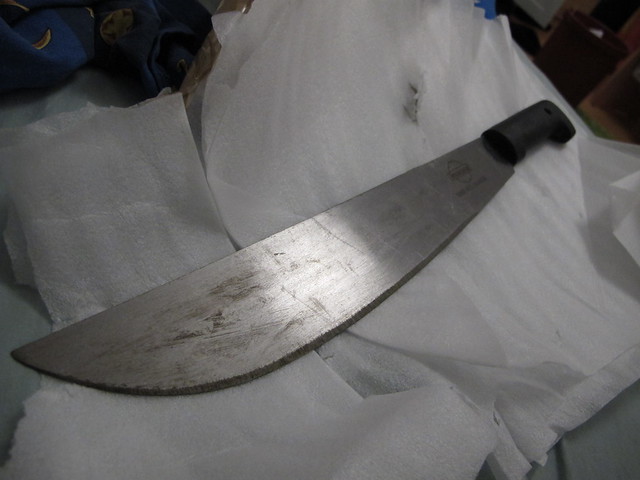

It turned out to be a 12" machete, made by Imacasa in El Salvador.
