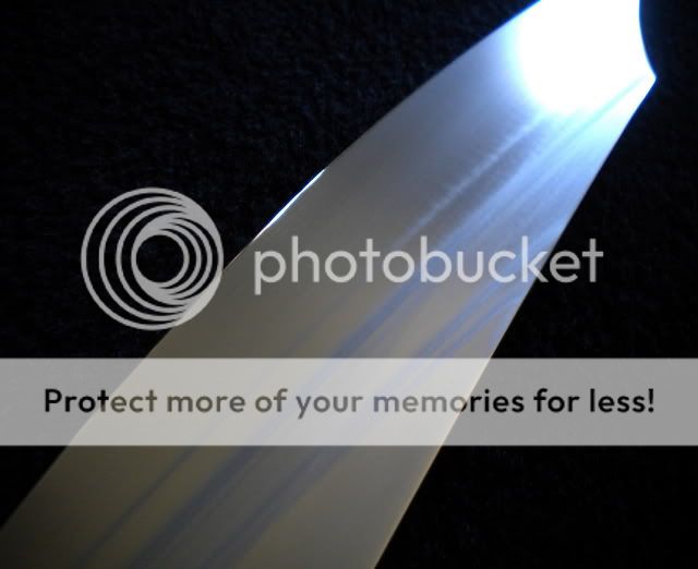

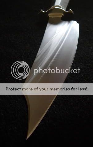

Here’s a recent rainbow quench on 1095 in “thrice used” canola. I’ve had the best results on these with canola that’s been broken in a little, and get the most “activity” on fairly thin blades. Fresh canola will work on these, but you have to adjust your temps., timings and geometry a little.
What's up with that rainbow quench anyway, Tai?
Do you wish to divulge anything about it? Are you just pushing the edge in farther incrementally as you quench?
I think it looks cool...
Crazy mixed up microstructures. :)
Yeah, it's a modulated rate of submersion, something I developed myself. The edge goes in quick, then it slows down and gradually chases the heat out of the steel incrementally. It’s a single quench, but no two are done exactly the same. It works together with the wedge shaped geometry of the steel. Since the geometry is a bit different on each blade, the temps., and timings are done "intuitively". The best results have been on fairly thin and wide blades. I'm serious about the used canola for these types of quenches. Fresh canola is just a bit too fast. It can work, but just not as well. With fresh canola you're lucky to get 2-3 lines. On a bad day you only get one line reguardless of the age of the canola.
I will say Tai, that your quench lines do look really cool.
Edit: Is that naturally occuring ashi on the bottom line? I really like how that works out without the clay...Nice job.
Thanks Mike. Yes, those ashi lines are without clay, if that's what you mean. They only show on the bottom line in the pix, but several lines have them. I don't get those on thicker blades. That blade was forged from 3/16th, but came out a hair under.
The overall properties are somewhere between an edge quench and full quench, which sort of makes sense. It's a little of both,... but neither. By the time it's fully submerged the back is at/near a black heat, but oddly it still often picks up some detail there. It is metalurigcally very interesting to me. From my own testing and the feedback I've gotten on them, they perform very well.

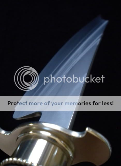

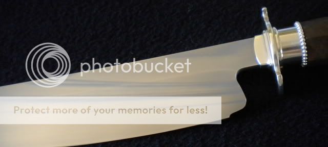

Speaking of crazy microstructures.... this is a blade I just polished out. W2 quenched point down into Park 50... no clay, just time and temperatures at work. ;) :)

Nick I officially hate you! that is an amazing blade, you just using the thickness of the blade and the quenchant speed to cause the temper line/Hamon?
and are you getting royalties for that les schwab add?:D
Damn nice Nick! That looks beautiful. I saw a very similar hamon on one of Kevin's "GitchagoomiGane" blades(tamahagane bloomery steel), with no clay....makes me jealous lol

:thumbup:...Nick, very cool. I do the same thing with Diehl W2. (We don't need no stinkin' clay.) :)
