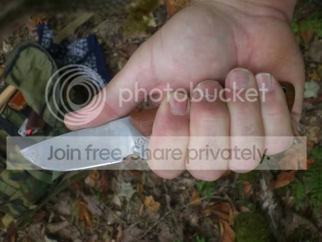

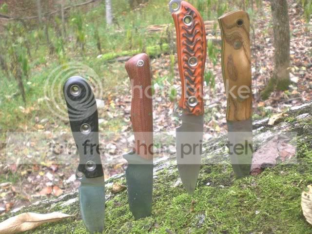

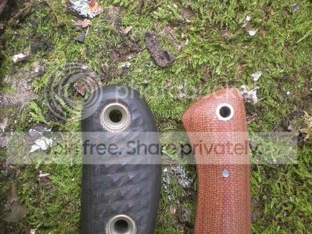

The handle is a little small for my hand. When I cut with it I the knob at the end would hurt my hand a little but there was no digging into the back of my hand because the handle is very broad across the spine :tu:
If the handle was 1/2" longer or slightly rounded and larger like this it would make it more comfortable.
Of all these I tried the NWA fit my hand the least

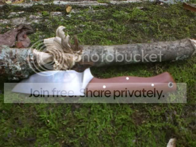

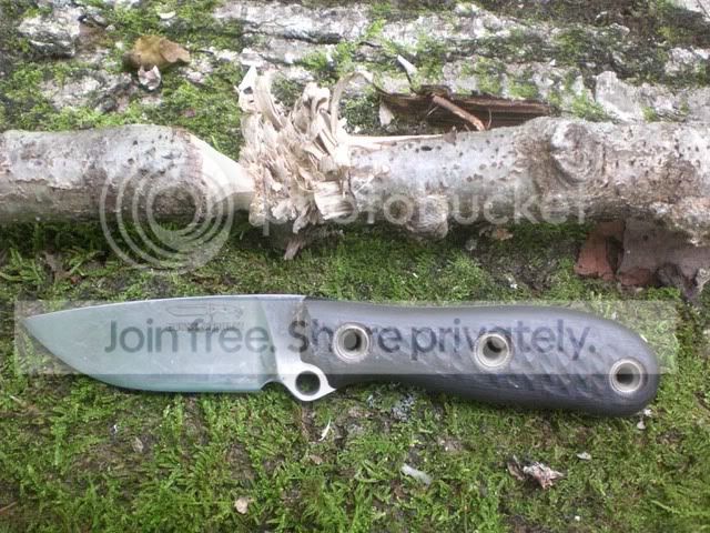

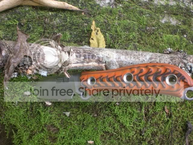

It cut WAY better than this Busse BAD with the stock edge. In fact the BAD was so steep I gave up before I even whittled the thing thru. Don't know if you can see but you can see how fine the curls are. That's because the edge is so steep it can't penetrate enough to do fat curls
It also cut about 20% better than the game warden. I don't know if you can tell but while the game warden cut better than the stock edge BAD the blade is thick so the convex edge is still thick so I couldn't take as much wood with a single cut(notice how many cuts/curls) Still I could easily cut thru it with the Game Warden.
This knive has an excellent edge for a V bevel knife. Can you see the curls are thicker than on the previous 2?

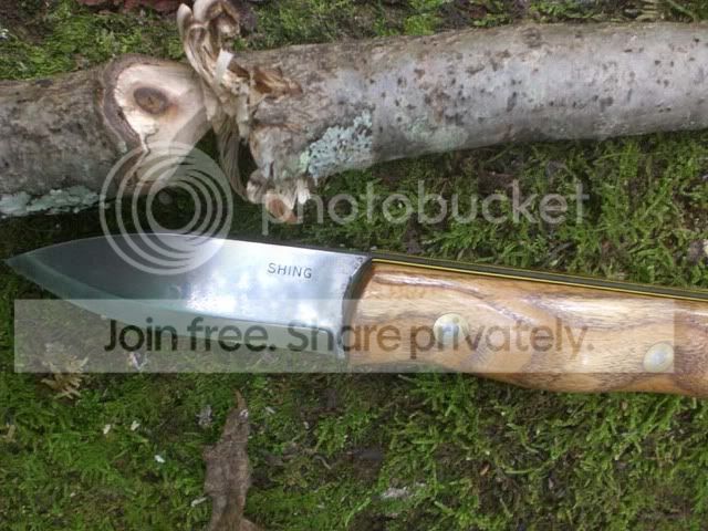

The best knife of all though maybe not the sharpest looking was the Shing. I wish I would have had my Charlie May Swamp Oak to use too but it's on the way back to me. The shing has the most comfortable handle which is to be expected since I made the handle to fit my hand and the 1/8" scandi grind blade you could cut the deepest. even cut right thru the little knot
