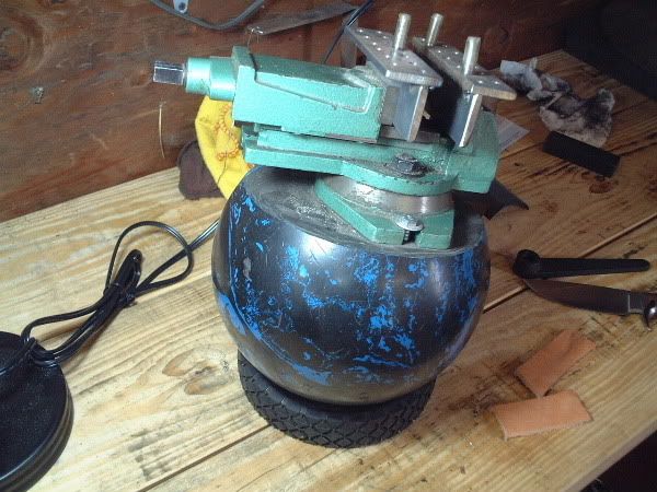

Nope - for that you use the "bowling ball" vise so you can chase the silver wire 'round and 'round the handle and YOU can sit still!
Wow that is a neat vise, I've just inspired :thumbup::) OK let's butcher those bowling balls...
