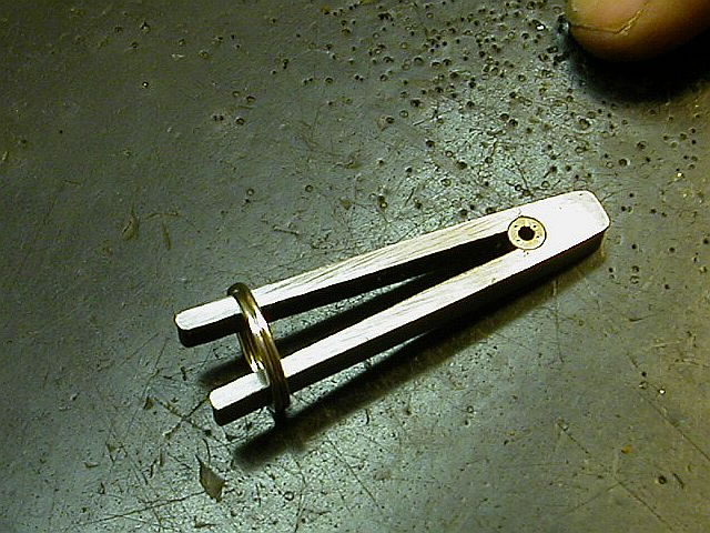

Here's a picture of a "hairpin tool" from Tony Bose's website, used to hold a brass bushing while he drills and reams the hole. I think it is a work of simple beauty!
