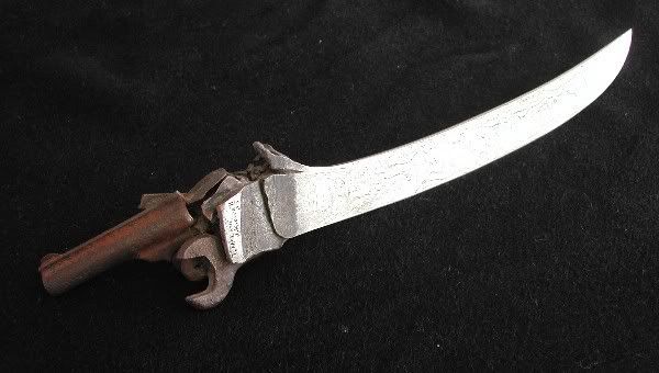

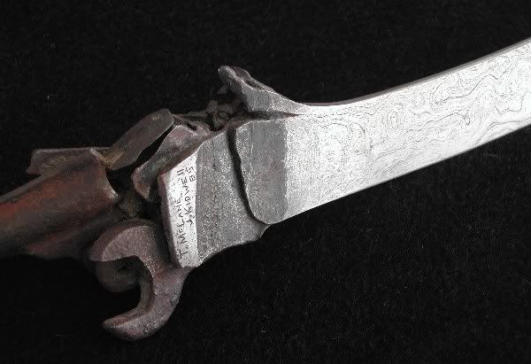

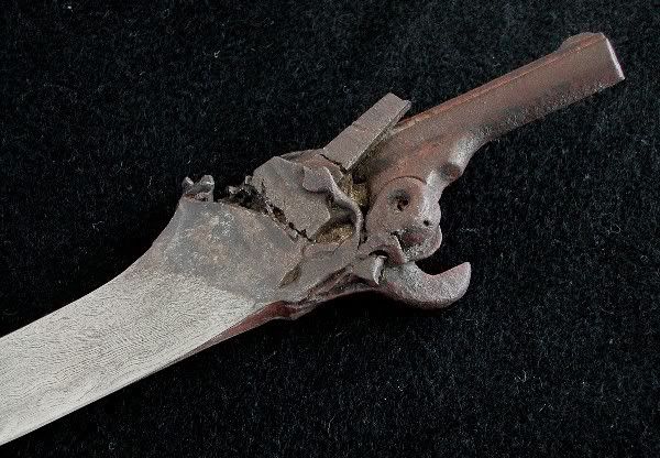

Here's one that would be impossible to duplicate through pure stock reduction. It's a pattern welded blade collaboration by McLane and Kidwell... but then on the other hand, there are some knives by guys like Gil Hibben, that would be "virtually" impossible to forge and/or duplicate and for sure impractical,... with a fire and a hammer. :)
I think David is correct. You can't take the "human factor" out, without taking the maker out.
I should go post this one on the “favorite customs” thread. :)
I doubt any stock reduction maker could duplicate this knife nearly as fast as I could forge it or capture the character of it,... and I'm sure there are others that they could do much faster with a totally different character.
Might not be possible to do it at all if it had to be done from the same piece of stock. Assuming the piece of steel was large enough it would be a real pain to say the least. Advantage....forging.
Much depends on the maker, his capabilities and experience. The top blade is stock removal of 1095. It was much quicker and easier for me to make than the one below which I forged from 1084. A different maker that has more experience with a hammer and anvil than I have could likely beat me forging the same bottom blade.
I did have more fun making the lower knife.
Harry! I don't think there would be any dang way to make it from the same sized stock. That's for sure! :)
