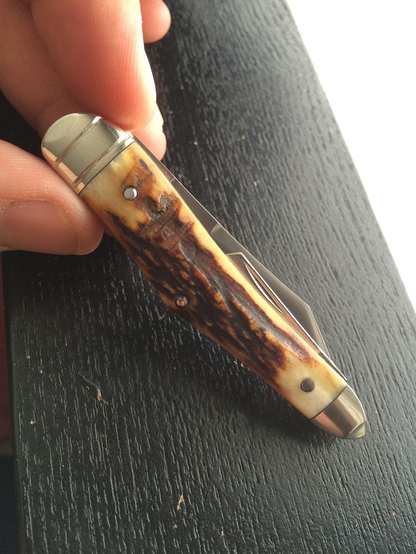

I got my Humpback Whittler back today- 4 months after they recieved it (Dec 1/14). I had heard nothing since Feb 25, despite two emails (one being this weekend, so I'm not blaming them for not answering that one). They got a majority of the wobble out of the main blade. Still a fair bit, but much better. Both secondary blades have good nail nicks.

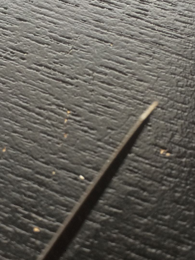

I am utterly disgusted with my service. The work order says to hone the knives- not what I asked for, as I had spent hours reprofiling the edges on my own to make them work. But maybe with it being on the work order they took extra care to get it right! What a freaking joke. I'm livid. The pen blade has absolutely no edge whatsoever on it!! The edge is actually a 90° angle!! Ridiculous! I tried to show it, these are the edge, not spine:

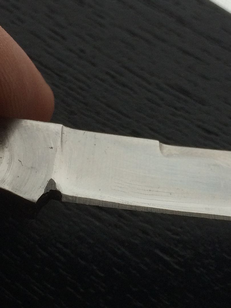

The coping blade was put to grinder and left with a burr, on top of the ridiculously obtuse edge put on it!! And the edge profile is now rounded- not a straight edge like a coping blade is supposed to be- it's a bellied edge where tip and choil are higher than the middle of the blade!!
I had nicely convexed the main blade, taking its edge back so that it would slice a bit nicer, due to the obtuse grind put on the blade. The regrind was just a coarse grind at what looks like a 45° angle across.
Dulling absolutely the bellied part of the blade, and rendering the straight edge to be very rough to cut with. Both secondary blades are lazy opening as well. Decent snap closing, but almost a friction folder to open.
Ground up into the tang, not there before

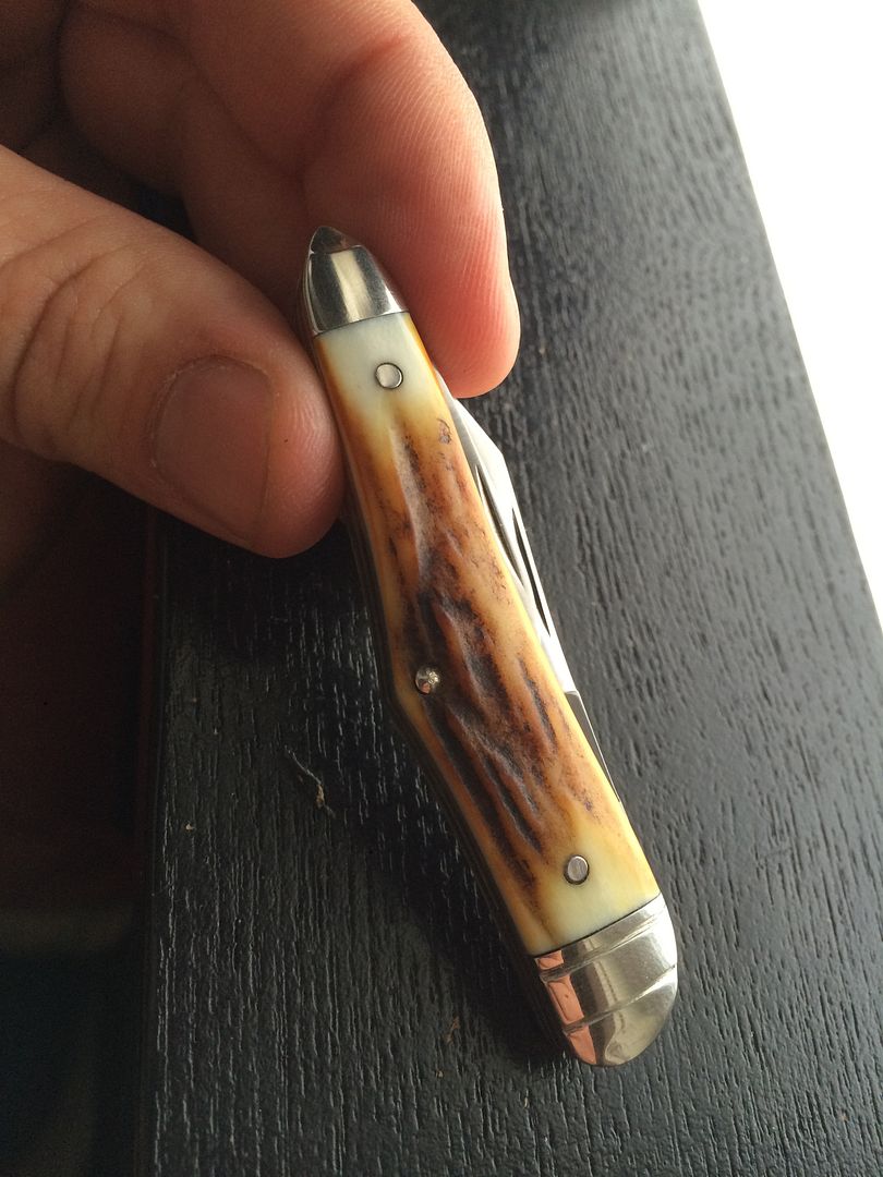

There are gaps in the liner in the coping blade side, as I can see the crud still stuck in there!! Much of the character/colour in the pen side stag scale was rebuffed off, as was some in the coping side scale. Not too happy with loss of Colour and gnarly pattern. Especially when I commented I was picky about stag and asked for notice if it was to be changed. I can understand some change, but the amount and the fact so many other things are wrong sadden me. This is a great knife in principle!

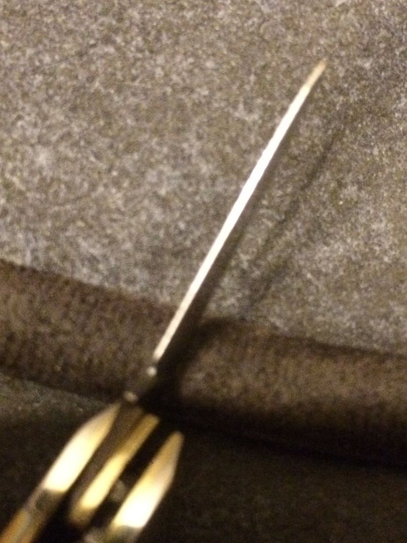

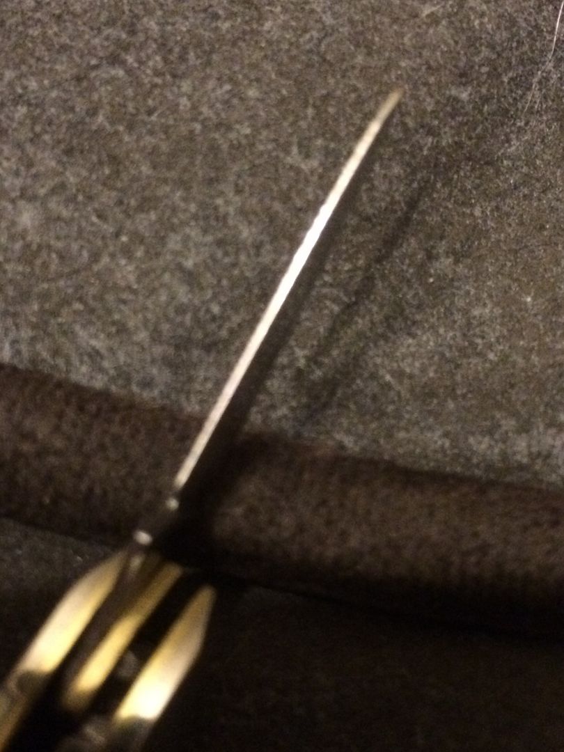

Best before and after I can find
(Pen side)
Pen side after
(Coping side)
Coping side After:

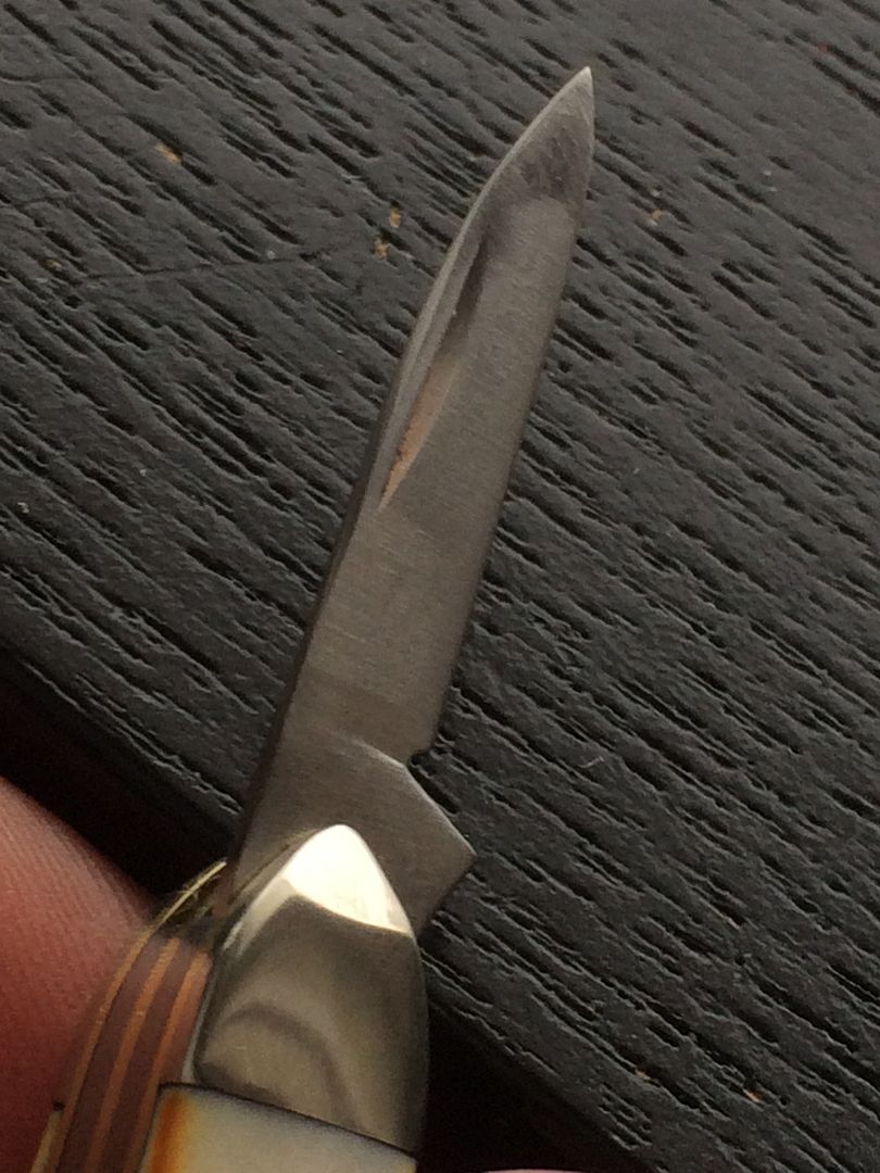

On its own, some loss of figure I guess is to be expected around the bolsters, but loss of character in the Center of the scale combined with the other issues in this knife is quite unfortunate. To me looks more like most Case Stag, that I tend to dislike. The pen blade has almost no swedging left, and there are three distinct different areas of "finish" on this blade as well- 1/2" scratches next to choil perpendicular to edge, the regular blade finish, and the last 1/2 inch of the tip is buffed out.

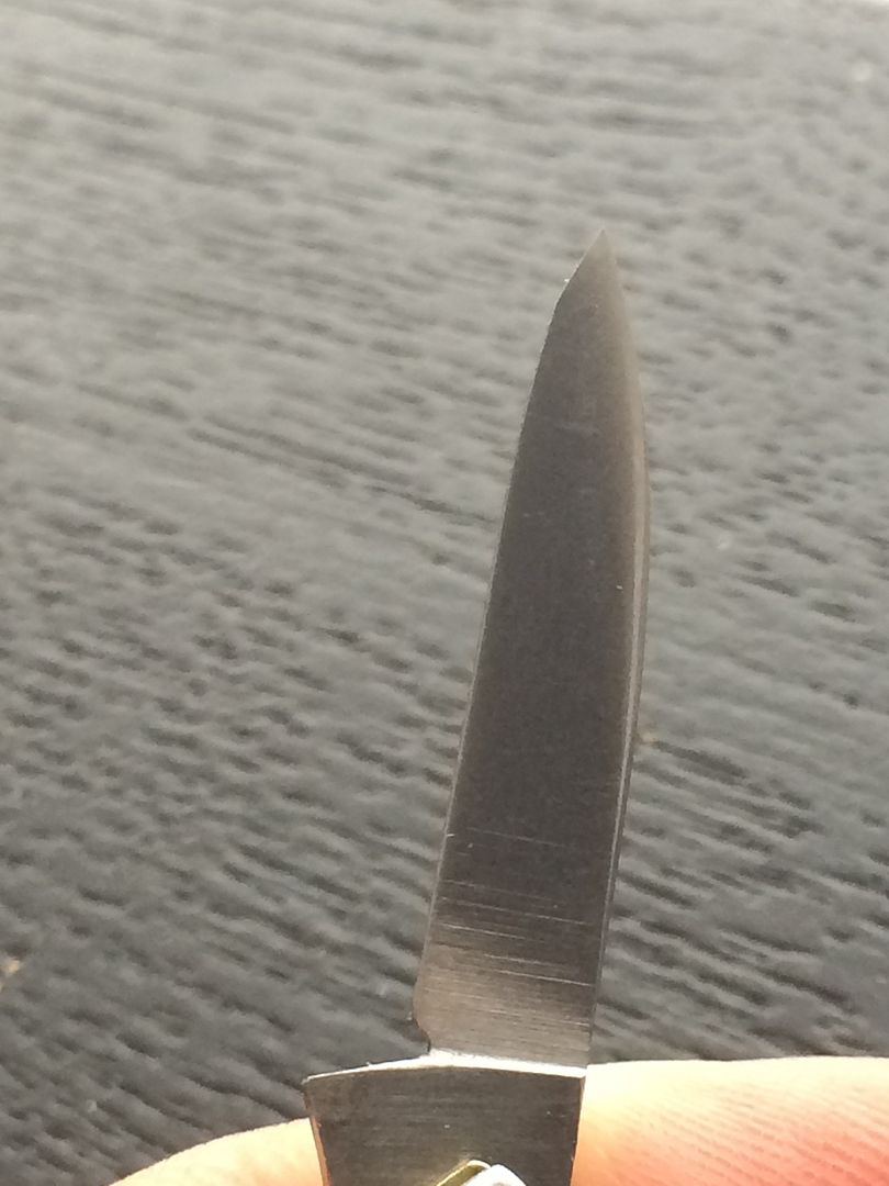

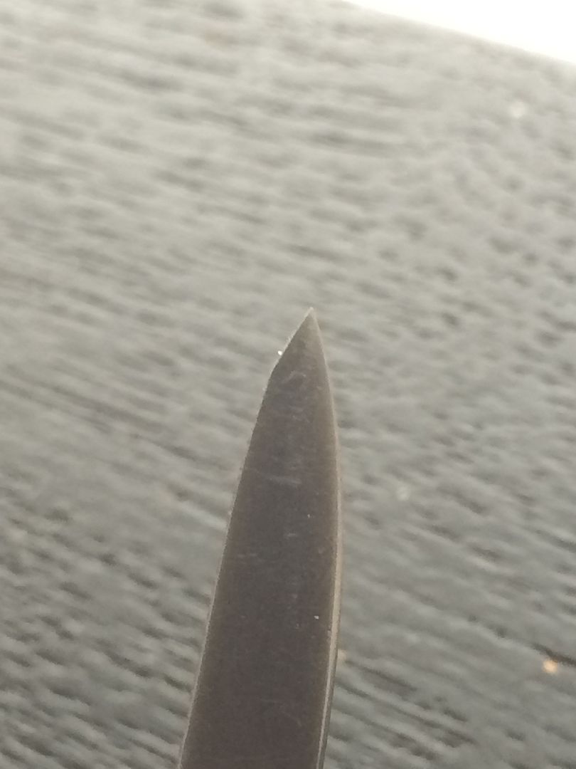

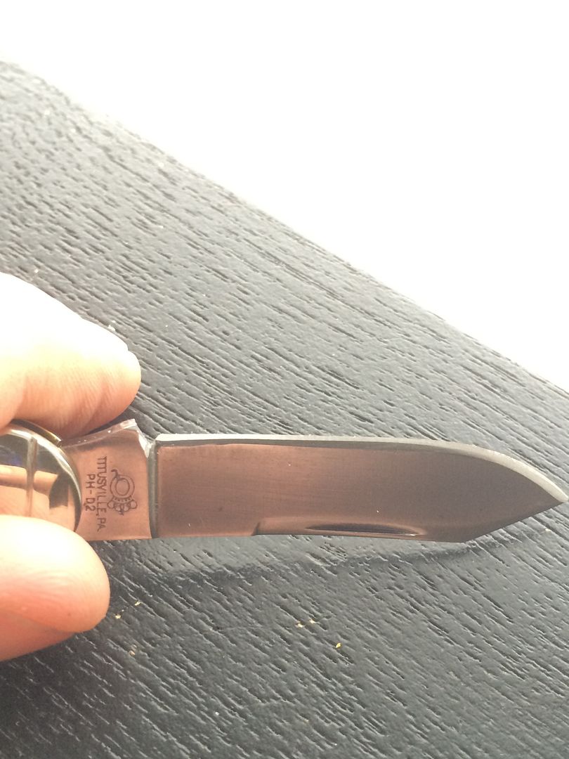

This blade has no edge remember- and also has a Tanto tip!! That's right!! Instead of belly, the final 1/8" of the blade is totally straight!!
("Edge" is to the left, spine right)
Curved coping blade and straight tipped pen blade!! If you can call a blank a blade that is! Hope it's heat treated at least. The pen blade has a choil, the coping does not....
