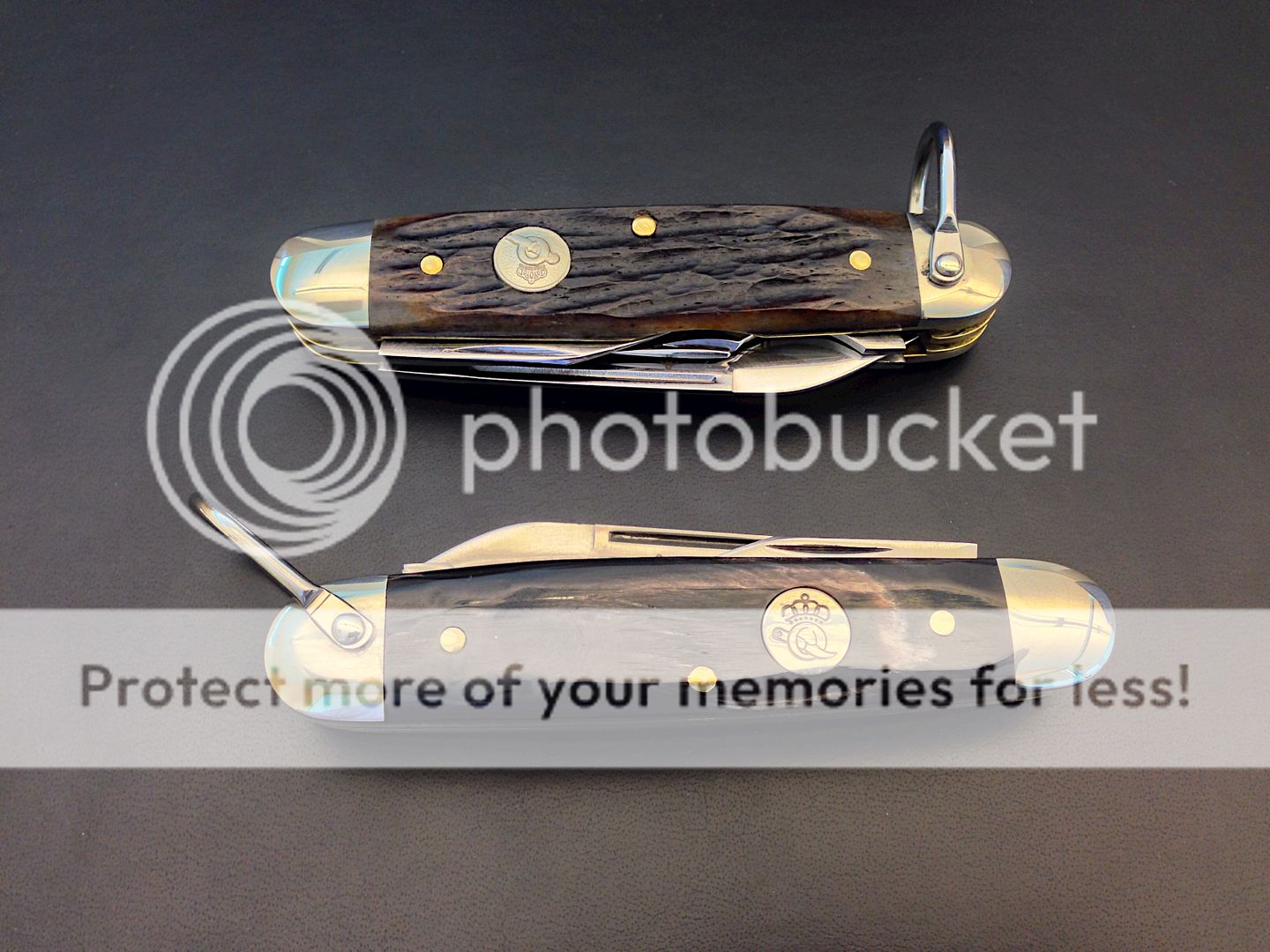

Some quick pics of mine:
All tools open with a bit of grittiness, nothing a little WD40 and some 3-in-1 won't fix. No gaps, blades came paper slicing sharp with decent grinds. No snap on closing the buffalo horn can opener, the stag is fine though. Not happy about the burn or tool mark on the awl on the buffalo horn, but I don't think it will be difficult to correct. Overall I would rate them as very good, serviceable out of the box, and aesthetically very pleasing. Not home runs, but maybe triples :).

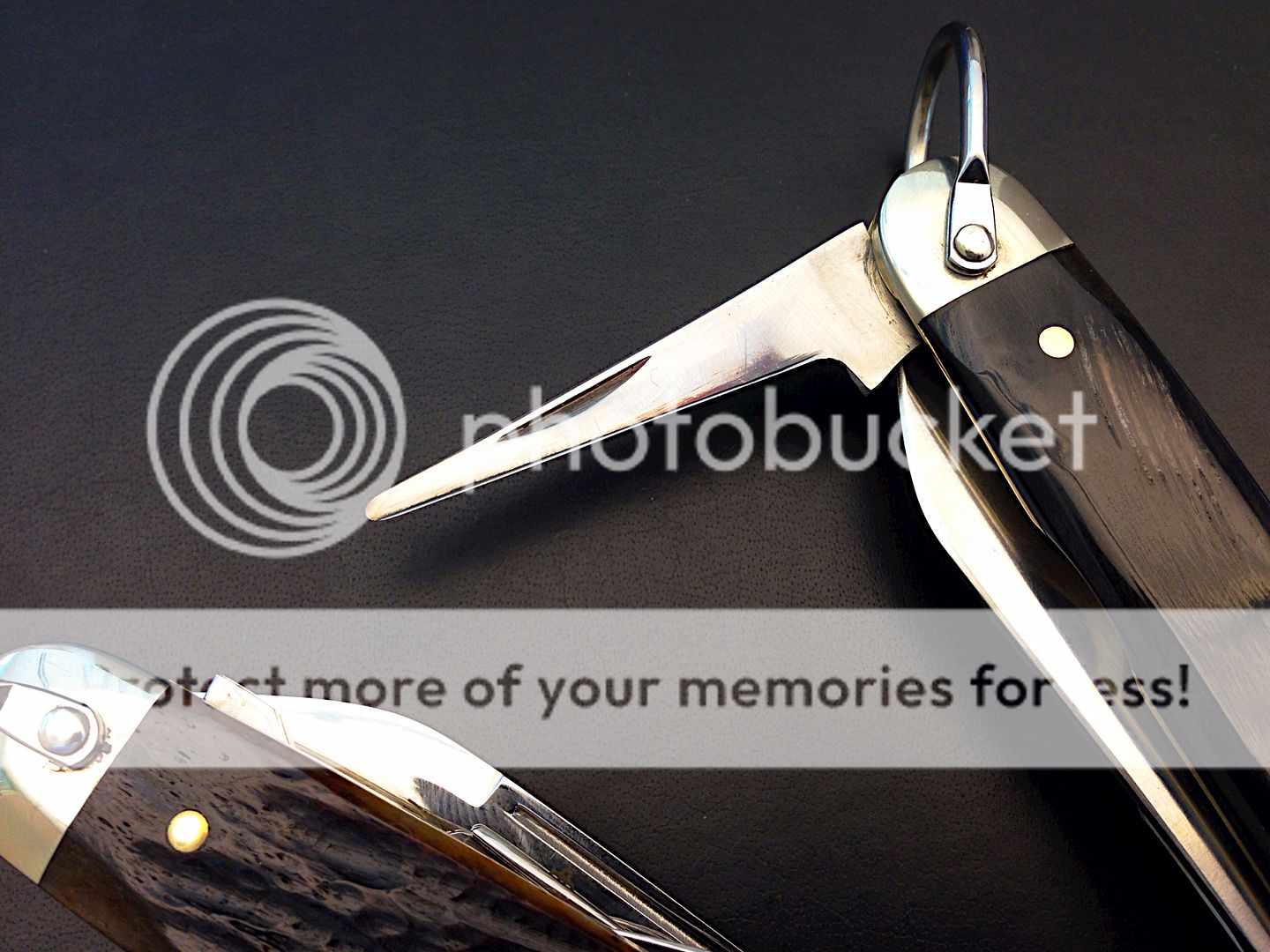

Mine arrived today and the main blade is less offset and more bent than I was expecting. Is this normal or did I get a funky one and should see if I can exchange?
The tip of the main blade rubs the can opener and the awl rubs the main blade on the other side by the base. It's like the two smaller "blades" were aimed at the main blade instead of deferring to it.
And the main blade has a curve in the metal and gouge just in front of the kick that must be where the bender gripped and bent it. If it's normal, I'll chalk it up to learning the hard way about Queen's scout knives.:confused:
Curve and gouge (smudge at tip is where the blade hits the base of can opener):
So glad they gave the screwdriver all that room by pushing the can opener and main blade together.;)
I'm gonna call in the morning unless you guys tell me they're all like that.
Looks like any less of a crink and it is going to hang on the blade it shares a backspring with. Looks like a snug fit to me. Maybe the should have crinked the sibling blade a bit toward the liner, so they could crink the main a little less - but not seeing a good solution without a fairly aggressive angle. Someone else have similar angle pictures for the OP?
It's an interesting design: there's ton of unused room outboard towards the covers. And while the awl tip makes a little contact with the blade near the blade base, the bend makes the blade's tip swing all the way over to hit the can opener base. If they'd just left it straight, it wouldn't have rubbed the awl much more, wouldn't have touched the can opener ... and it wouldn't have been bent (which is my primary gripe).
That's a 2002ish Queen Whittler in the pics, and it seems to have been both engineered and finished very differently.
When you say "bent", do you mean "crinked"? I have many scout patterns. I don't think that I've ever noticed an American made scout without a crinked blade. In fact, the only scout that I can think of, that may not have a crinked main blade is a Wenger Standard Issue.
Four blades is a lot to pack into one knife. The awl rubbing the main blade is very common. The main blade rubbing on the can opener does happen, but certainly shows a lack of proper fit. I have Westerns where the main blade literally slides into the can opener slot when the can opener is opened. I have to push the main blade out if the way in order to close the can opener.
I have a Schatt & Morgan Scout with that very same flaw. The main blade almost acts as a "liner lock" for the can opener.
