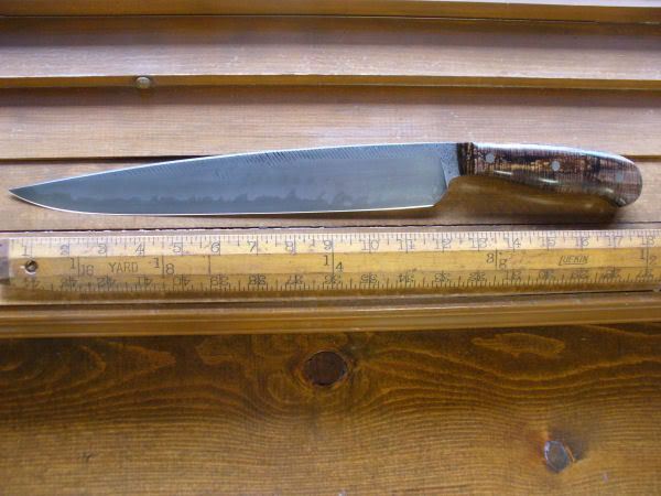

Known steel is critically important in my purchase decisions. The exception would require some serious historic significance. For me examples are WTC steel, a hunk of the Titanic, a piece of Capt Eddie Rickenbacker's Spad XIII biplane...
Of the 50 plus knives in our combined collection (the wifey and me), one is made from a file. In that case I "bought the maker" because I think he's cool and I wanted something he created. For those I saw at Blade, yep, it's the Roger "Mudbone" Jones knife I was wearing.
And if Don made a knife from an old file...hell yeah I'd buy it so I'd have something to razz him about whenever we talked :D

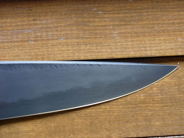

That's one of the reasons this one came home with me from the St. Louis show in '08, Rob. ;) :D
Others being it's wickedly sharp and very cool. Not something I would make a habit of collecting, and not something Don plans to make very often.
So, I feel the steel is critical in every purchase I make, but that won't stop me from an occasional frill. I am a detail person, and the steel of a purchase is always going to make or break a deal. After seeing this blue collar file bowie of Don's cut cigarette paper easier than any other fixed blade or folder on his table that day, and Don being comfortable with the way the steel forged, I was sold.
According to Don, this file steel could be W1 or W2 as it is high carbon, low alloy, fine-grained, was triple quenched, and sharpened down to a very fine edge. This begs to be tested, but has not been used to date.
Not my normal purchase, but not to say it won't happen again.
