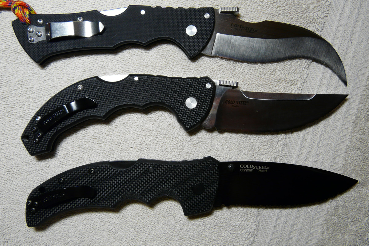

May have found the reason for gritty action E EatingSarma
Popped mine open today figuring it would be broken in enough that I'd take a loaded felt wheel to polish up all the contact points and get it loctited back together, and it'd been good to go.
Well, I couldn't see them looking in that there are actually Teflon washers in there. Being a CS I should've expected I guess, but I really couldn't see them. One side had a Teflon washer and two paper thin pb washers, while the other side only had the Teflon and a single pb. The pb ones are crazy thin, dished, scratched, and you can see they got pinched by the pivot being put together. The Teflon aren't in much better shape; one the center had totally ripped off, and it's outer edge had partially frayed. Overall...not very pretty. The one good thing I'll say is it's nice they use a wide radius washer so the blade rides on more material.
I replaced them with the spares I put in all my CSes (dimensions in one of the pics). Feels a million times better even not broken in, but to be fair I also cleaned it so who knows.
Washers it came with, how they look first opening (and by the way I had to break the loctited to open it, so it was exactly at factory tightness):
Another where you can see the piece of Teflon washer that separated and stayed on the pivot:
With the replacements, only need one per side (and the missing Teflon washer center taken off the pivot):
Curiously only one of three clip screws had loctite. It was the lowest, so maybe there's a reason:
Shot of the inside of the handles, for reference:
Another thing, it wasn't the stop pin rattling. That is stepped and doesn't have a separate collar as I thought. Both pins were stuck in there pretty tight so it must not have been those rattling. I'm guessing it's one of the other smaller body pins. Lazily I just threw grease on the ends of everything, and it seems okay.

three folks here have reported on them so far that I remember. all three were gritty. think TheFactor TheFactor took his apart and cleaned. maybe polished washers and he lubed it, solved it. ill let him tell it properly. as im going by memory.
I just oiled mine..still tad gritty, but I didn't care enough to take apart and work on it. you solved yours replacing washers.
the Taiwan made ones just seem better overall, so far anyways.
