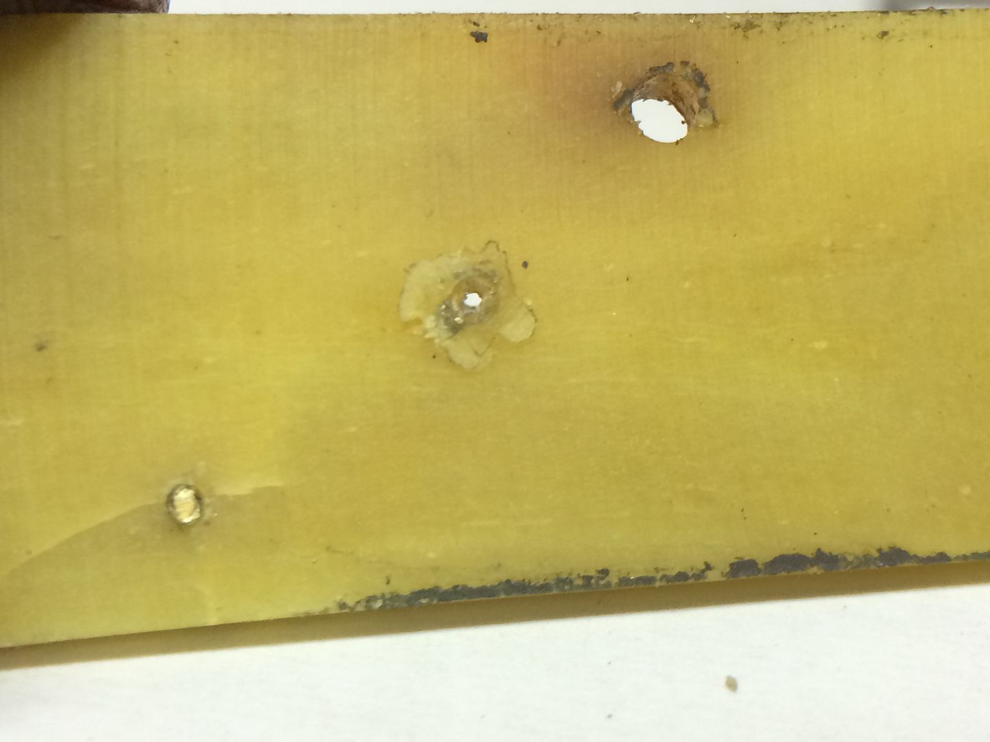

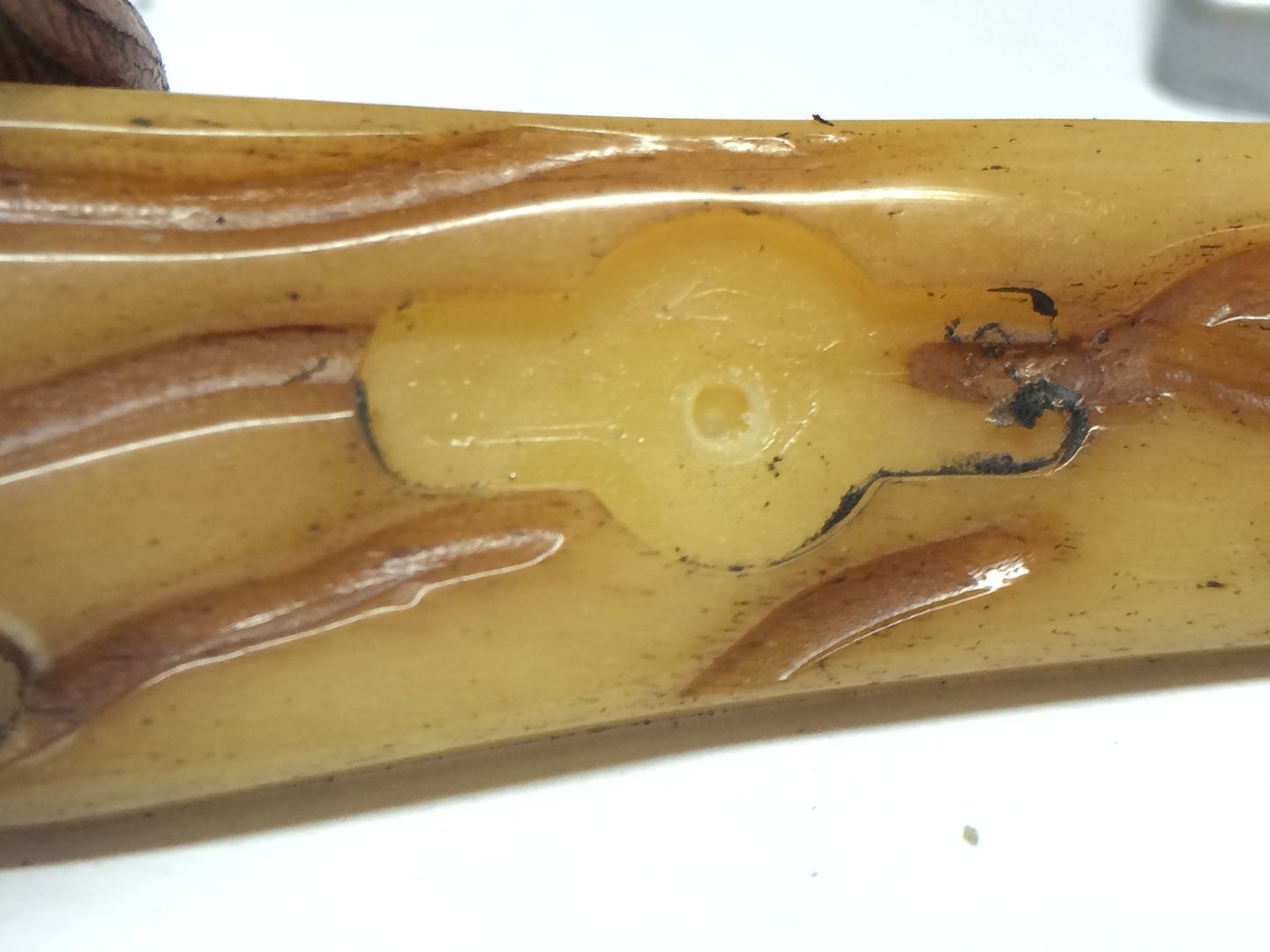

As I mentioned before, I suspected that the pins were threaded to provide more adhesion when glue is used. In this pic we can clearly see the glue residue:

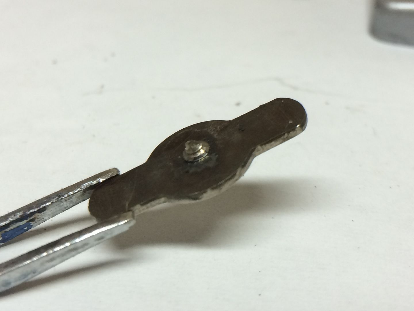

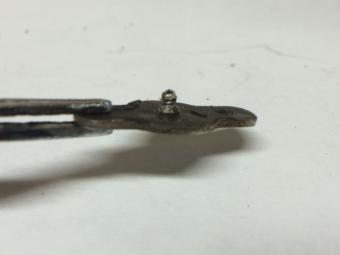

After using a little CA solvent and a fine pick, I was able to expose the threads on the pin. Note that the pin is not pinned through the shield, but rather soldered or welded to the back.

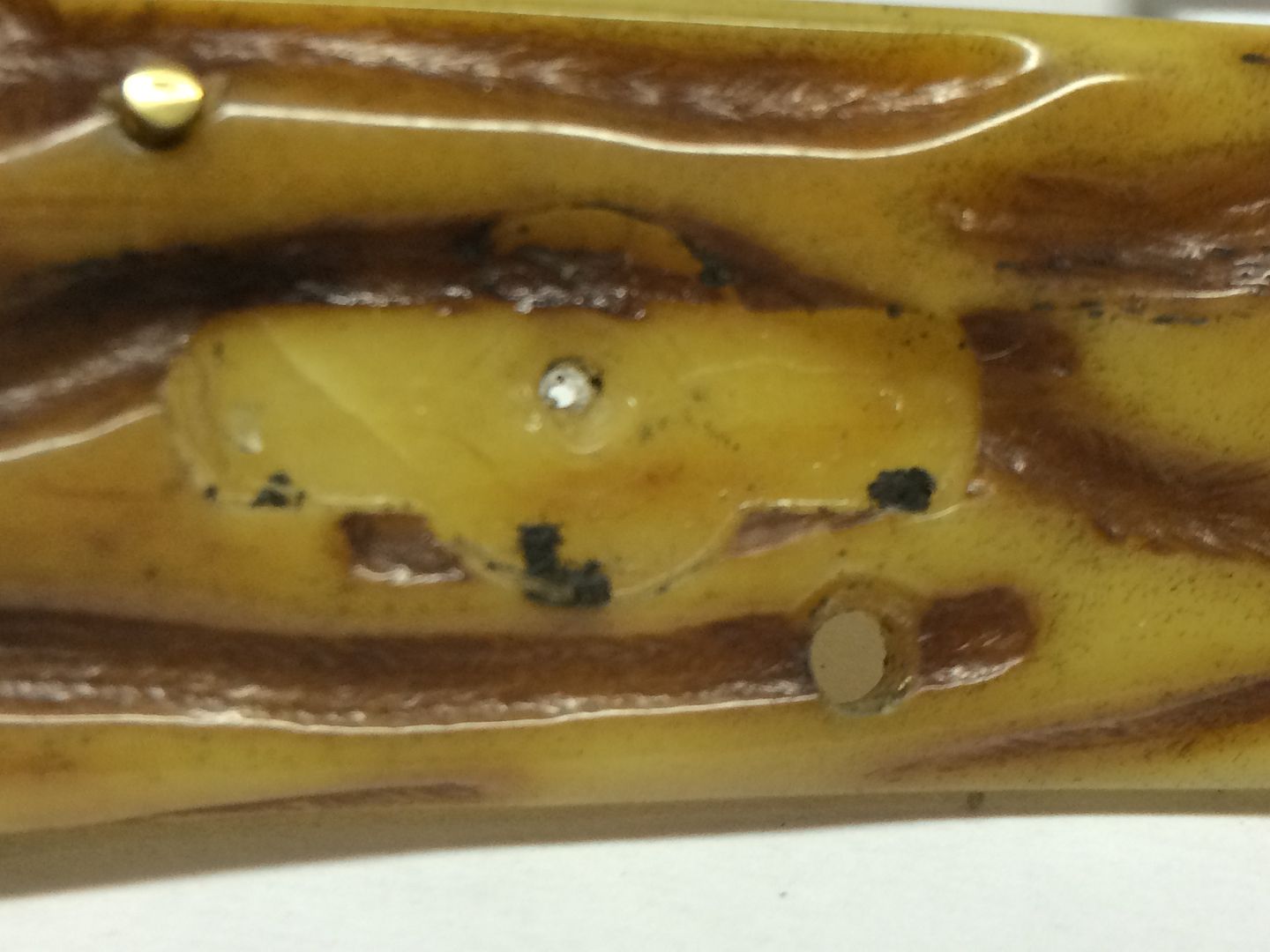

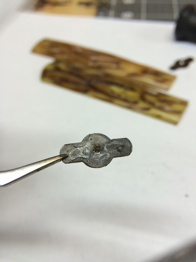

Here is the shield off of the other S&M I disassembled. Notice how short the pins are? They are not pinned to the liners, but held in place with some glue. This pin is significantly shorter than the other one, but had a hole drilled completely through the bone scale, as if it should go all the way through, but no hole in the liner.
Scale from the shorter pin shield:

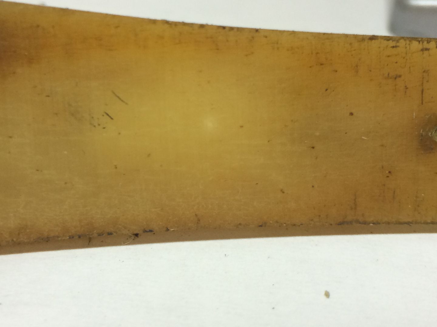

And the scale from the first shield where the threading is visible. The hole wasn't drilled all the way through on this one...
As I previously suspected, I believe that the pin hole was drilled too deep and then the pin was not snipped on the inside, leaving an overhanging pin that was then mashed down by the blade, pushing it down to the backspring.
Unfortunately we will never be able to confirm this 100%, but I am 99.9% sure that this is what happened. Zee proof is in zee pudding...
Monsieur Evan Poirot is very convincing. :D
(Although the bit about the blade mashing down the unsnipped pin seems a little unlikely. Could someone have seen it sticking through, tried to shear it off with a little chisel or whatever - but failed to cut it off cleanly - and then not inspected their work to make sure it was gone? That last part doesn't seem likely either :confused:)
- GT
How the pin was bent is the only thing I am not sure about (besides how it passed QC...). I think that during assembly the pin was bent by the other scale then either pushed the remainder of the way down by the blade, or some other object, perhaps a chisel? Thin brass rods are quite soft, and the threads cause weak points in the pin making it easier to bend. OP did mention that there is a mark on the blade from where it contacts the brass, so this is feasible. As far as the liners on the S&M's I took apart, there are no holes for the shields... I'd take pics, but the knife is already back together...
