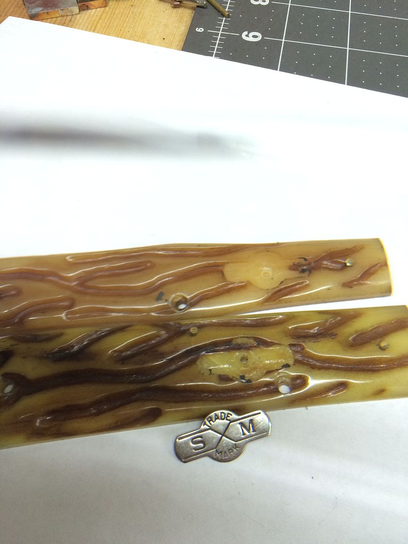

Old, thinly-ground kitchen knife, Wally-world hammer, 11/16" chunk of flat steel, and an advertising folder made up of a few layers of card paper, to keep from scratching up the knife. Leather works good too.
A bad picture of the knife's innards! Through a magnifying glass!
Layed the paper over the steel plate, and aligned the kitchen blade along the pile liner, and alongside the Queen blade tang. The minimal gap that keeps the blade free is a good place to start. Fingers clear, a couple of good raps with the hammer drives the blade right through the pivot pin!!
Move the blade back a little, stand everything up again, and rap the Kitchen blade through the other pins!
Phase Two:
The knife falls neatly in half! The errant pin only went through one liner, the one behind the shield, as many suspected.
Close-up clearly shows what is going on - ugh!
I think the blade has banged the pin over - it hits pretty hard!! Good thing that pin is soft brass. Hardly damaged the blade at all!
Edge view of the Mark side!
Here's what was going on! Scary!!
This production brought to you by "The Not Geraldo" corporation, and the "Glasses for Mike" fund. All donations can be sent to Oklahoma Optical with appropriate notation. No knives were (seriously) injured in the making of this WIP. No Prototype knives changed hands!!! Esnyx has volunteered to re-assemble this knife (Yay!!).

Vat can I say... Zee proof is in zee pudding!
Thanks for the pics, Charlie! Send 'er down south to get rusty!
So the mystery is solved, once and for all! Nice job, Charlie! :thumbup::thumbup:
Thanks to everyone who contributed to this entertaining and informative thread, especially to Luger1952 who had to sacrifice a knife to scientific progress.:p

Great photos Geraldo...err...Charlie. :cool: I think the QC department solved the problem of the blade not closing by hammering the "obstruction" out of the way before packaging.

I chatted with Bill at GEC about this knife. He tried a few knives with the threaded pin, but quickly gave it up as too imprecise. The idea was to press the pin through a tight hole which would grip the liner, helped by a spot of glue.
Peening a smooth pin is the only way, tried and true!
The one big improvement that Bill has succeeded with is using the shield welded on as the pin cap. You can have words stamped on the shield without messing them up!!
