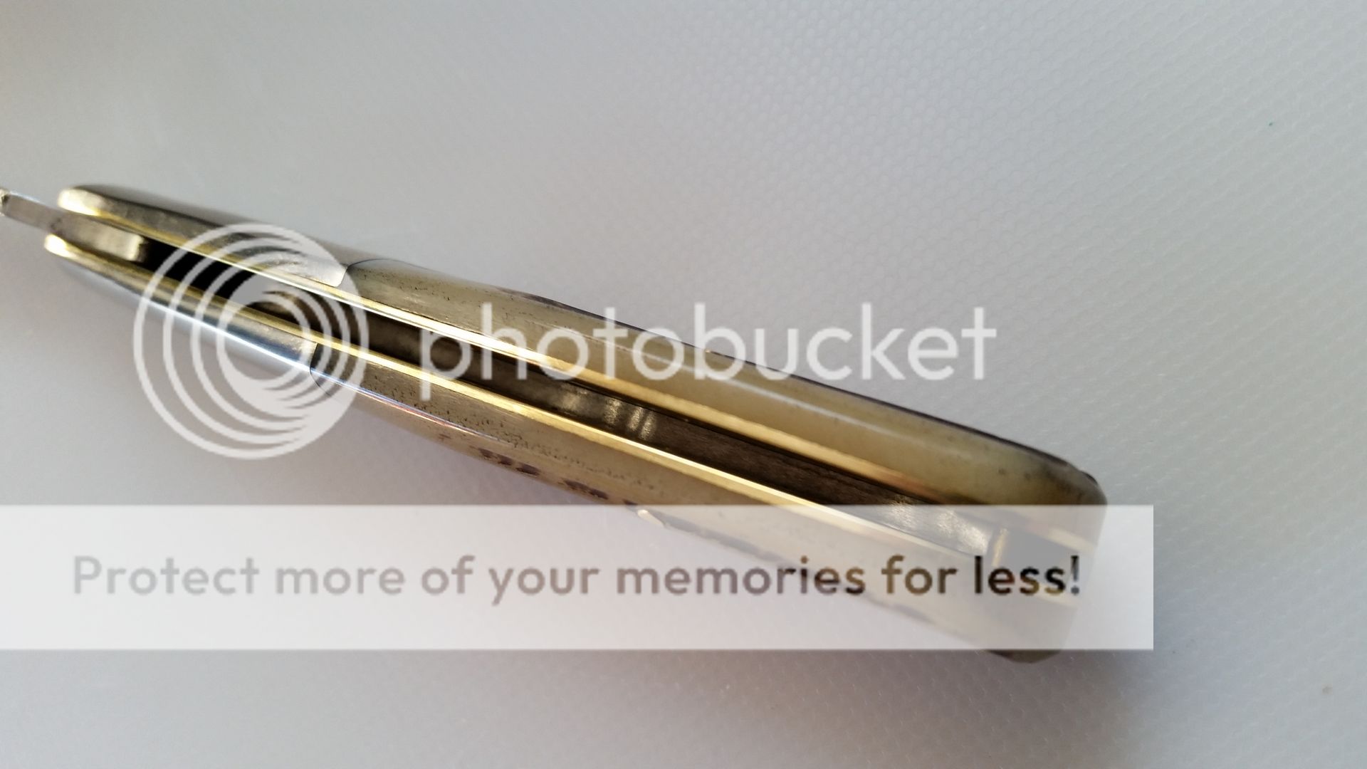

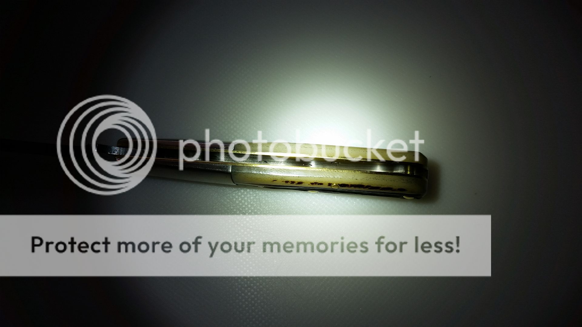

Same model of knife:

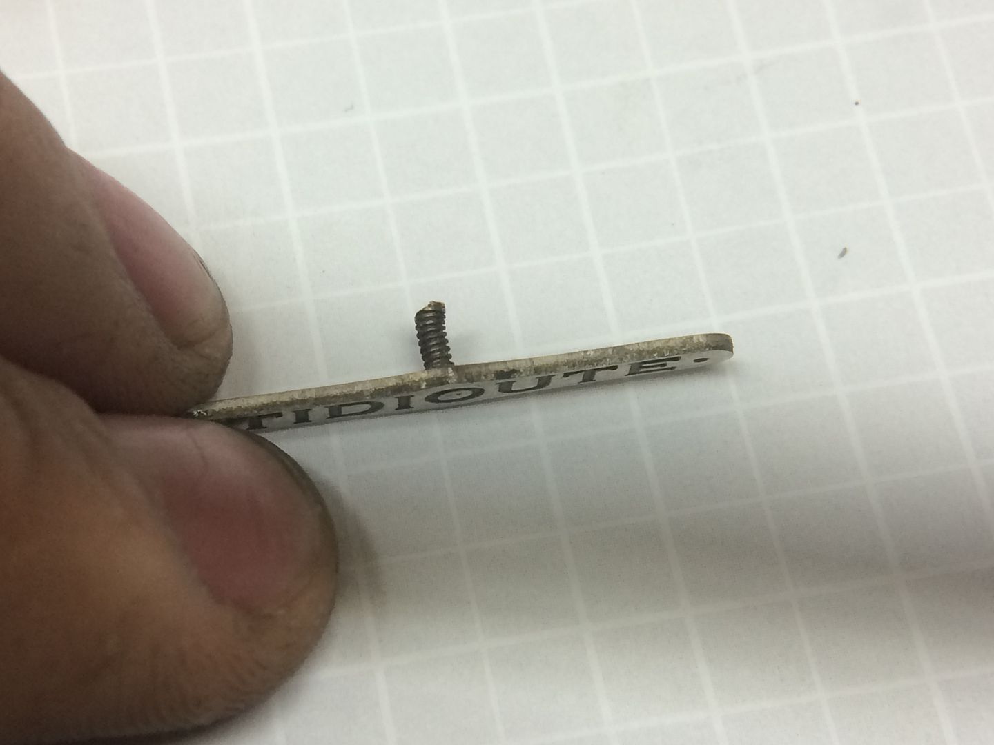

It's hard to see, but in the second photo it does show that the liner is pierced for the shield pin, and the hole is rather close to the hump in the backspring. I'm sold on the theory that the item in the original photo is the untrimmed shield pin.
Definitely confirms my suspicions of it being the threaded pin holding the shield in place.
Here is my proof:
This picture bothered me a little as I have paid fairly close attention to the shields on GEC knives. Confirmed with the factory that they only used this method the first year or so. For the last many years they have used shields w/pins that look, for the most part, like the hat pins that come with Genuine Stag models.
Did they mention why they used the threaded pins? That shield was definitely pinned to the liner and had no glue on it...
I don't think it was pinned per se; I think the threads were used to essentially "press" and bite into the liner causing a good bond. But it was improved upon later, so it may not have had optimal results.

I received the knife back today and it is going off to Charlie. He and Mike will have to duke it out over the source. For my .02 worth, it is the pin on the back of the shield.
Wow. yeah after having looked at the OP's pic a bunch of times and hearing the sworn testimony of the OP it looks like its a shield pin. It just boggles the mind that they would put a liner on the knife that had a long threaded pin coming out its backside. My theory for how this happened is the original shield came loose during assembly and fell out and so they decided to put a new one in after assembly. This would explain why the pin wouldn't be filed flush. It looks like the bent pin was filed and bent down but not cut off?
