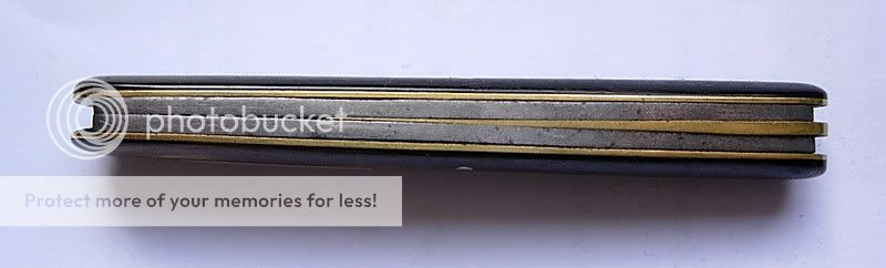

Wow waynorth that is a very interesting knife. Can you add another picture showing the split/wedge backspring, please.

Hi Sunnyd. You're very welcome. The whittler was/is one of the most difficult patterns to get right. Much more difficult from an engineering perpsective than other three blade knives e.g. stockman. The master blade lies across both springs for extra support. The two smaller blades at the other end need to be separated in order to allow the master to open, close and lie between them without any rub.
For clarity, my spring shot is oriented wrong-way around. The thick end of the wedge is at the two-blade end. Where the springs come together is the Master blade end.
Further to s-k's comments, several whittlers skip the wedge, and space the blades with a small piece of brass. Much less elegant, and the blades are narrower than the springs. Here are two examples, a Buck Creek at top from Germany, and a Queen below, of course from Titusville.
One interesting detail is the springs are ground with a taper! Slightly thinner at the master end. I have seen much more extreme tapers, and a "kink" in the master end to bring the ends of the spring parallel. I'll have to hunt for that one; I know I've got one somewhere!
