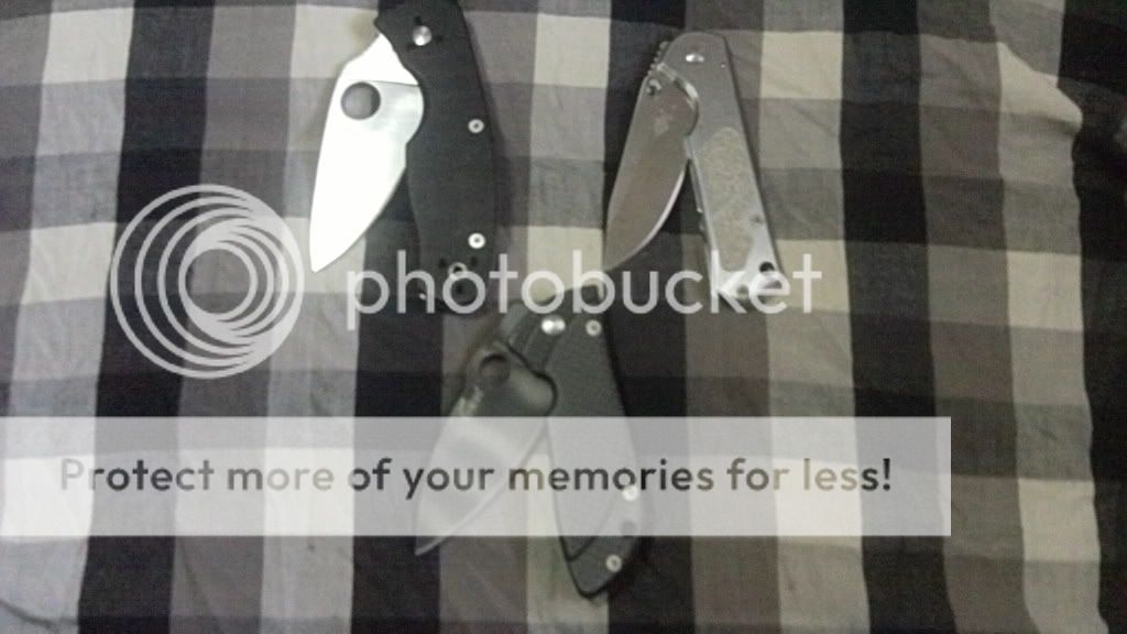

Update:
Slightly off topic, but still related to SRM/Enlan/Navy
Finally decided to get Spyderco Resilience for the need of a larger blade. It arrived yesterday.
Initial impression: fit and finish is 95%. The 5% are because blade being slightly off centered when closed, and some wavy lines in the edge.
If centered = 50%, this blade is slightly to the left, at 25%. No rubbing of liner.
Edge grind: I can see some light wavy lines along the edge grind. However, being meant as work knife, no issue. The regular sharpening will correct it.
Having said that, SRM/Enlan/Navy are usually also 95-99% in perfection scale.
Deployment is smooth enough, although the drag due to factory heavy oil (as usually it is when SRM/Enlan/Navy arrived out of box) is there. Flip open nicely with thumb flick. After washing it several times with water and soap, the drag is gone, it smoothed out more, and the centering moves to about 35% (more centered now).
Excluding shipping, it's 40$. If people ask does it worth the extra $ against SRM/Enlan/Navy, I'd say yes. Looking at the whole knife as a design, there're lots of thoughts being put into. Here are why:
Liners are skeletonized, and the lockbar is not. Compare this with EL01 where the skeletonizing also includes the lockbar.
Ergonomics is excellent. I have small to medium hand, and it still feel comfortable albeit massive. No sharp corners. The similar designed Navy has sharp edges along the liner.
Edge is sharp, sharpest among all the knives I get out of the box (SRM/Navy/Enlan).
The G10 is smoother than Navy k631 and EL01 and even smoother than SRM 763 (763 has different texturing).
Lockup is solid and early, a hair of the trailing lock bar not yet flush with the leading blade tang, which means more room to wear. Zero blade play in any direction.
Very even blade grind (referring to the FFG), by visual inspection only. I noticed Navy has some uneven grind only when trying to polish it, there are areas where the stones/sand paper (if put on flat surface) won't reach the 'FFG'.
So, even if one of these companies make the knife for Spyderco, the conclusion is that Spyderco design, thought process and quality control goes into the whole manufacturing process, resulting in better product as a result. Something that when SRM/Enlan/Navy make their own design, is missing.
I am not saying they are bad. They are good, but Spyderco worth the additional $ spent.
If anyone want to try the Navy copy of Tenacious, I'd say go for the real Tenacious. Especially if you live in US, shipping is practically free from many shops. I paid about 25$ in total for shipping for the Resilience.
Did I say that it's lighter than my Navy k631? :p
In fact, the Navy is what inspired me to finally decide on Resilience. The design (handle shape, FFG blade, opening hole) are taken from various Spyderco as said before, and the ergo is really good. So I decided to check out the 'real thing'.
Sorry, no pics yet, will post sometime later, if anyone interested. There are so many already posted, I guess it's nothing new.
Having one and handled one is a totally different animal than SRM/Enlan/Navy.
I am satisfied:thumbup:
Edit to add
Screws: there were complaints that the screws were easily stripped, being hex but sized in metric. Mine comes with T6 torx for all the smaller + clip, and T8 for pivot. Spyderco does listen to feedback :).
