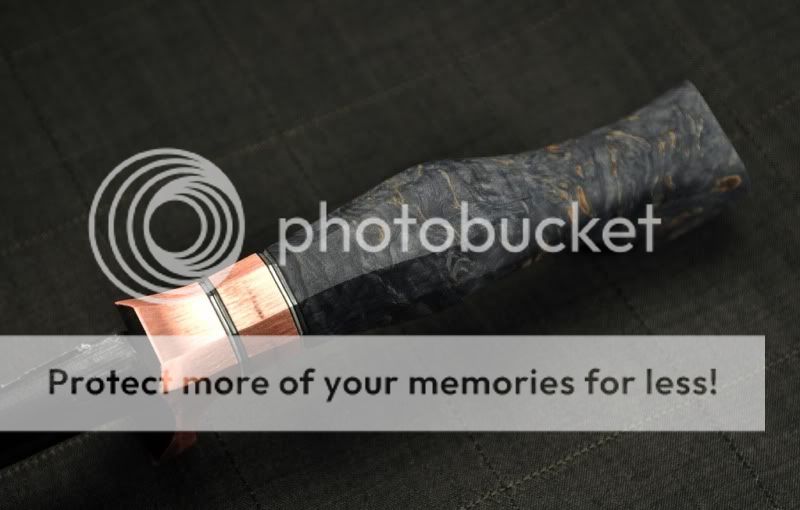

the fittings, starting to take shape;
a little fitment procedure;

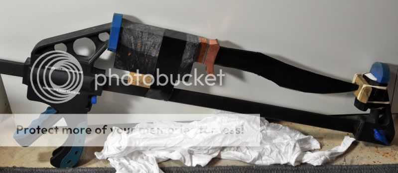

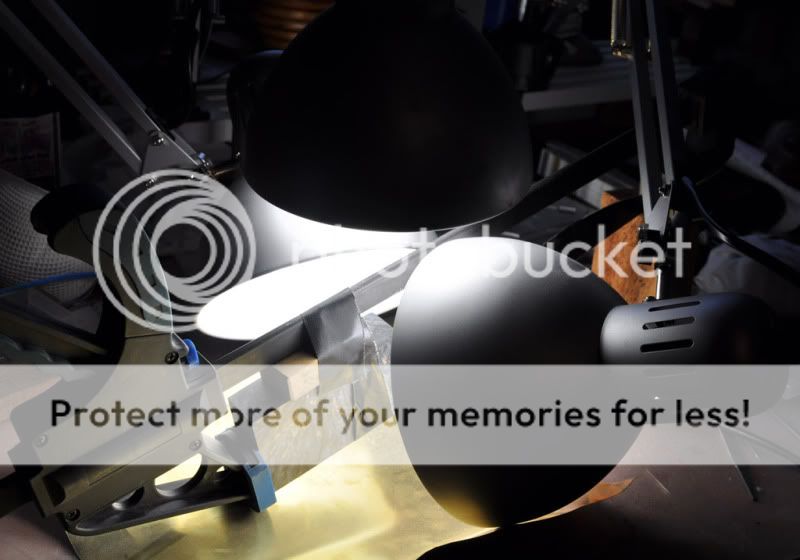

and thence to the gluing!
Tis cold in Sveden, must heat that epoxy up with lights yo!

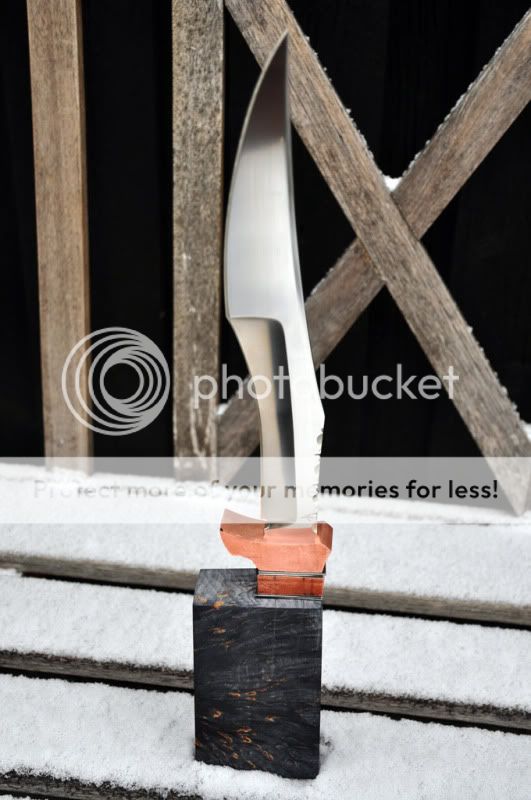

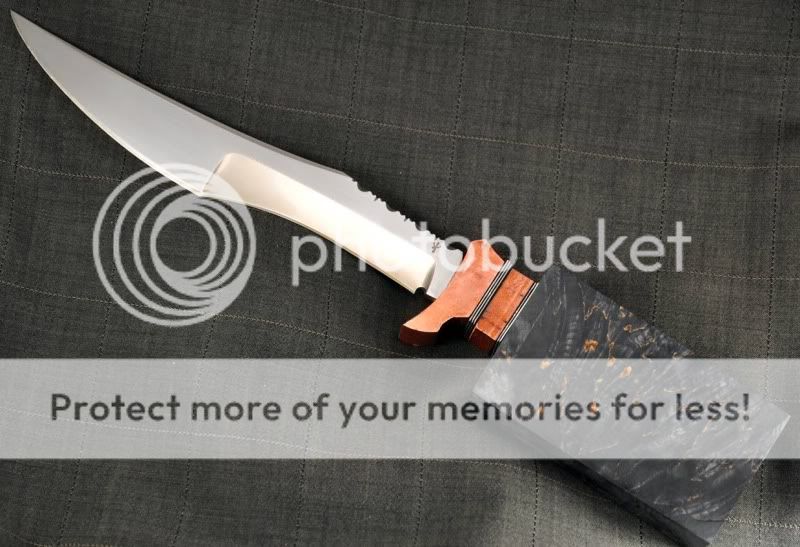

the morning after shot;
finally glued up.

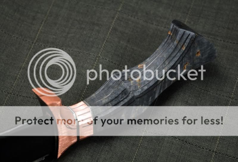

the thin black spacers are separated by thin pewter spacers;

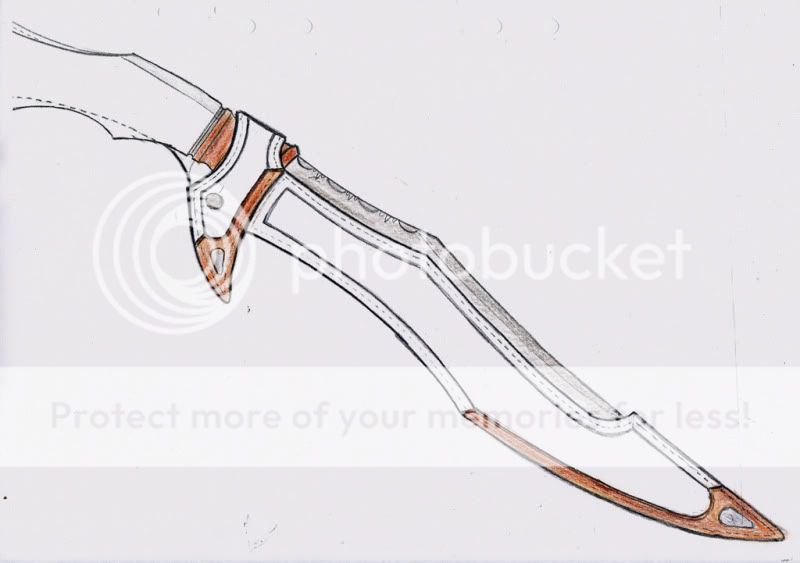

Anyway, since the sheath is getting started now, I thought you might like to get a view toward where Magnus is going with this.
This is the first concept drawing. It bugged Magnus that the guard didn't fit into the sheath...
so he redesigned it. You'll notice in the redesign, that he's chosen to incorporate copper accents.

Kevin, there aren't any metal fasteners within the handle. Just an epoxy 'pin' through the tang, plus the tang was 'barbed' near the end to anchor it in the epoxy.

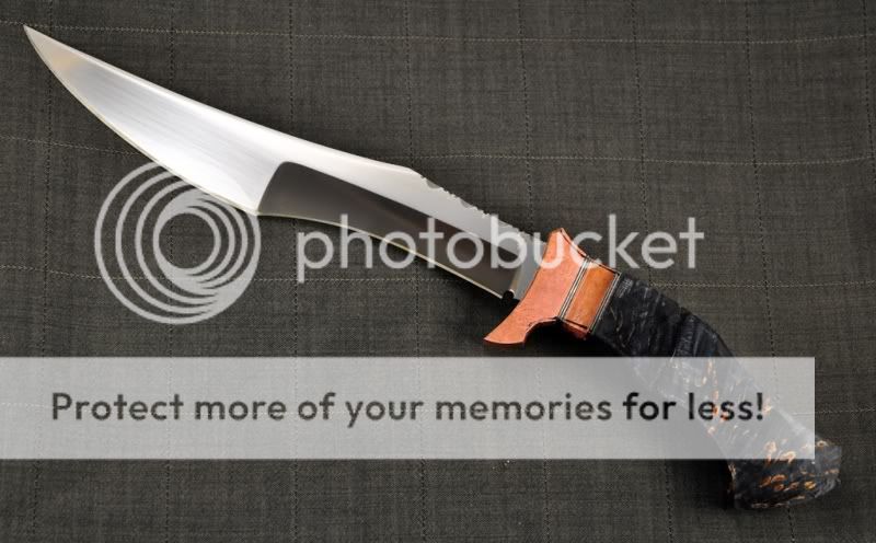

I hope these pictures add to the enjoyment of your weekend:)
Wow, the way the colors in that birch play with the copper! Beyond gorgeous. Love the shape it's all taking on.
