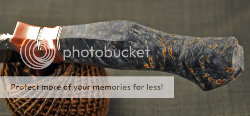

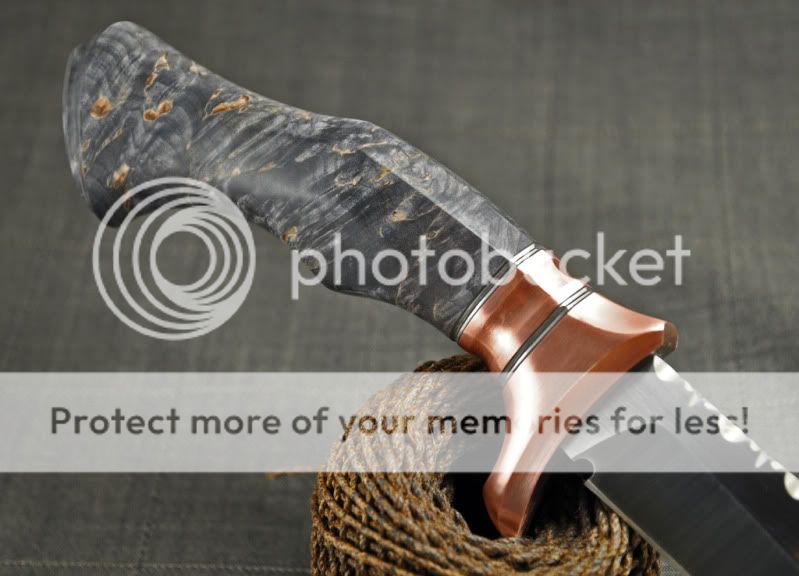

Do you know if he is shaping the handle by hand, sander, files, etc? That looks like it will just melt in your hand!!
While Lorien sleeps I might as well answer that! :)
And the quick answer to that would be all of the above, plus a bandsaw and a drill press!
I begin by bandsawing away excess material and then go to the drillpress to smooth out after the bandsaw.
After that I make the handle octagonal using my sander.
Then to get the final shape I sometimes use files, but almost only with hand held sandpaper.
This is one of my most favored parts of knife making!

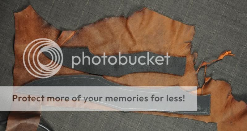

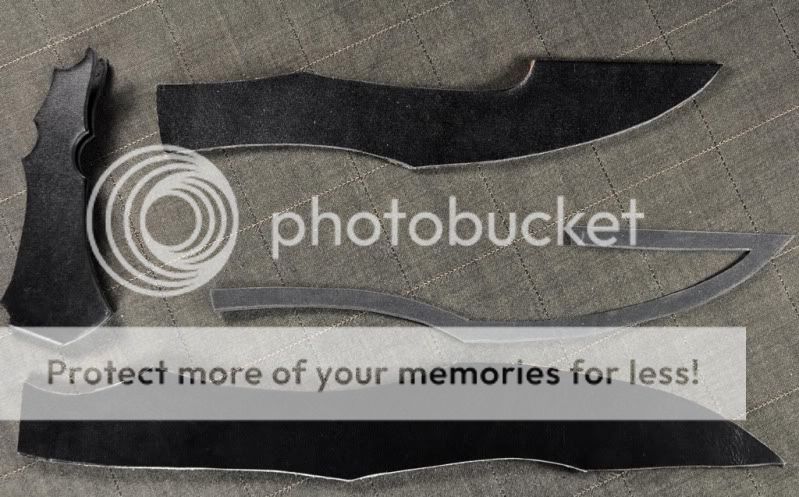

I've been losing sleep a little over the sheath. The sample pictures Magnus sent fill my dreams...

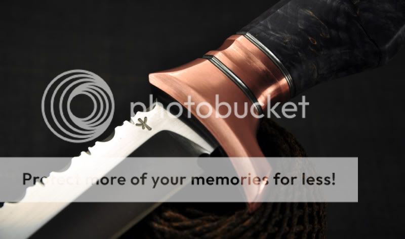

In looking at the original wood selection, I must admit that this piece would not have been my first or even second choice. Seeing it coupled with the knife and the copper fittings, it is clearly and by far the best choice. Shows you how much I know. :o

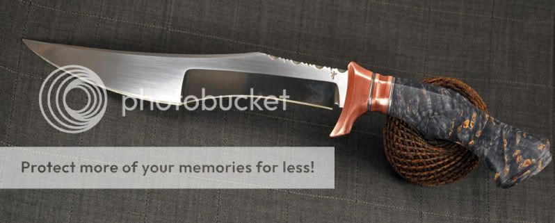

getting there...
DONT USE IT!!! Keep it as your first presentation knife! I like the colors and I think you should keep it shiny and on display!
DROOL!!! That combo is pure sexiness!!! I agree... don't use this one, just fondle and love it, then put it on display for all your friends/family to look at. Ha... :D

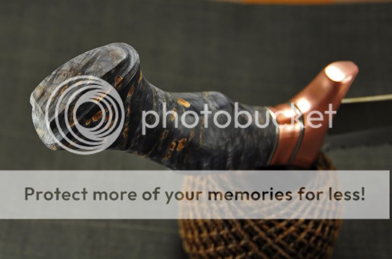

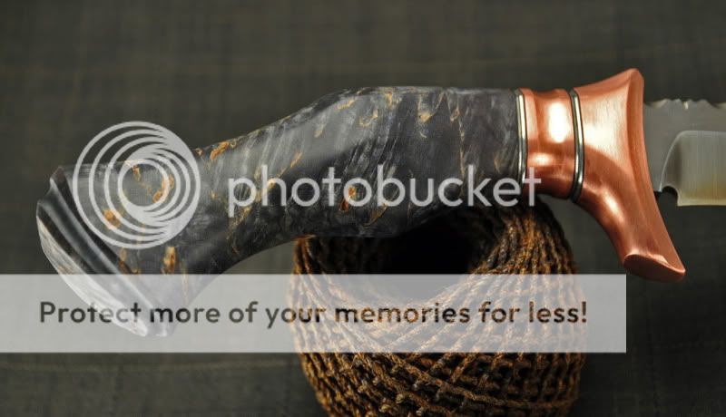

Stormy Weather's handle has been oiled, the next and I believe the last step for the handle is for it to be waxed and buffed. Magnus didn't sound convinced that he was entirely happy with the way the patina turned out but I like it fine. It's up to him to change it if he wants, but it's his call.
Not long now!
It sure is a BEAUTY!
I guess it was decided against a buttcap. That finish on the wood looks impeccable. Can't imagine Magnus would not be happy with that.
