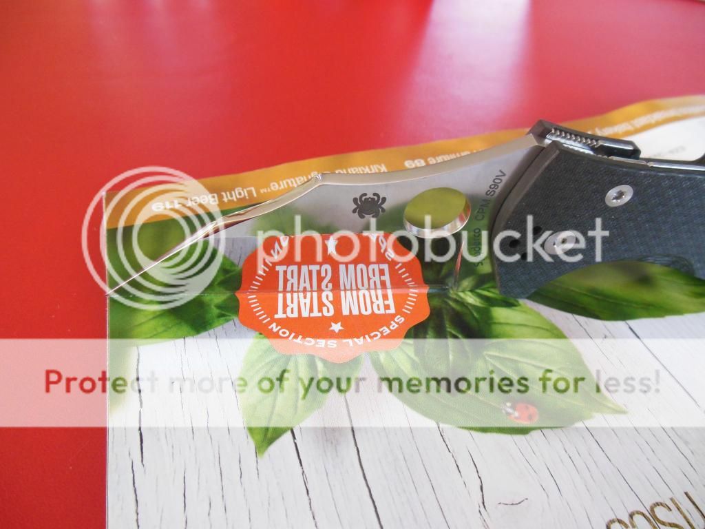

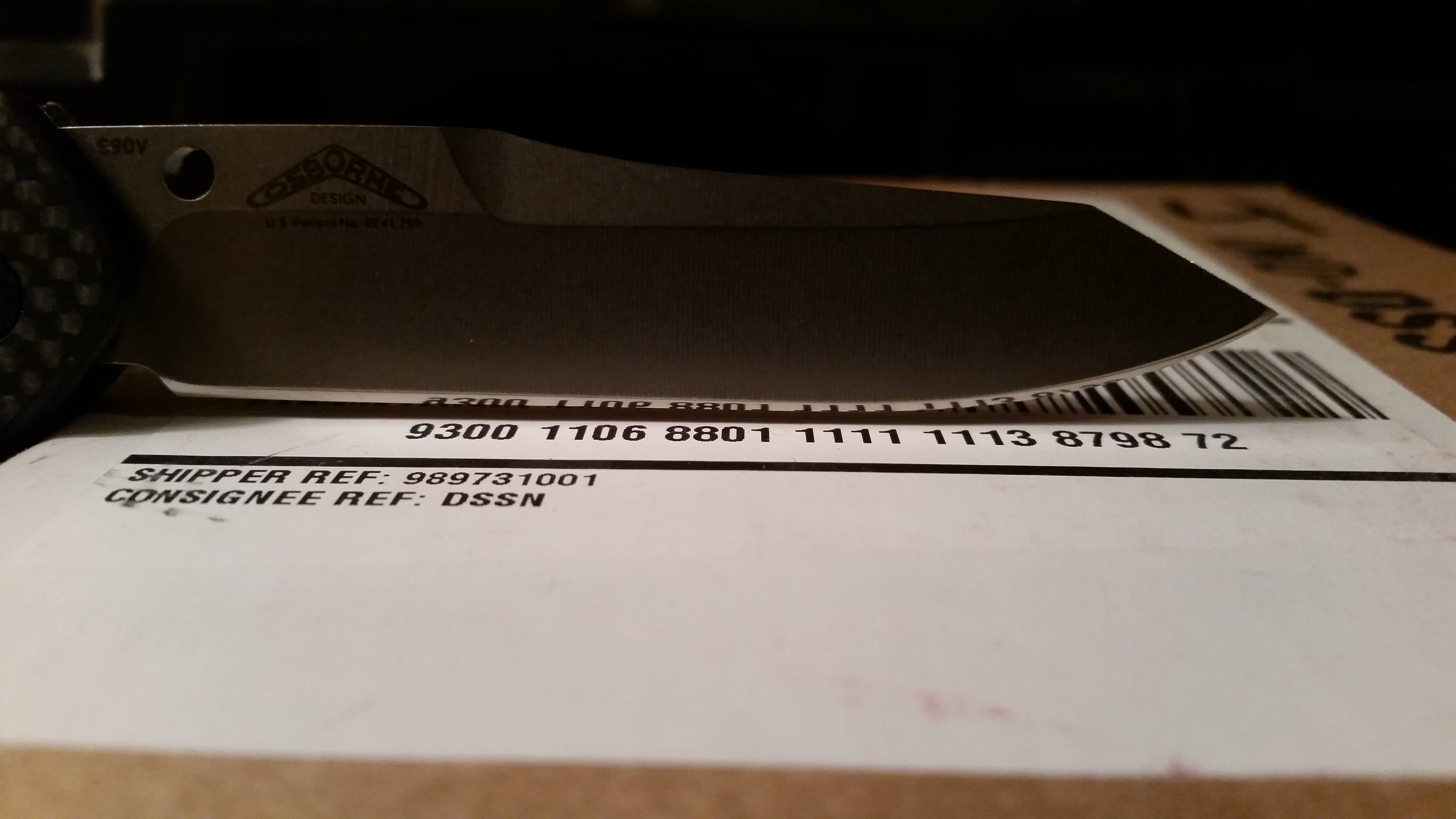

This isn't the most polished edge, but you might wonder why the edge is so high on a hollow ground Spyderco Native?
Well, it's 24° inclusive. I've had this Native for a while, it was pretty worn down and I rarely carried it. So I decided to thin it down to a nice slicey edge.
Because the thickness negates the smooth cutting added by the polish?^ yeah bobby, I imagine that took a while doing a mirrored polish to those large fixed blades!! looks great!
nice! I bet it cuts really well now!! I don't like a mirrored edge much over 15 dps as I feel like performance declines significantly w/ a thick mirrored edge.
I agree on that, but they sure do look nice haha

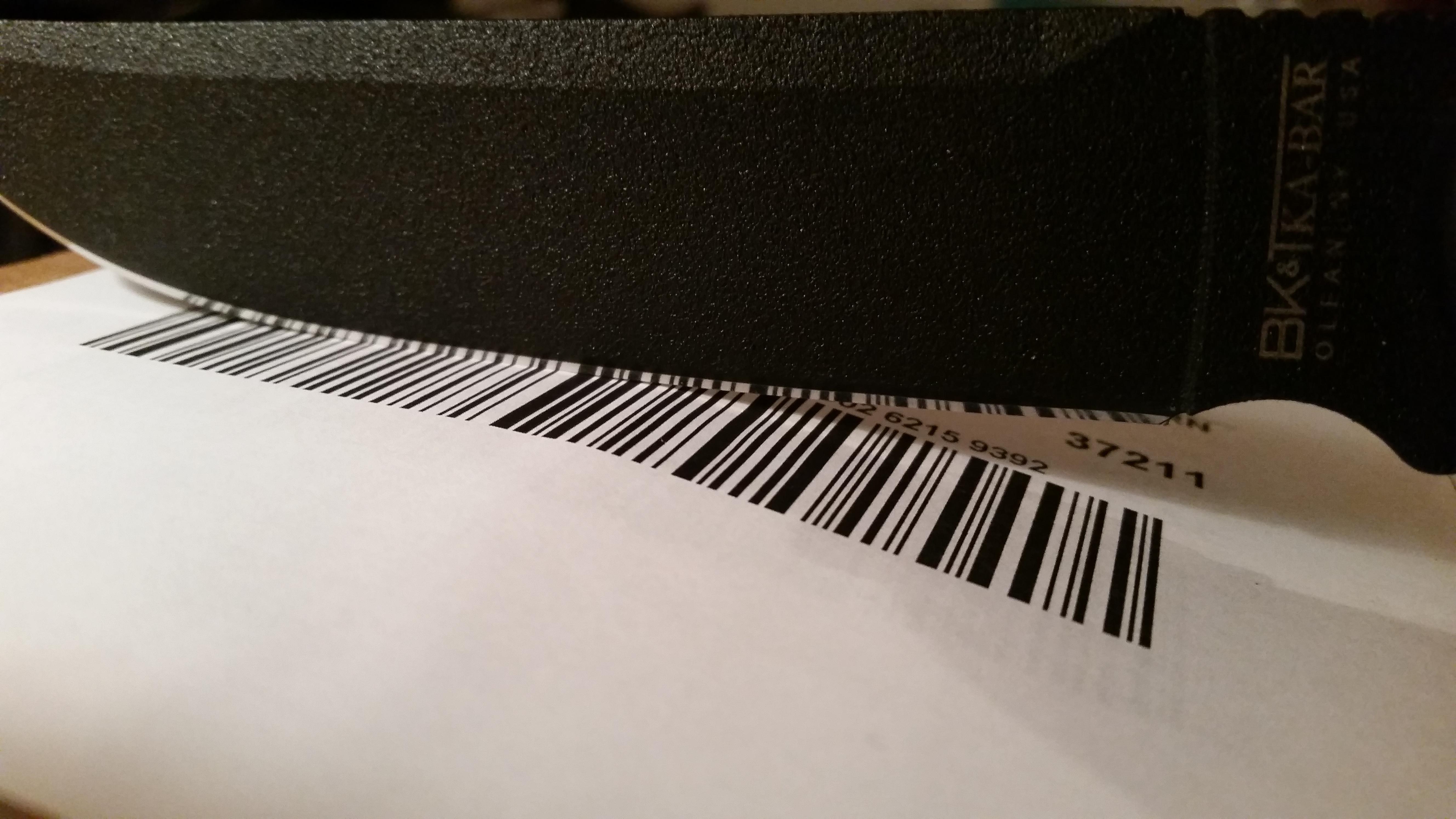

Thanks bud, and honestly didn't take long at all maybe about 30minutes per blade on the 1095 and around an hour on the s30v. I used the wskt blade grinder and a progression of new and used belts.^ yeah bobby, I imagine that took a while doing a mirrored polish to those large fixed blades!! looks great!
Perfect sense, a much better and more informative way of writing what I was thinking [emoji106]Well the basic principle when it comes to cutting is that thinner cuts better. So Ideally we want the edge, the grind, and the stock thickness all to work together optimally and be as thin as possible while still holding up for the hardest task we will ever use it for.
Polished edges work best with push cutting (i.e. picking one point on the edge and pushing that part of the edge through what you are cutting, so in other words, no drawing). So if you have a thick polished edge it will not only wedge when cutting through something, it just lacks the overall initial "piercing" of the apex. So that's why on a thicker edge especially I recommend a toothier edge so you have some slicing aggression so it can work more like a saw if you need it to to get through something (because the thinness is lacking).
Hope this makes sense![]()
One more. My favorite EDC.
Looks great! S30v or s90v?
How difficult is s90v to polish? Without the aide of a guided system?Thanks for the kind words. It's s30v. I like the looks of the 940-1 but I hear s90v is a bear!
Yea it's not easy at all I discoveredVery near to impossible from what I been hearing but I don't have any first hand experience , Josh at Razor edge does my my edges really nicely, my S30V and 204P are beyond razor sharp.![]()
Fresh x65, worn x65, fresh x22, worn x22, fresh x4, worn x4, 12k grit belt, a worn 12k grit belt with Emory compound applied, followed up with stropping on green compound and finished with stropping on flitz on a paint stick.
I just picked up some linen belts with .5 and .1 micron compound I need to try.
I prefer a polished bevel with a somewhat toothy micro bevel on my outdoor knifes, I feel it helps prevent drag when carving while still having bite.
The bk2 is 34° inclusive, The bk16 is 30° inclusive with 34° micro bevel, and that Bushcrafter is 40° inclusive per its owner request, mine is 30° inclusive with 36° micro bevel.
