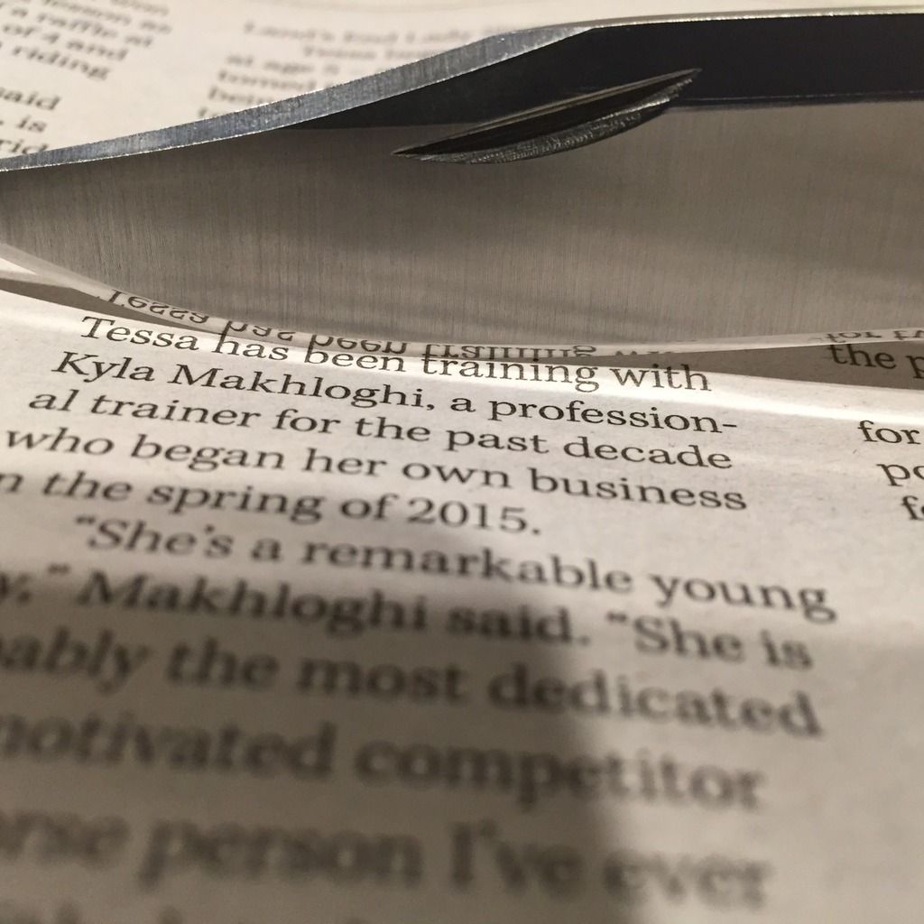

Finally worked up the nerve to put a new edge on my CKF Morrf :o It came with a 25º secondary. I took it down to 20º with NO micro. Cuts like a red-hot razor blade. Making me re-think (always) adding a micro. It's thin & flat ground so I know that enhances its cutting ability...but geeeez, this thing is now an unbelievably sharp slicer. Probably the sharpest knife I own now. Virtually silent & almost no resistance doing S-cuts through phonebook paper. I might do some comparison cut tests between this & my Rockstead Higo. The difference in the Morrf post sharpening is that noticeable.
**Josh (@ razor-edge-knives)...and any other seasoned sharpeners, if you see this post with all this said, do you feel I'd receive any meaningful benefit by adding a 25º micro? (It's just a light use edc for me.)

Thanks chopsaki. I'm relieved it came out well. I was more nervous on this one than any other knife I've sharpened. I'm a hobbyist at sharpening and I really didn't want to mess this one up, such a pretty knife (IMHO).

S35VN is similar to S30V, perhaps slightly better in edge retention so keep us posted, that's a sweet looking blade and the edge is just pure knife porn. Great job!

Hey Scrim great job!!! looks amazing! The way I see the advantages for microbevels are:
- It allows you to take an edge lower than you normally otherwise would. I will be pushing my Elmax ZT down to 8-10 dps this way, and then adding a micro at 15 for apex stability. You want to go as thin/low of an angle as possible w/ out compromising the strength/toughness of the edge to a noticeable degree. So ideally one would profile the edge to a lower and lower degree until, under magnification, they notice chips, denting, or edge rolling at which point they will begin to strengthen the edge w/ a microbevel that goes further into the edge than the damage that took place. Hope this makes sense, I will probably do a video on it at some point, but Cliff Stamp has one of the best videos about fine tuning the blade geometry for your intended uses (see below).
- It allows for very very quick touch ups at the micro-bevel degree, with only one "sit down" major reprofiling every so often.
Personally I think 20 dps is overkill for most knives and steels, you can likely take it much lower than that and then micro at 20° =)
