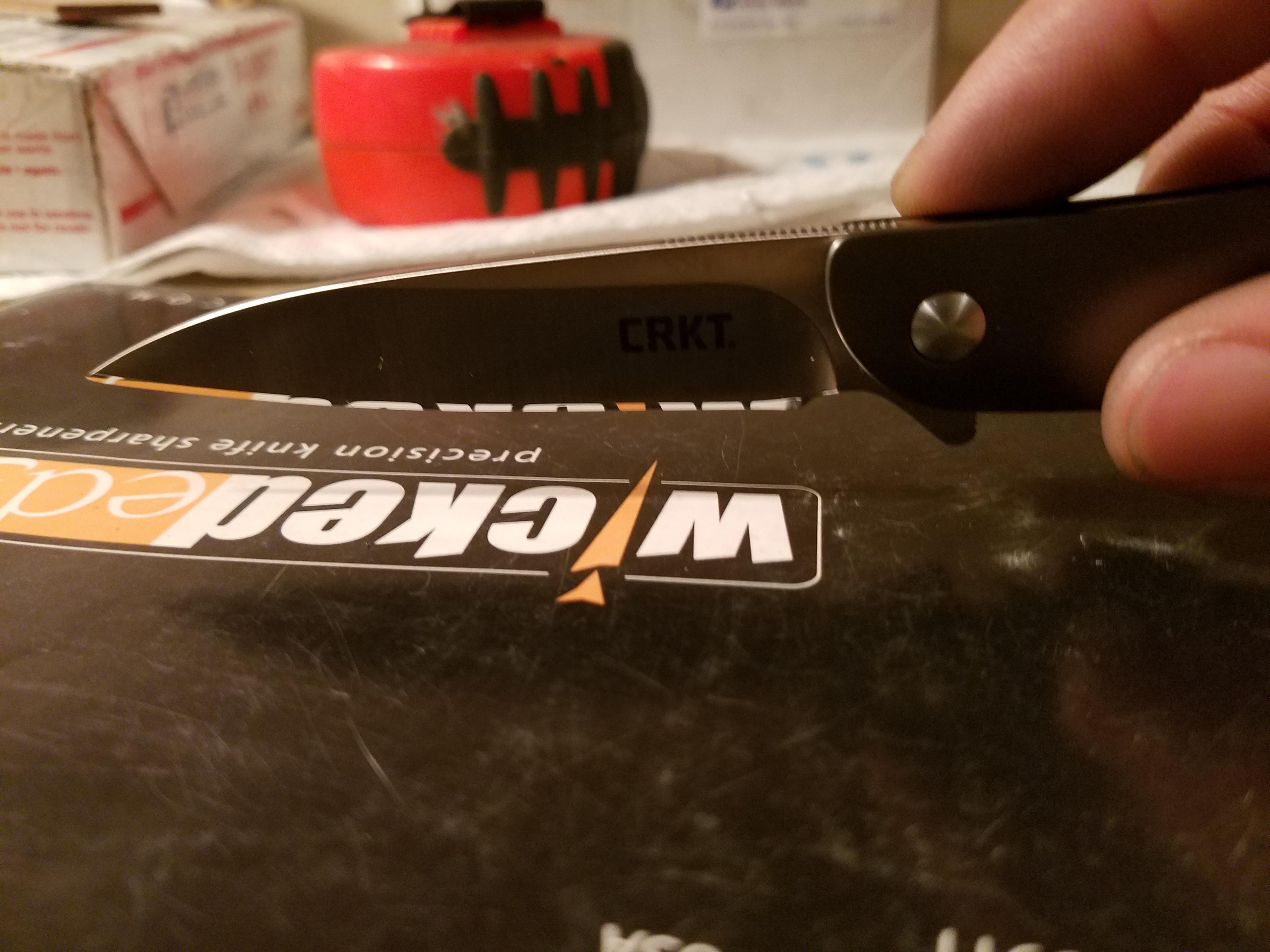

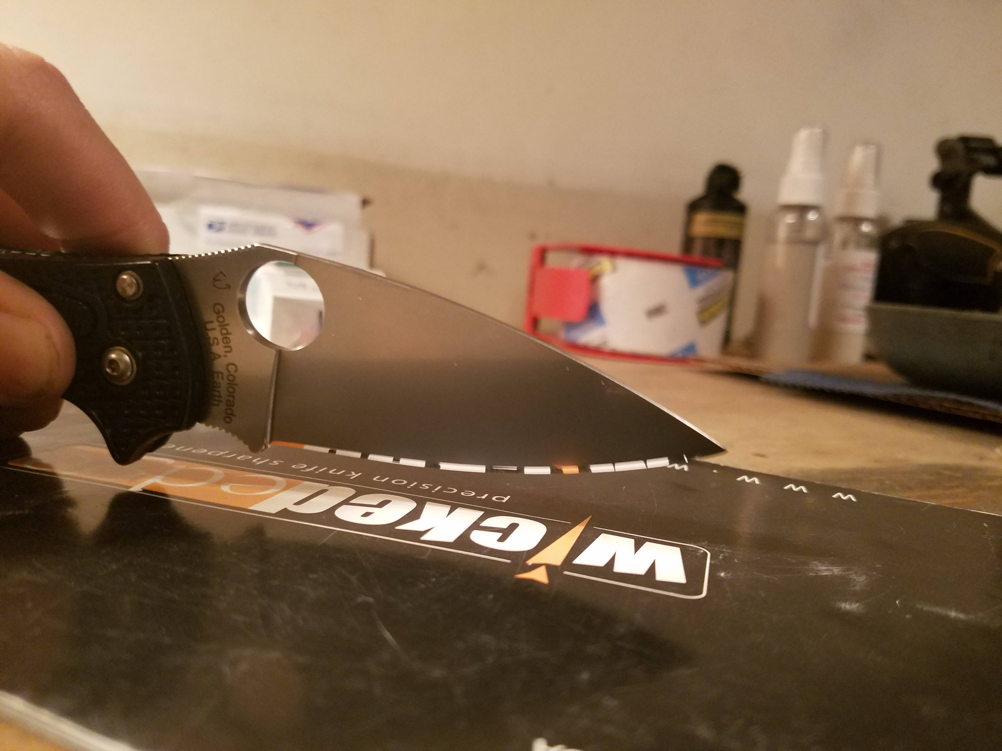

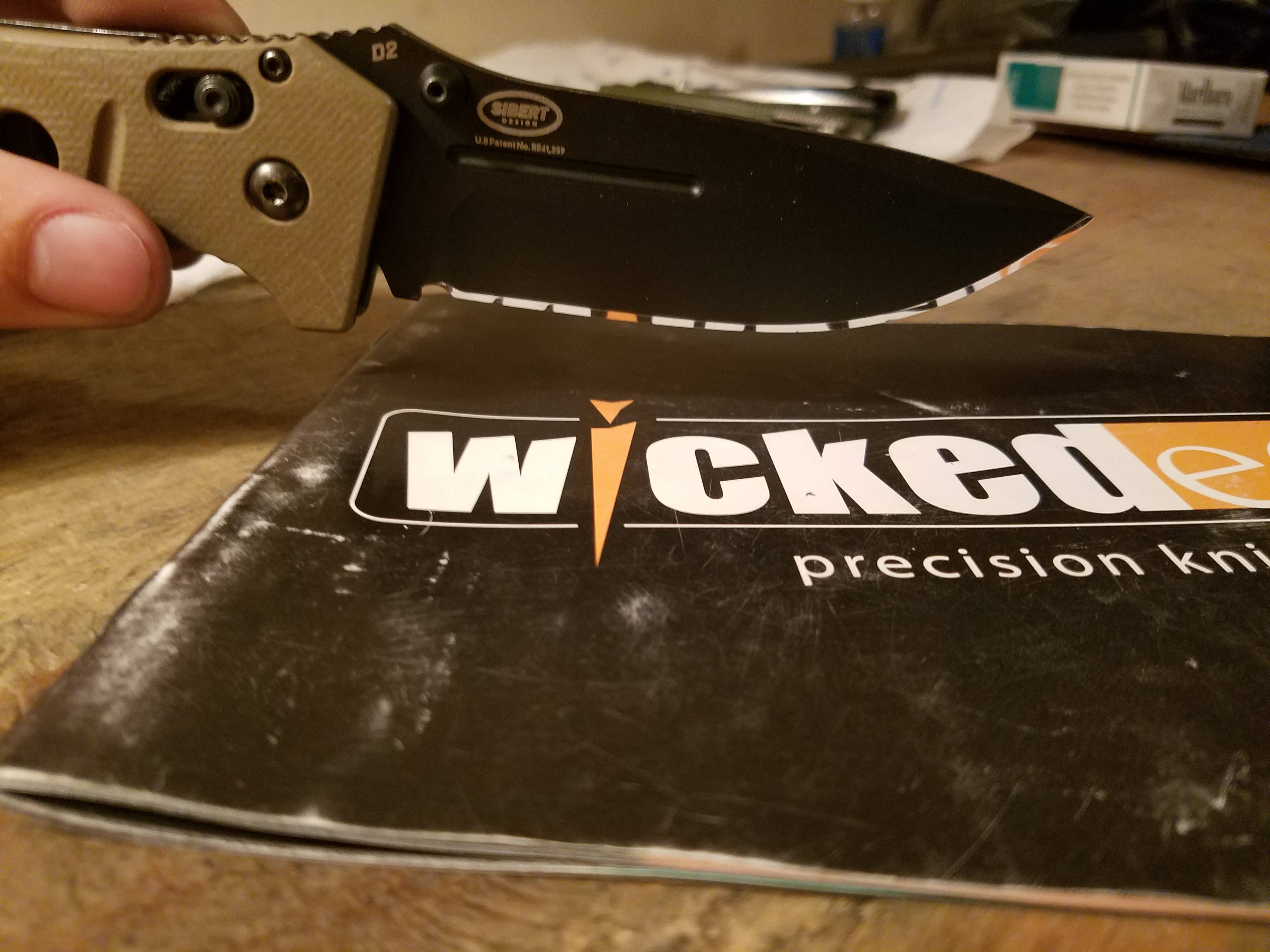

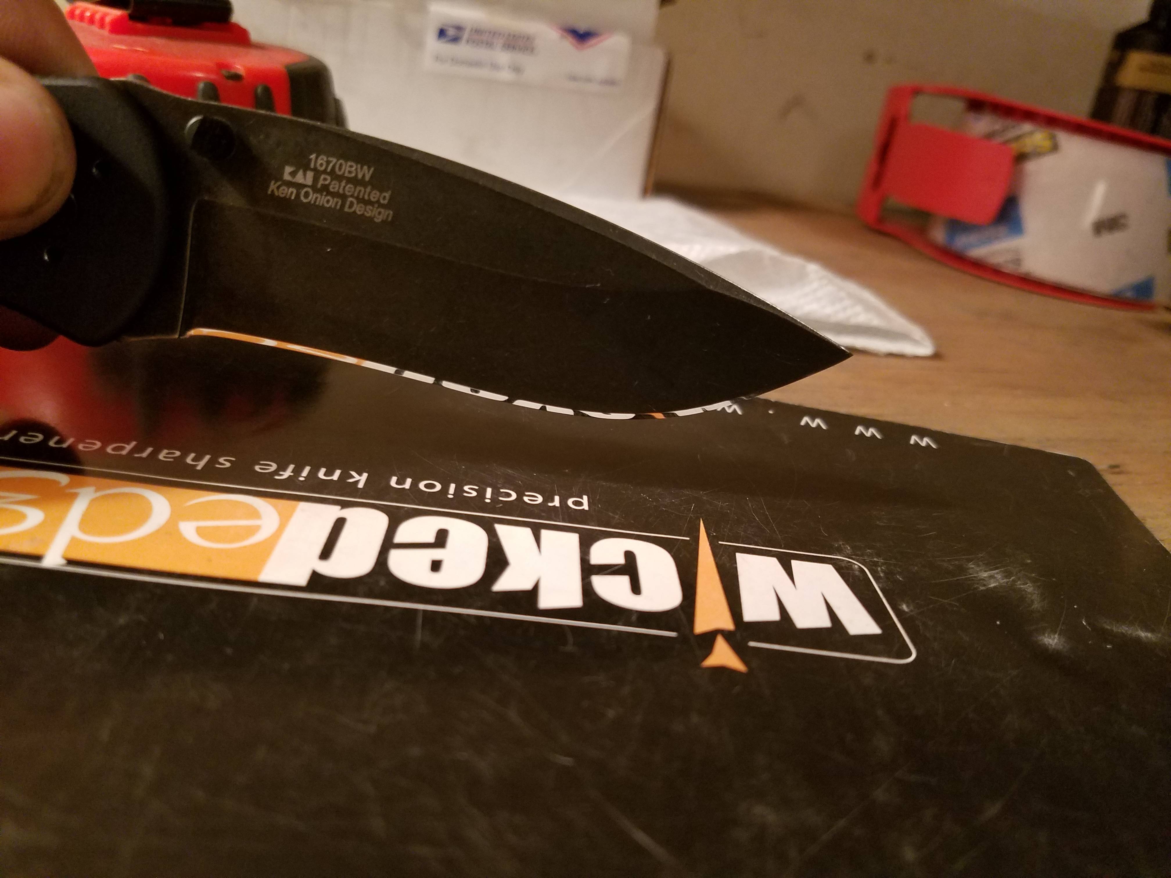

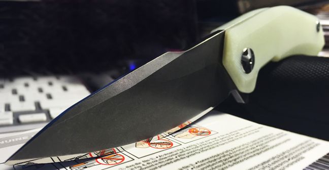

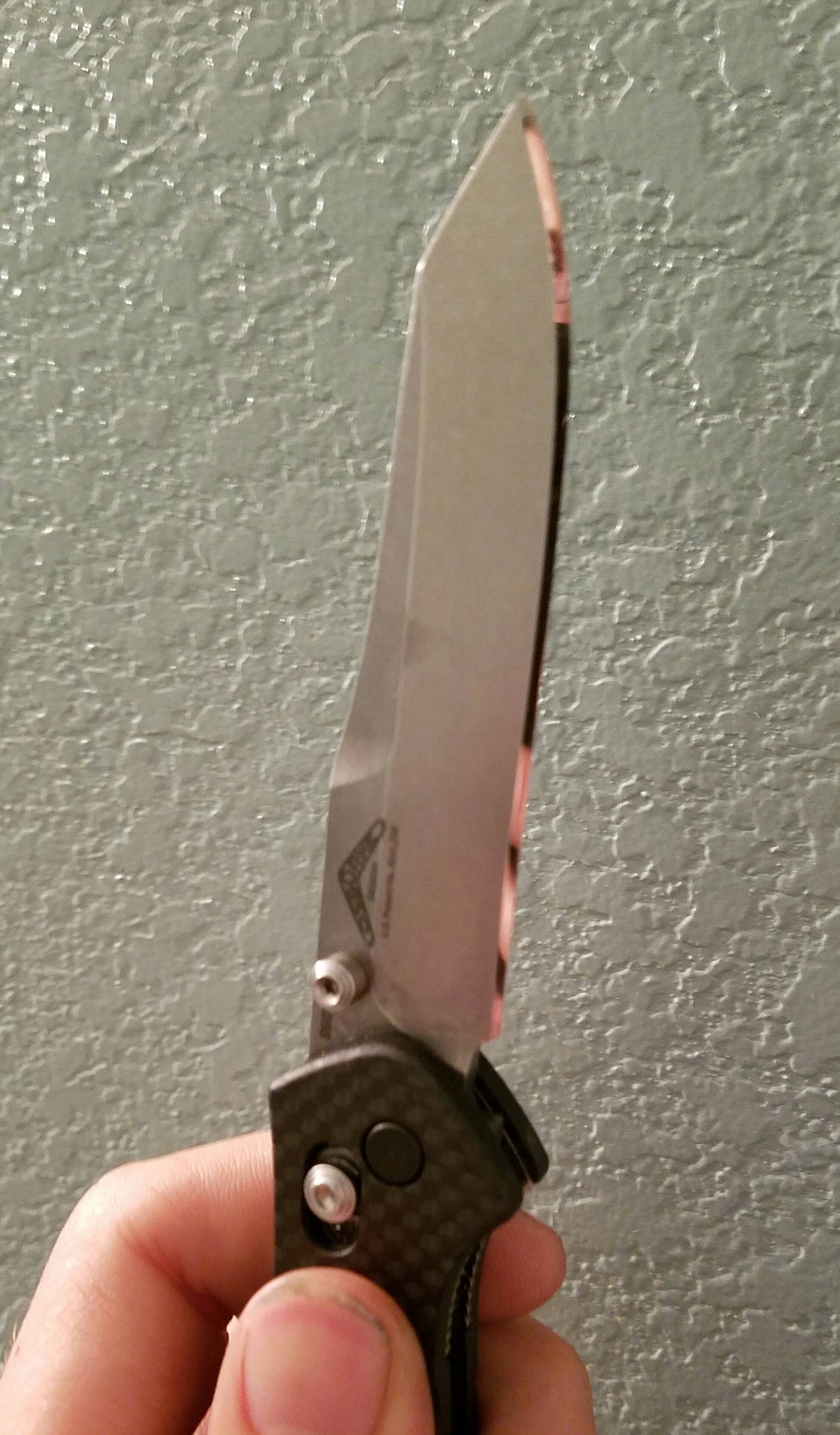

Super polished edges
Dang man your good real good
still a work in progress as that was 400 grit sandpaper still have 600 and 1500 then buffing but it's pretty polished already

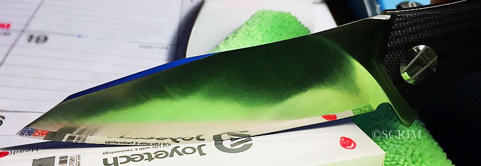

Recently upgraded from Lansky to Edge Pro Apex. 15º secondary. So insanely sharp (as is) I passed on adding a micro. If it ain't broke, don't fix it.:D

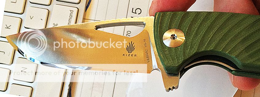

Kizer Kyre: I experimented on this one. It's not the prettiest result I've gotten...but...I always wanted to try for a very acute angle/broad bevel...on one of my knives, mainly because I think it looks great on certain knives. The insane slicing ability achieved is a huge bonus, of course. The Kyre has a very thin, (very nice slicer) VG10, high flat ground blade, so I decided I'd shoot for a 13º secondary. I could never get that low an angle with my Lansky so this was an opportunity to try it on my new Edge Pro. This may be the sharpest I've been able to achieve yet, so I again decided not to mess with this edge by putting a micro on it. Really liking the Edge Pro...and I'm just beginning to get cosmetically acceptable results while still getting an insanely sharp apex. Definitely a learning curve with this system. Still got a long way to go. Maybe more stropping required.

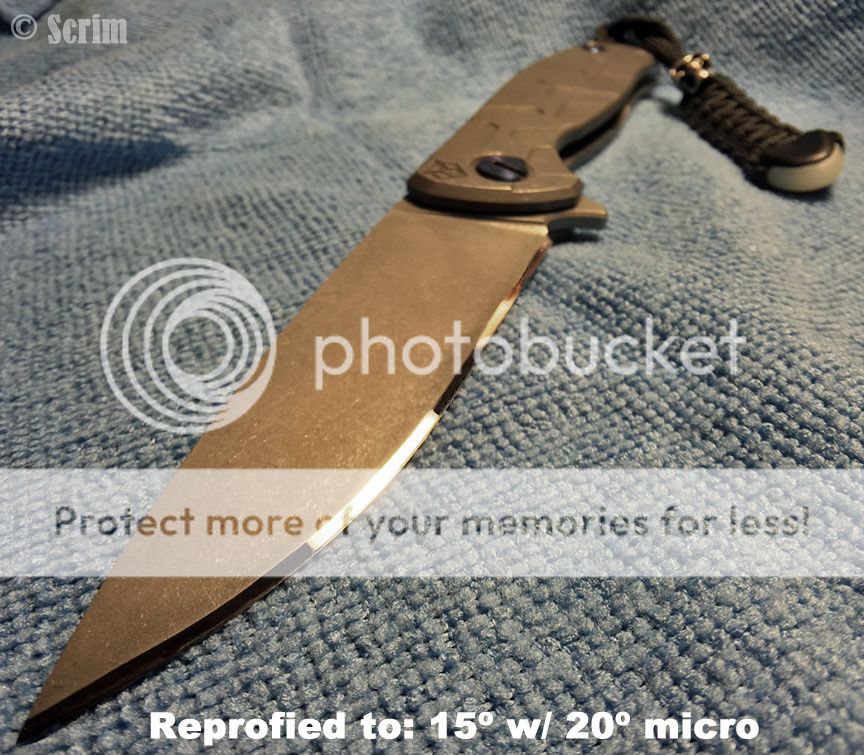

Went for it on this one too, 13º, no micro, sharpest one yet. 4.25 inch cutting edge, yikes! Silent thru phonebook paper from any angle, S curves, push cutting, the whole thing. But still experimenting with really low angles, just because I finally can...

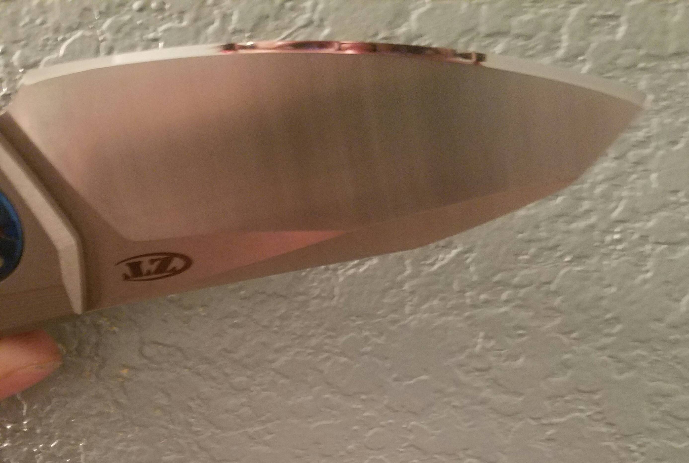

I'm super curious about that 12dps edge bevel on that PM2. I recently got one of the BHQ CPM-M4 dealer exclusives and measured my freehand reprofiling of the edge bevels at ~8-9 degrees per side, but my edge bevels appear to be a similar width to your 12dps PM2. I wonder if they ended up running the CPM-M4 blades thinner behind the edge?
My edge bevels measure ~0.070" wide and the edge bevel is ~0.020" at the shoulder, so math says ~8 dps:
Not much of a mirror polish, but I don't really bother anymore since I got into coarse particulate abrasive stropping. I'm posting this purely to compare the edge bevel width to that 12 dps s30v PM2.
