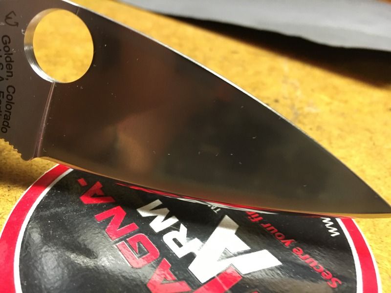

First picture in post #2 - why the square area marked with sharpie on the clamping area?
The marked area is where the Tormek clamp held the blade while reprofiling it on that machine.
That clamp has an a-symmetric build, so i reclamped the blade precisely when switching sides.
Outlining with a black marker is very helpful with that.

I'm bad at holding the knife and taking a pic, came out better then my pics show. This is an M4 Para2 at 12.5 dps. Finished with Edgepro's new 4K polishing stone not tape.
ah cool - makes sense now.
Thanks for the explanation. I thought it was some setup procedure you were doing with the Wicked Edge.
