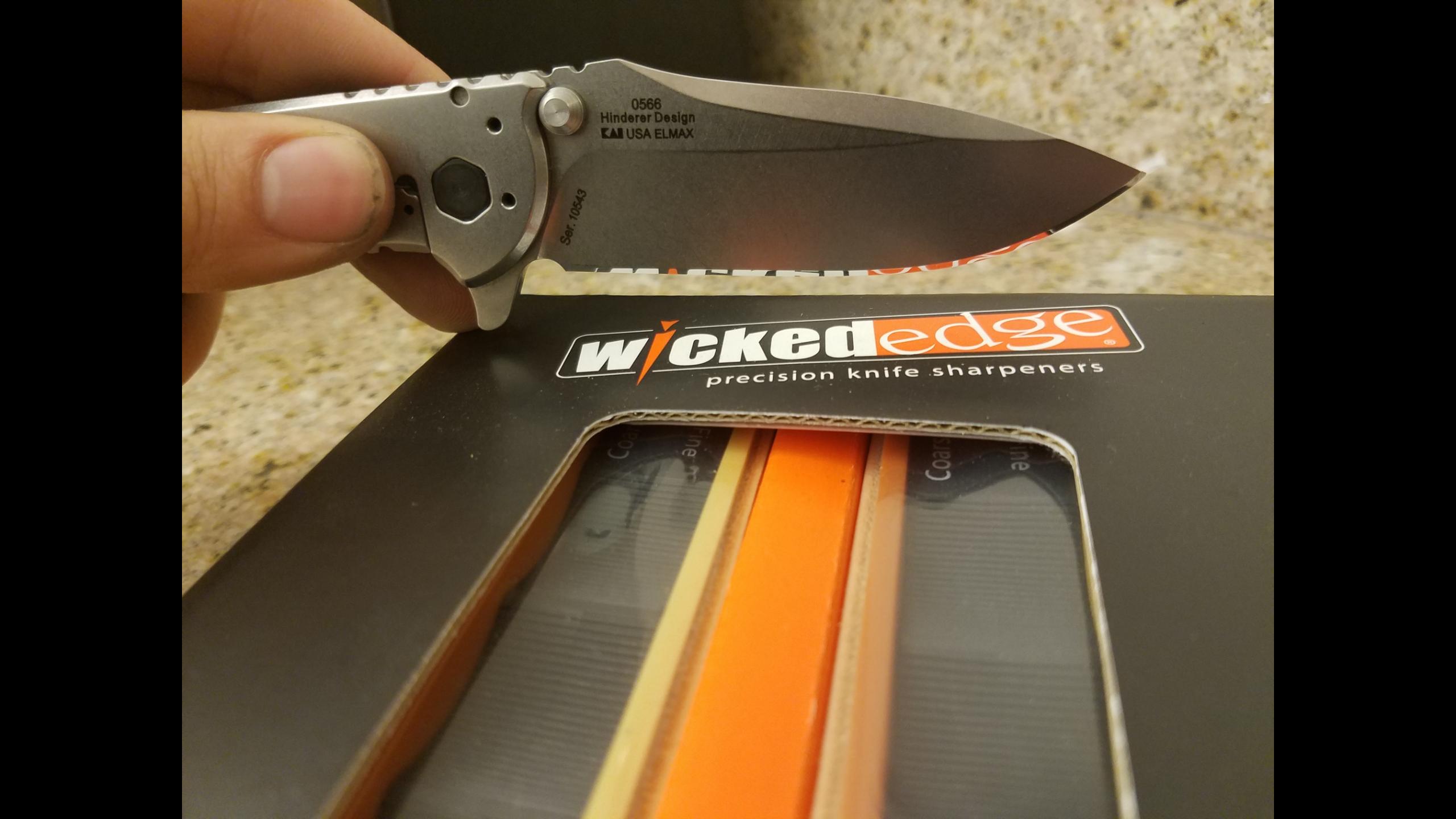

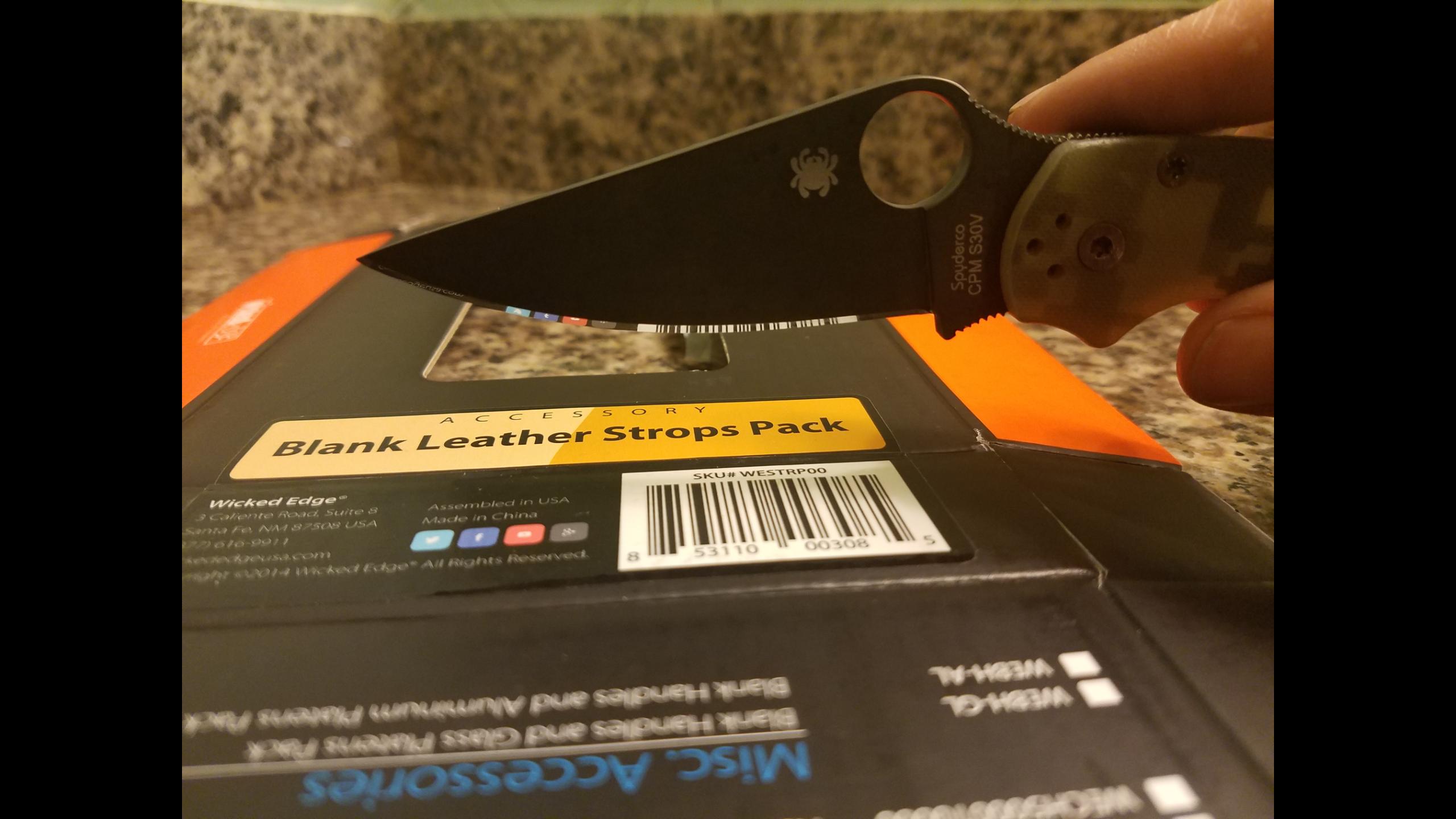

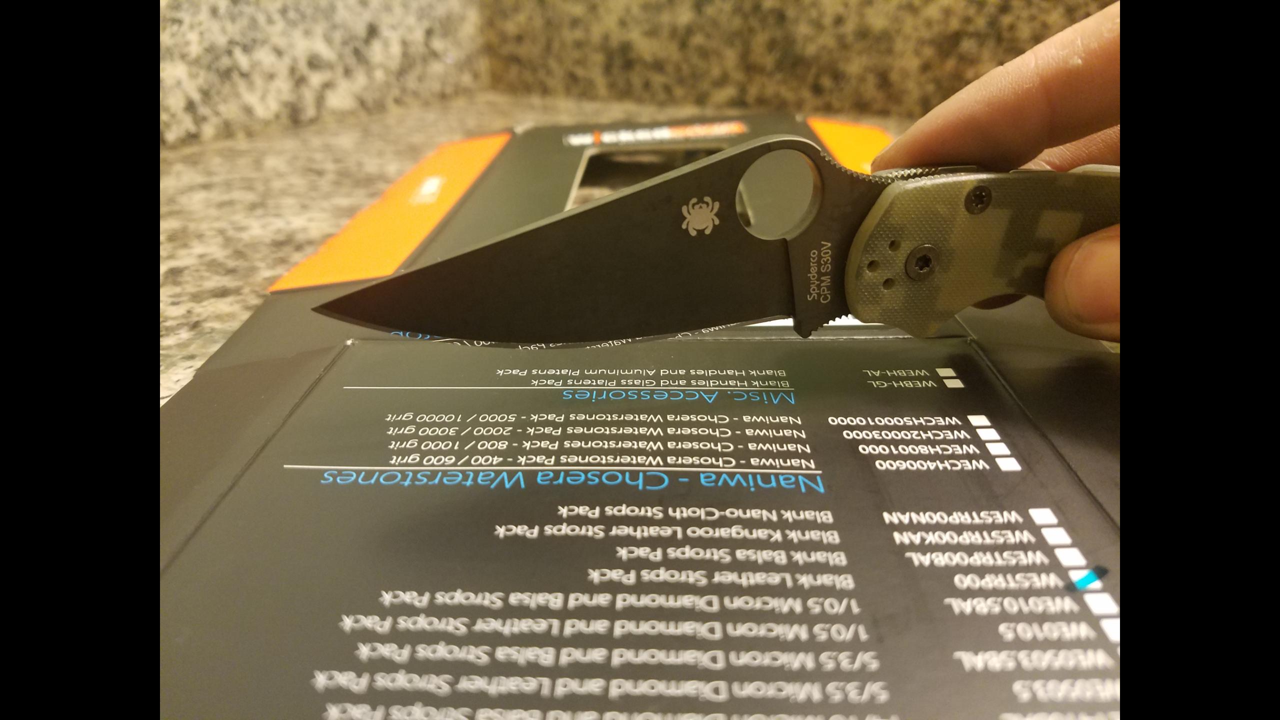

Finished this up today.. at 16 dps. Won't be doing one of these Vallottons at this angle again, this took FOREVER. The edge angle at the tip is literally 3/16" wide or so looking at it from the side view. Majorly needs a regrind at the tip for sure! lol. But it turned out great and is whittling hairs.
Made a gorgeous knife...gorgeous-er! I thought about doing my Vallotten. Now I think I'll just live with the factory edge. Thanks for the warning! But boy does that look sweet.
Lol i sharpened one of those awhile back and my buddy wanted me do 15° per side like I'm always putting on my knives..i told him wasn't happening took it to 20°
Very nice job thou.

Nice! Bet that took a while! Free hand or guided?
Looks good. Just wondering, is there a reason that the knife setup couldn't be adjusted to take less off in the tip area?
Hey Curtis. Well the way I had it mounted already increased the angle at the tip slightly. I was limited in mounting options w/ the gen 3 vise, more so than the gen 2 (couldn't tilt as much, and limited gripping area) and I had it 'maxed out' as far as straight mounting in the vise. But to answer your question, yes I could have lessened the tip metal removal by using a different mounting option but I wanted this pretty close to 16 dps along the whole length of the edge. The tip is just ridiculously thick on this one so it just never would have cut as well otherwise, and now it can be fully maintained on the sharpmaker =)
