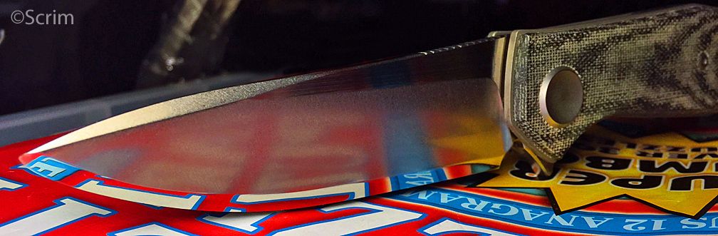

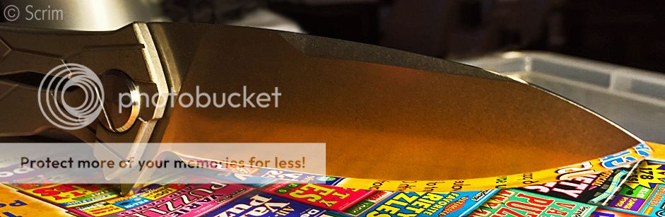

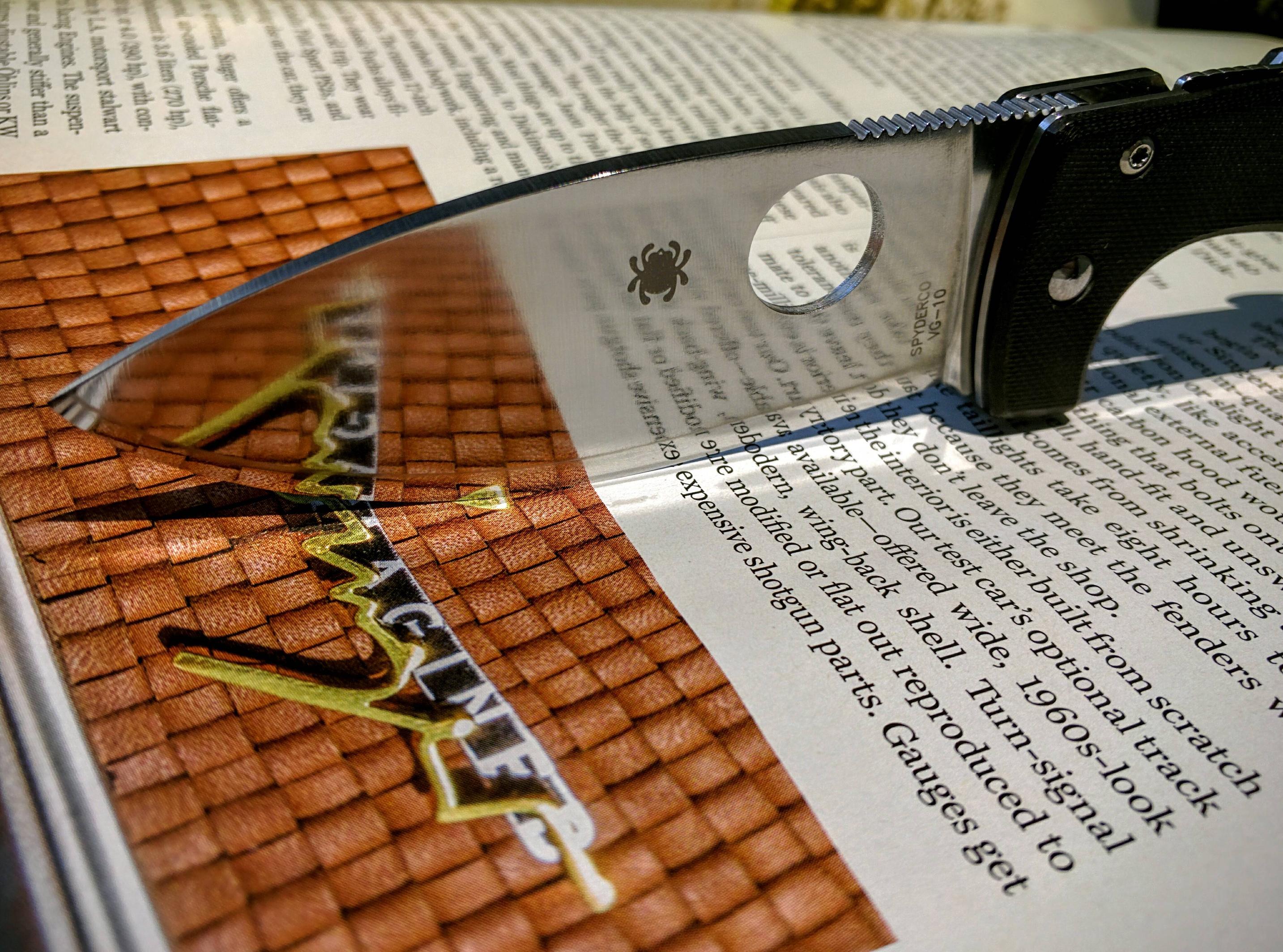

Super polished edges
Cry me a river Josh! How about an edge bevel that is ~3/16" wide for most of the blade length?
Thankfully I only did that ONCE on that knife, and it was done freehand so it didn't take my entire natural life.
lol NICE work man! Bet it cuts like a demon too =)
The LC took about an hour on the Edge Pro with Shapton glass stones: 320, 500, 1000, 4000, 6000. Id like the 8k and 16k.
turned out great!!! yeah the 16k is sweet! straight razor level!

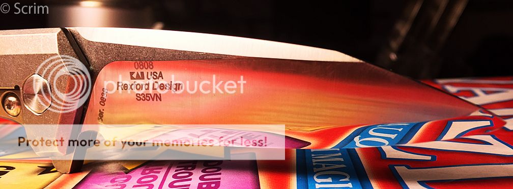

Thanks Nfd538. Just ordered a Chosera 10K hoping that'll give me what I'm looking for. But I am liking the Shapton 8K I recently got. Just used it again (in progression) on my beater ZT 808. I wanted to try to put a mega bevel on it...so I took 12º on the EP for a test drive...
I got the EP kit Shapton 320, 500, 1000, 4000 and 6000 those stones put some nice edges on knives.
It feels reeeaaally scary (like surgical scalpel) sharp. No micro added. Try it. It took a while but I'm sure glad I did it. :D PS. I did use the EP small knife attachment to help with the low angle. To be honest, I'm curious to see how the S35VN will hold up on such a thin, acute angle with no micro bevel. But damn is this thing sharp.
I don't have the small blade attachment maybe on a larger knife.
