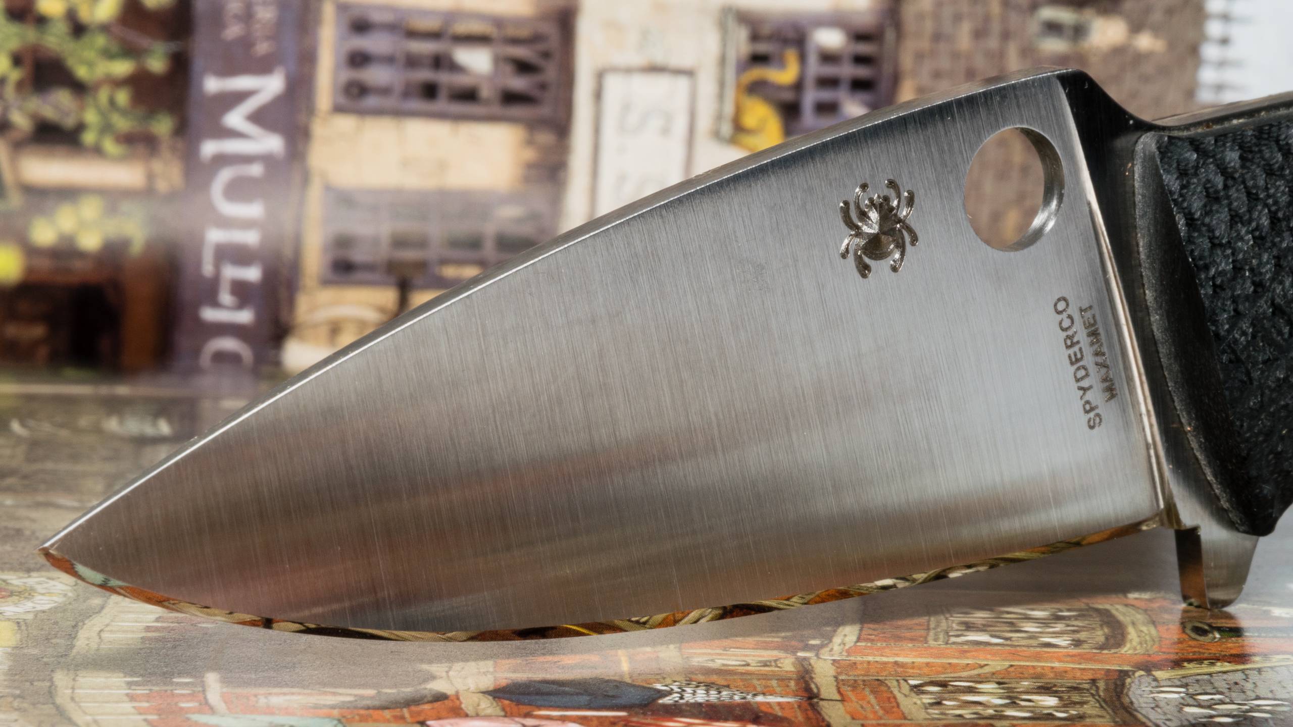

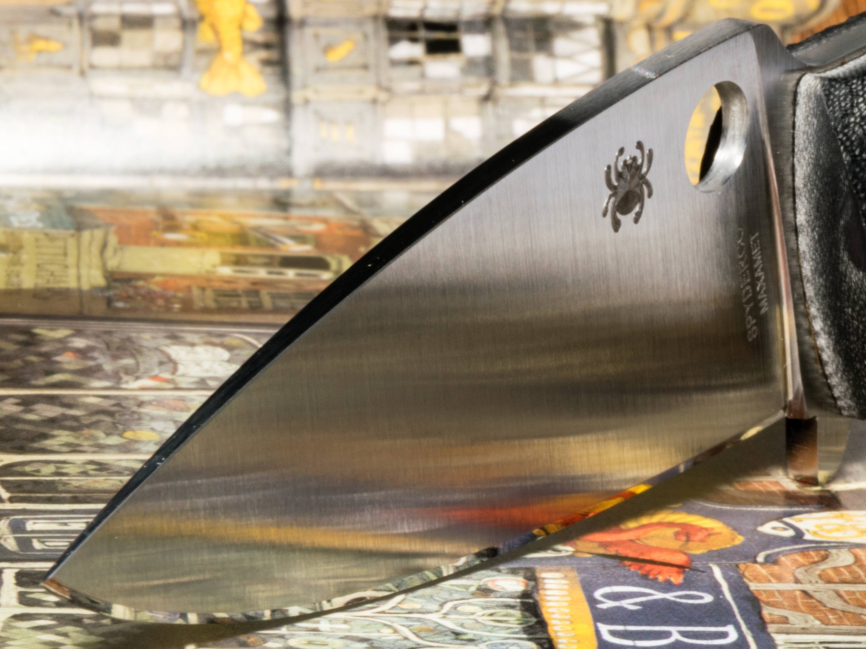

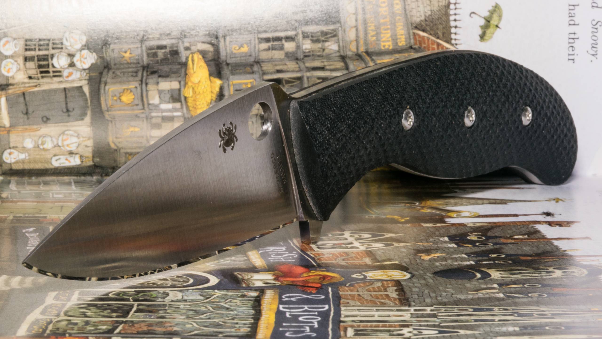

Super polished edges

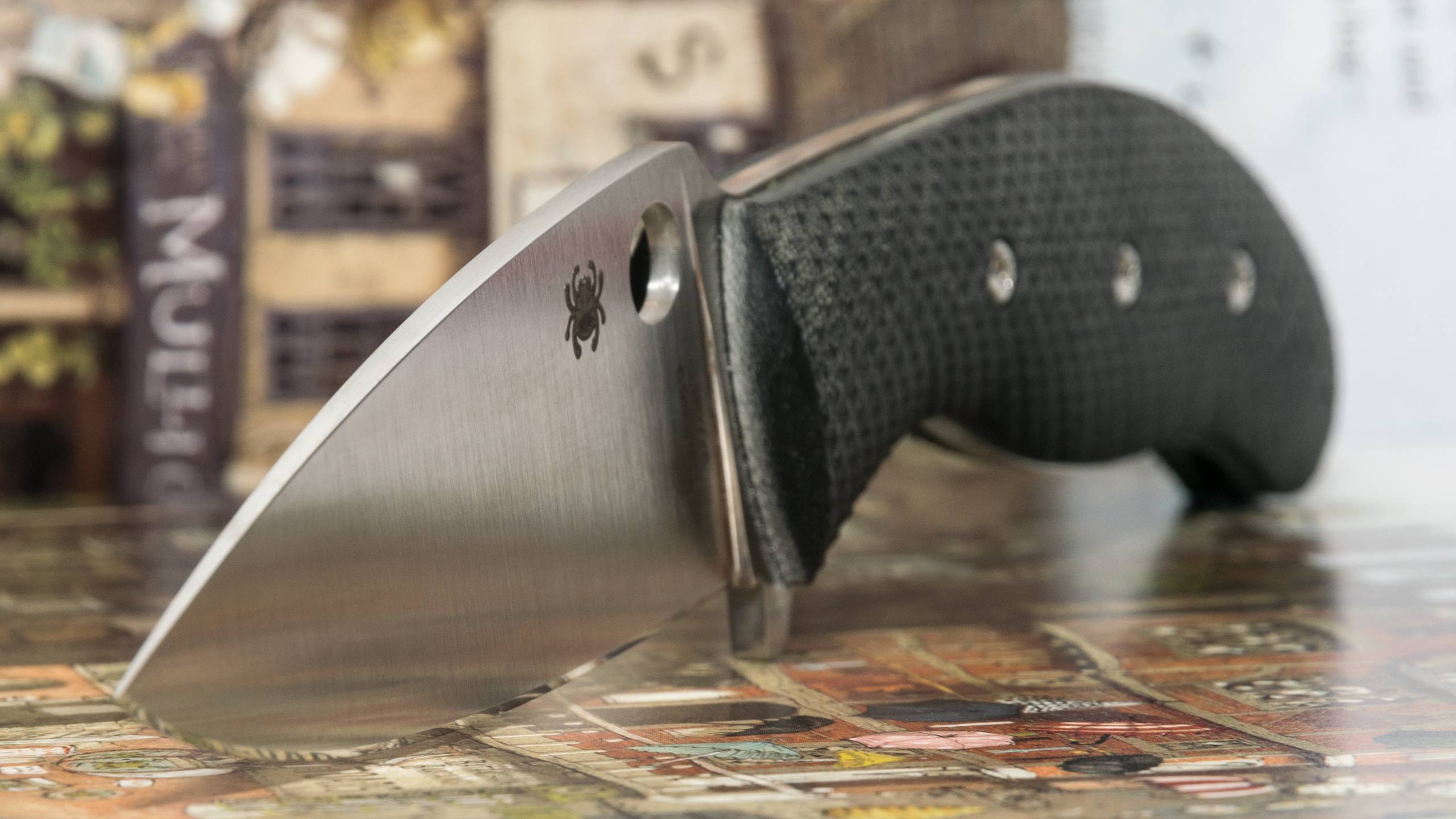

A few more pictures of the Spyderco Maxamet Mule after I did a little stropping on some Mother's Mag & Aluminum Polish on a hanging denim strop on top of the 13,000 grit SPS-II freehand finish. I'm not planning to use the knife this way, so I wasn't concerned about ending up with an overly polished apex with little to no slicing aggression.

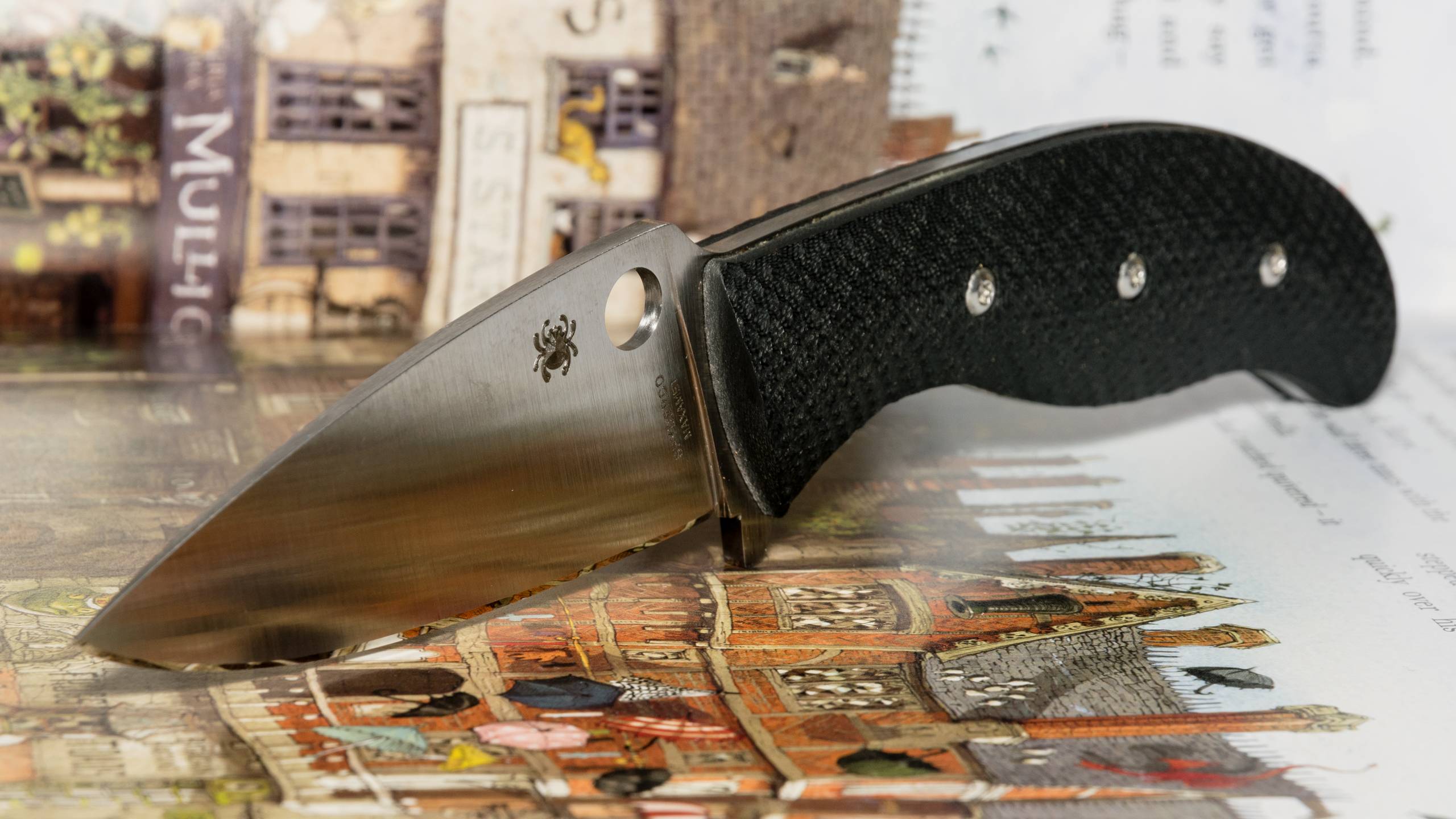

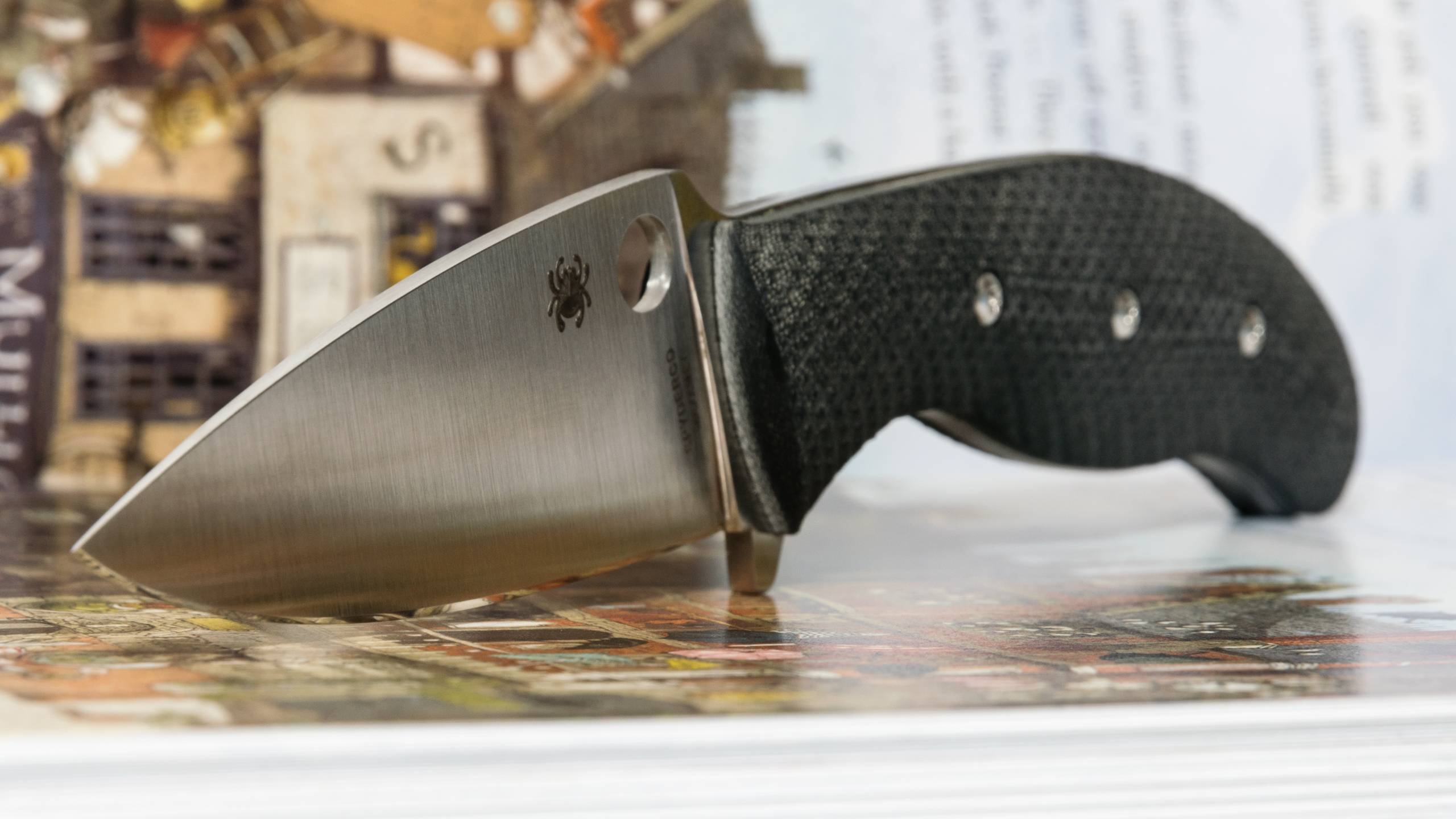

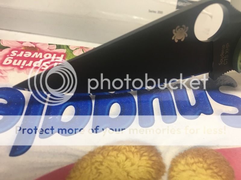

Just did a Spyderco 204p Military. I have sharpened s110v, m4, s90v, and 5200, this felt harder.
Cts204p should be way easier to sharpen than s110v but def s90v...I've done a few in that steel and is on par with m390, 20cv, (basically same steel as those anyway) and 3v...m4 was only slightly more time consuming.

I know, I was very surprised. I'm re profiling a xm-18 m390 right now and it's going much easier. Same steel and removing much more more of it from a much thicker blade , doesn't make sense.

Maybe spyderco are done at a higher hardness

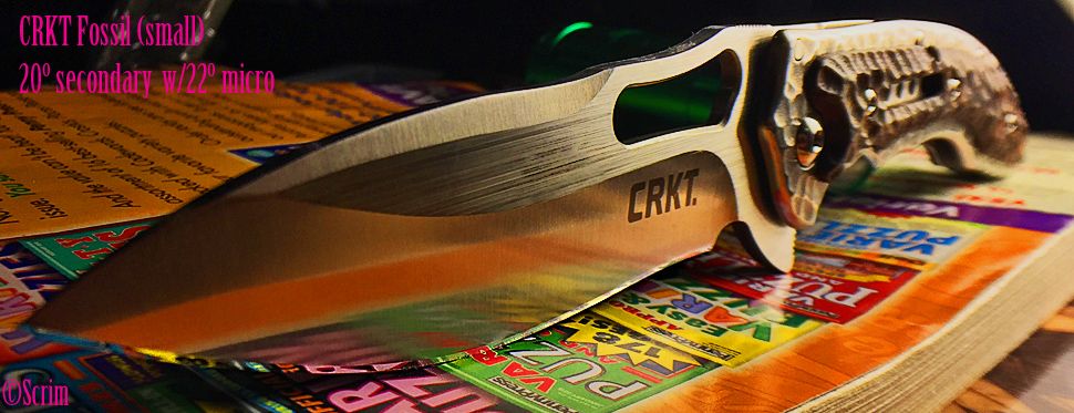

CRKT, w/IKBS, super smooth, detent beautifully dialed in, feels great in hand, great jimping, rock solid, no play, awesome value blade, surprisingly nice all around. 4 oz. Easily takes a crazy sharp edge.:) Knife is as nice as some of my much more expensive mid-techs (minus the supersteel). So nice, I got the "large" Fossile too.

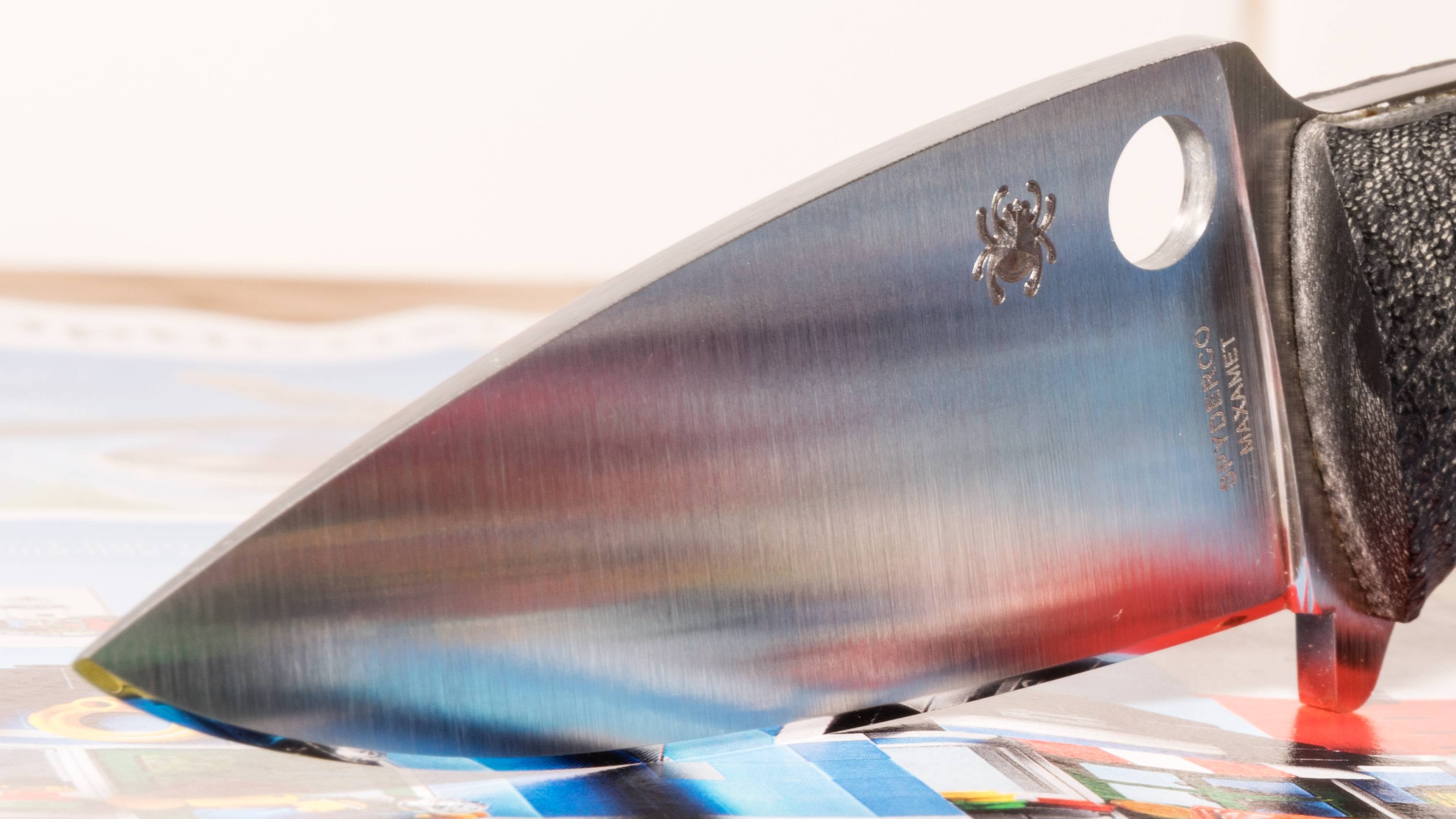

Quite surprisingly, it turns out it is possible to get a pretty good freehand mirror polish on Maxamet at ~68 HRC going from a DMT EEF to a Spyderco M and then a Spyderco UF. I wasn't expecting the Spyderco sintered ceramic stones to work as well as they did, quite frankly.

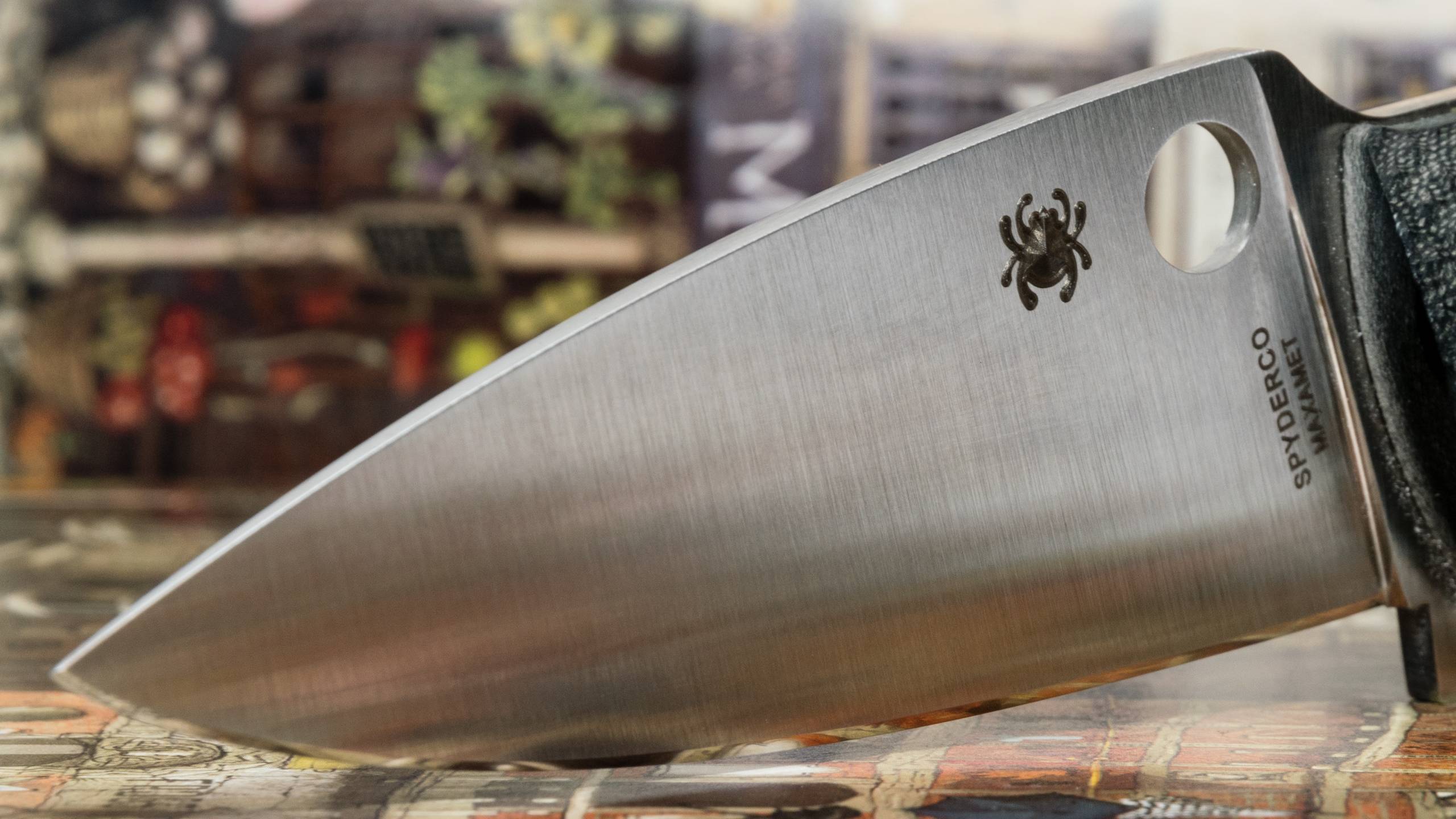

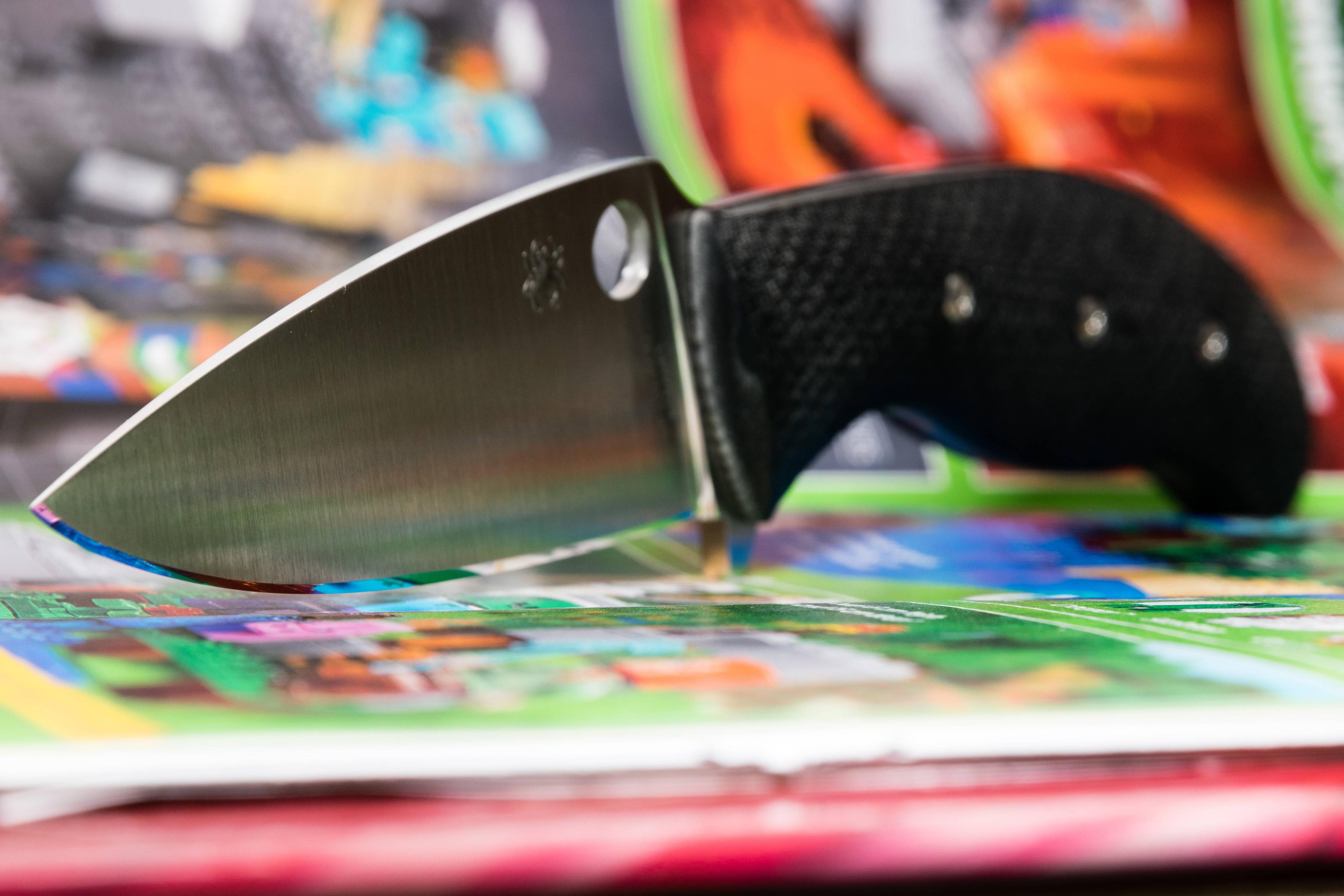

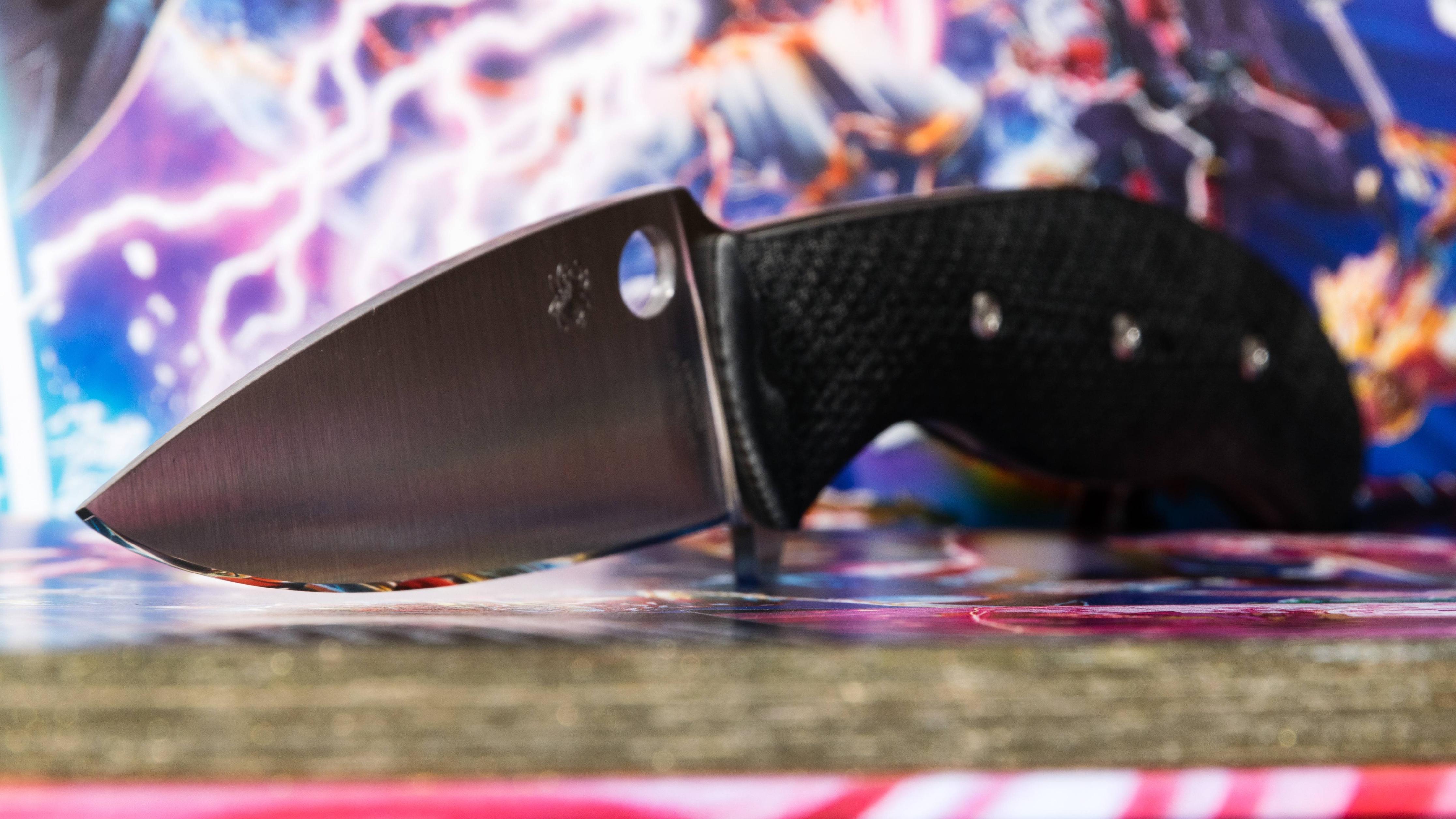

I needed some more microscope images of my Maxamet Mule on some of my higher grit waterstones, so here are some more shots of it with a freehand mirrored edge bevel off a SPS-II 13,000:
