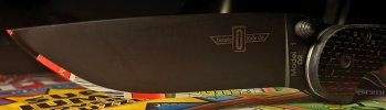

An old Kershaw Barrage (I think). Reset bevel on 125 micron diamond belt, then tuned up on Juuma 800/2000/Suehiro G8 and stropped on Washboard w/stock compound. Not a total mirror, but turned out great esp for the amount of time in.

Diamond belt?! Last I checked on those they were extremely expensive. Nice work :thumbsup:

About the only benefit of a 1x30, excepting the variable speed motor I put on it, everything about it is cheap!
I picked them up specifically for resetting bevels on black coated blades, in place of my Blaze belts. They still leave some feather marks along the shoulder but a lot easier to clean up than the conventional abrasive belts.
